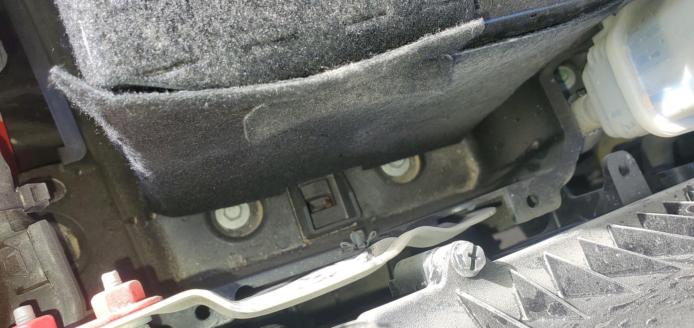

@jti does yours look like this? Front of battery tray.
I am assuming that is the extra space. That spacer might come off in mine I'll find out soon.
