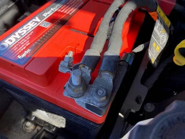

pressman_g
Jul 19, 2020
39
Palos Verdes Estates, Ca
2020 Gladiator Rubicon, 1995 Celica, 2020 R1250R
This is what I did. I left it like this for about 25 mins and still getting the error. Guess I might have to take it to a dealer to reset or figure out what else is off?

jebiruph
Jerry
Dec 9, 2018
806
730
IA
2018 Wrangler JL 2024 Grand Cherokee L WL 2020 Gladiator JT
It looks like your aux battery is still connected, is there power to the dash electronics?

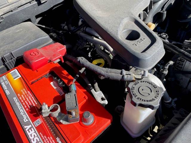

pressman_g
Jul 19, 2020
39
Hmm. ok. So I need to separate the two negative wires from each other to reset the ibs? I thought just disconnecting both of them from the post/ibs would accomplish the reset. Im new at this.

pressman_g
Jul 19, 2020
39
So- i repeated the process and did notice that even with things disconnected like in the below pic- key less door unlocked worked- so the jeep had power. I then separated the two negative wires and everything went dead. Let it sit a few minutes, reconnected everything, and started the jeep. No more ess error code :) I also noticed that the color scheme of the touch screen seems to have reset itself so it seems clear that everything got reset (my radio presets are still there tho).
One last question just for my own knowledge- to remove the ibs from the computer do i just pull the wire off? I didnt notice any snap or lever. I was afraid of breaking it which is why i just went to the 2 negatives instead.
Jeep Gladiator IBS reset and charging batteries battery1
sharpsicle
Apr 29, 2021
2,772
6,272
Tampa, FL / Milwaukee, WI
Yes, in this picture, the aux battery is still providing power. Those two ground cables are 1.) aux and 2.) body, so if they're still connected then the aux is still connected to the body, and therefore still providing power to the system. So this all makes sense.
Glad the code cleared for you.
