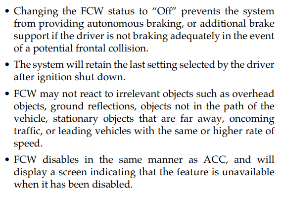

And finally - of course, anyone who has owned a vehicle - a Jeep - with FCW and active braking, knows all about this (if they have any interest in learning or reading)
This has to be possible because they don't know if you are driving through a field with tall corn, or brush or trees or rocks ->
