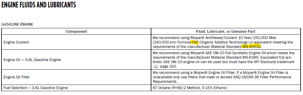

Coolant color is no longer relevant . What matters is that the coolant is:
OAT-formulated and complies with MS.90032 or MS-12106
Please see my post, PEAK Antifreeze + Coolant Equivalent to OEM Original, for a review of PEAK, Prestone, and XEREX
- OAT-compatible will work, but it doesn't meet spec​
- "Formula OAT" = OAT-formulated​
- MS.90032 (concentrate) and MS-12106 (50/50 prediluted) refer to different concentrations of the same base engine coolant​
- As stated in post #3 above, OAT = Organic Acid Technology, and MS = material standard​
