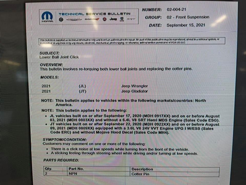

Couple days later it started making a sound on the left bearing. Whenever I turn left and hit a bump I hear a popping sound. Next thing is the handbrake loose and rattling. I’ve already adjusted it and now its fine.

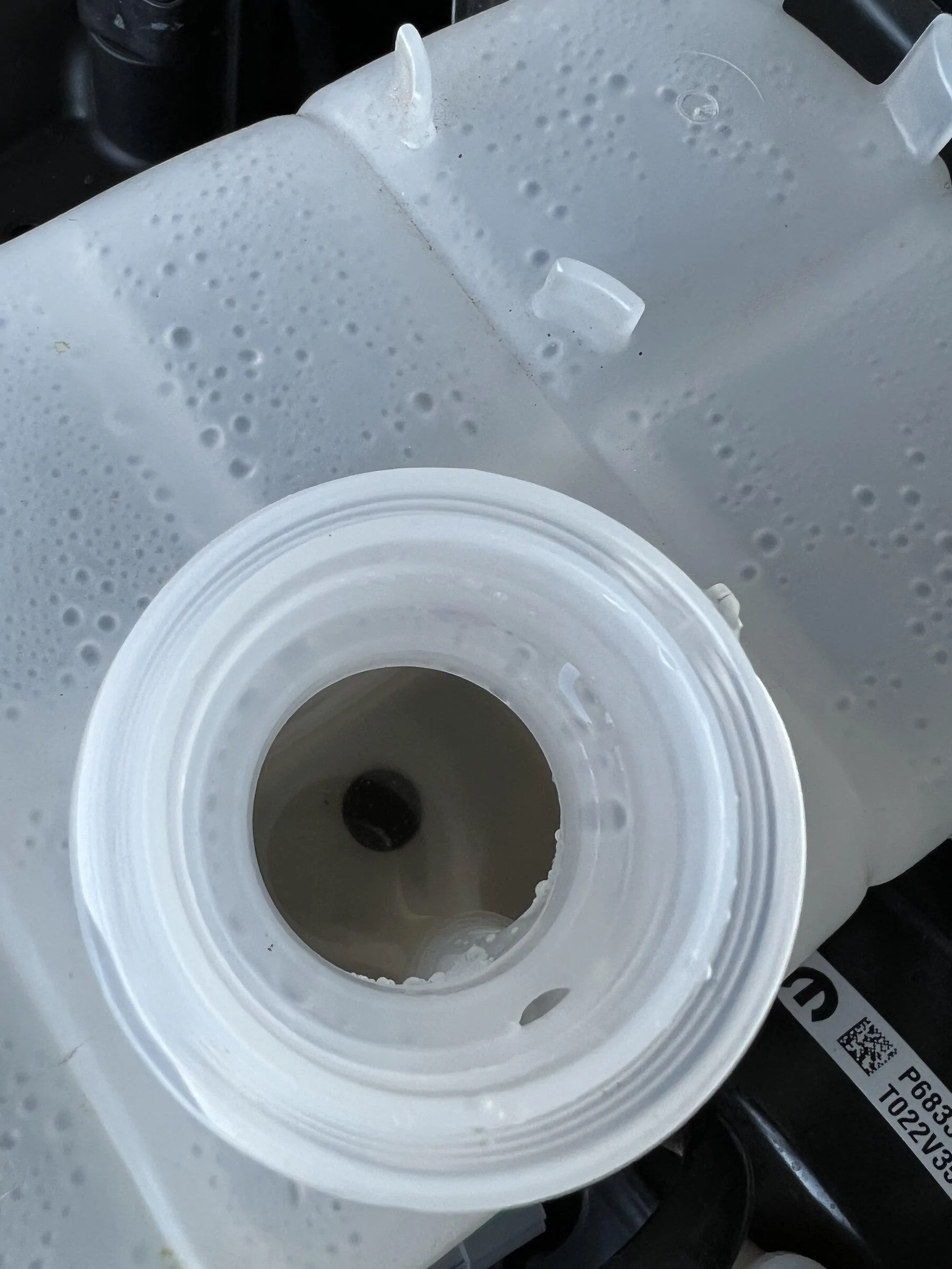

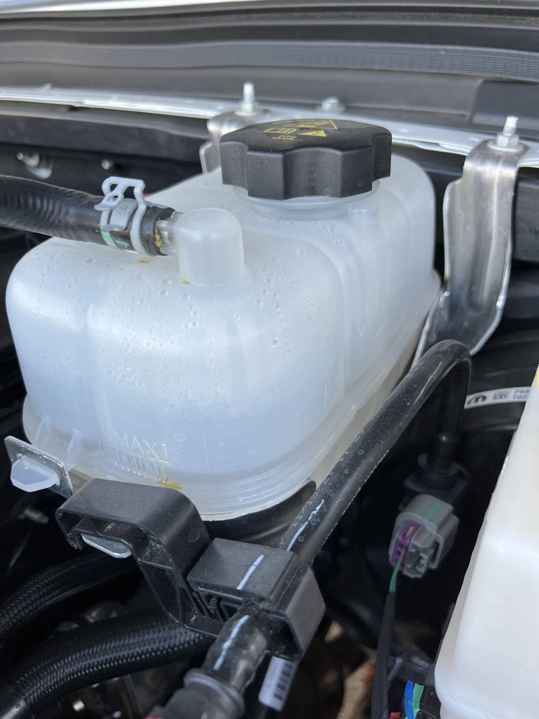

Today in the morning when I pop the hood I come to realize it does NOT come with purple antifreeze but what it seems to be straight up water.
Not only that but also the engine cover is missing!
Hopefully this is not a lemon cause I really don’t wanna go through the headache of it.
Am I b****ing too much?
Has this happened to anyone else?
Looks like water to me. Watch your engine temps and take it in. If it were mine looking like this, I’d do a taste test for sweetness. Spit it out, gargle fresh water. I would know if it was coolant or not or mix. Mine is pink.
Yeah I have already talked to their advisor. I will be bringing it in to have everything checked out

It doesn't even look as though anything but water is in here

I’m not sure it’s still relevant, but just in case folks hear the same thing on their gladiators.
[/QUOTE]
I had similar sounding issue on my 2020 but dealership never noted anything during usual inspections when I pointed it out. It has since mostly gone away at 50k miles (started at 30k miles)
