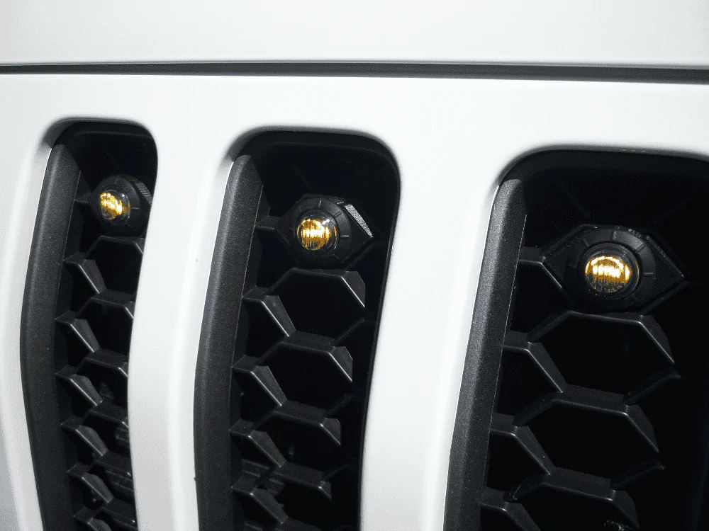

Any idea what this light is?

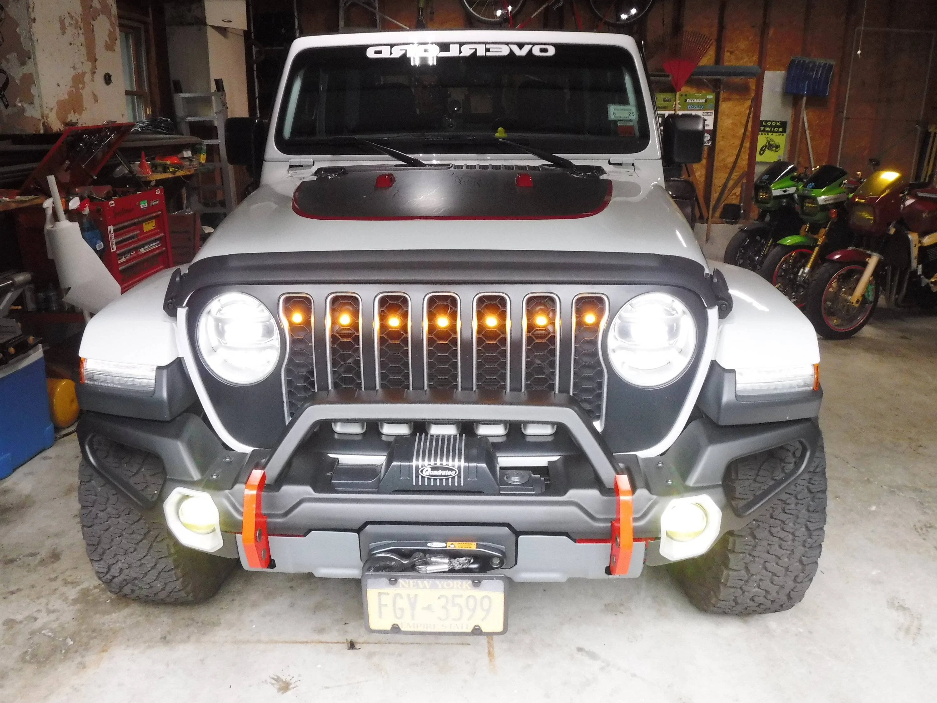

I used this harness I found on Evil Bay. No need to tap into any wires, plug and play.

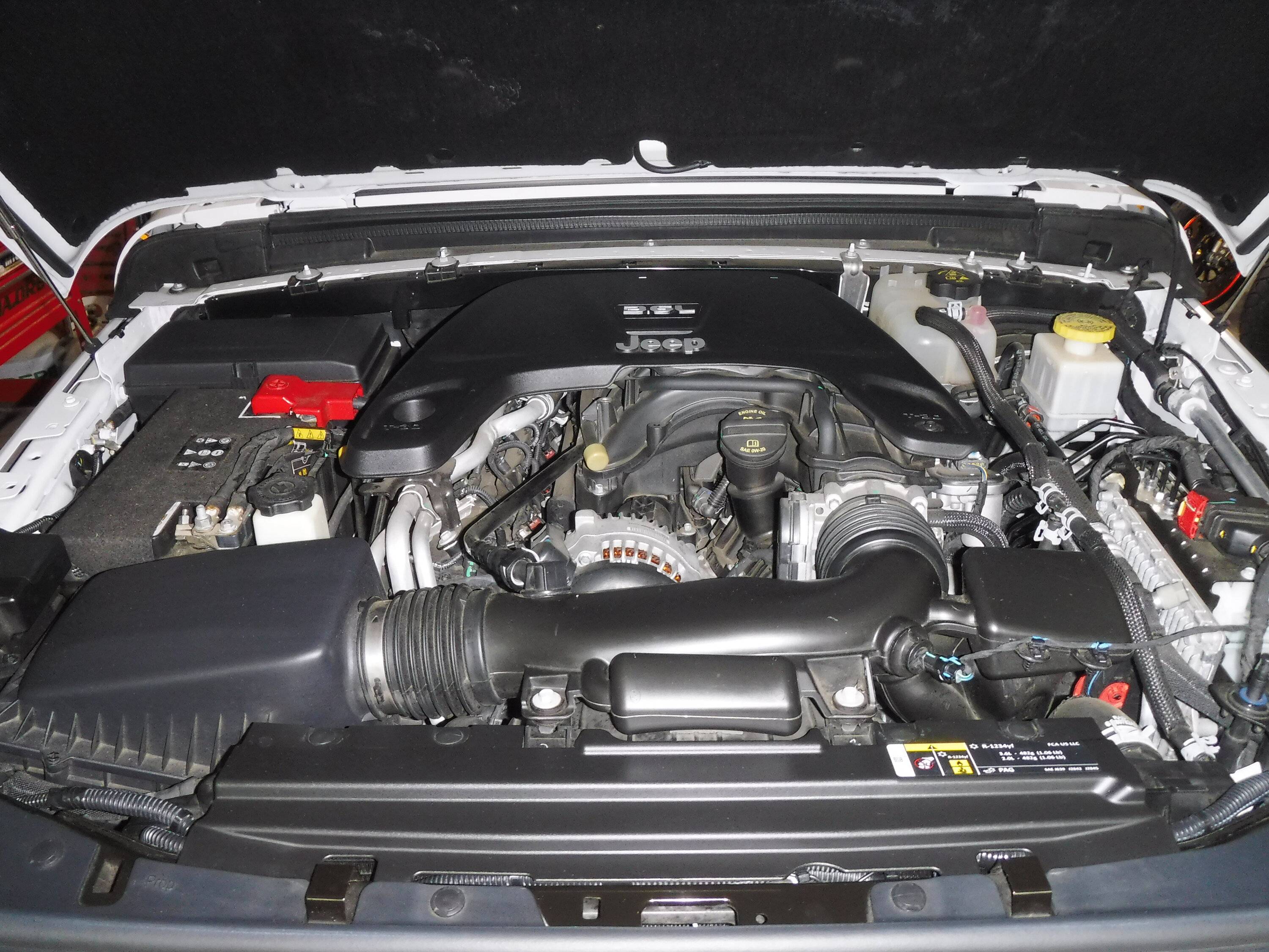

I did order this harness nicely made. This does connect to the factory harness on the left side but it's not up front .The factory harness is mounted on the inner fender body ,If you look under the hood just below the front side of the brake reservoir . This is on the gas version . So you will have to peel back the inner liner quite a bit to get to it the locking tab faces outward so that makes it to hard to get to it from the top. Took me awhile to find it .
I was able to do it from the top, and it was not pleasant, but doable.
One suggestion, cover the pinched nipple on the brake fluid reservoir, if not, it will shred you!
And it did me trying to get it from up top ! LOL

The grill is very easy to remove. Just gently lift the plastic anchor clips on the top, the. Gently pull the bottom forward.
Except for me, the first step would be, remove the winch cables. Doh!
I’m able to do it with them in place, just carefully.
Pulled the plate bewixt the radioator and the radioator support.
Was not pleasant, with my bumper selection and winch, pulling the grill ain't what it used to be, still worth it.
