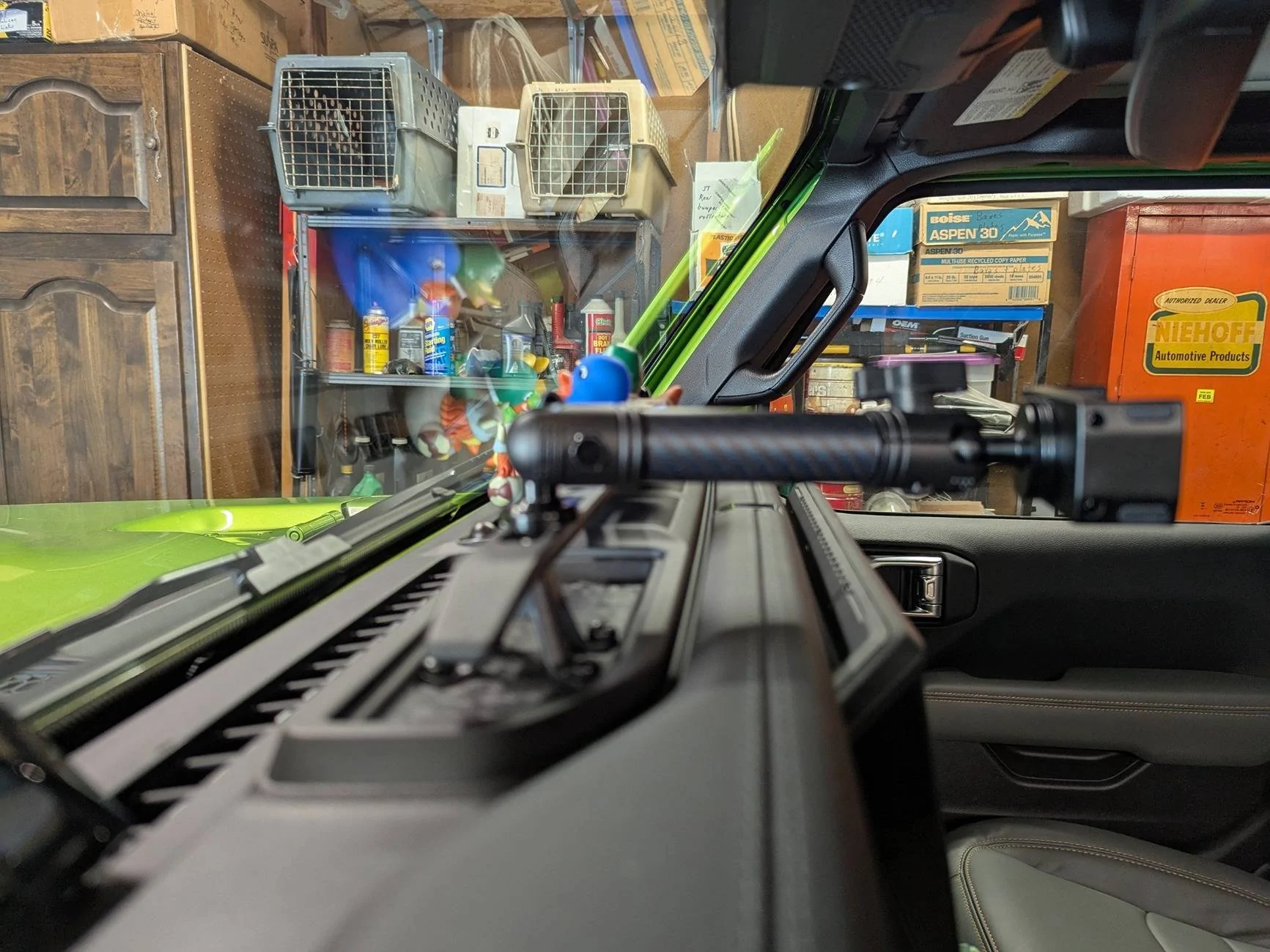

Mine is a BulletPoint 5" center of ball to center of ball.
It's a perfect fit for my uses - clears the dash fine, but doesn't stick out to the point I'll be bumping it.
The rail sits exactly as a BulletPoint single mount ball would sit - centered over those mounting bolt holes so the rail places my phone holder exactly where it was before except now I can have it a bit over to the right, not so close to the steering wheel.

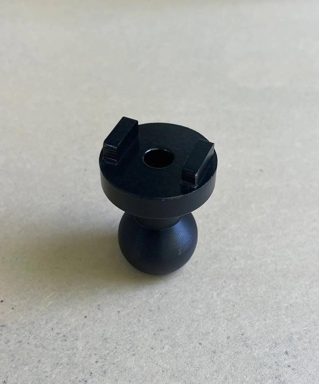

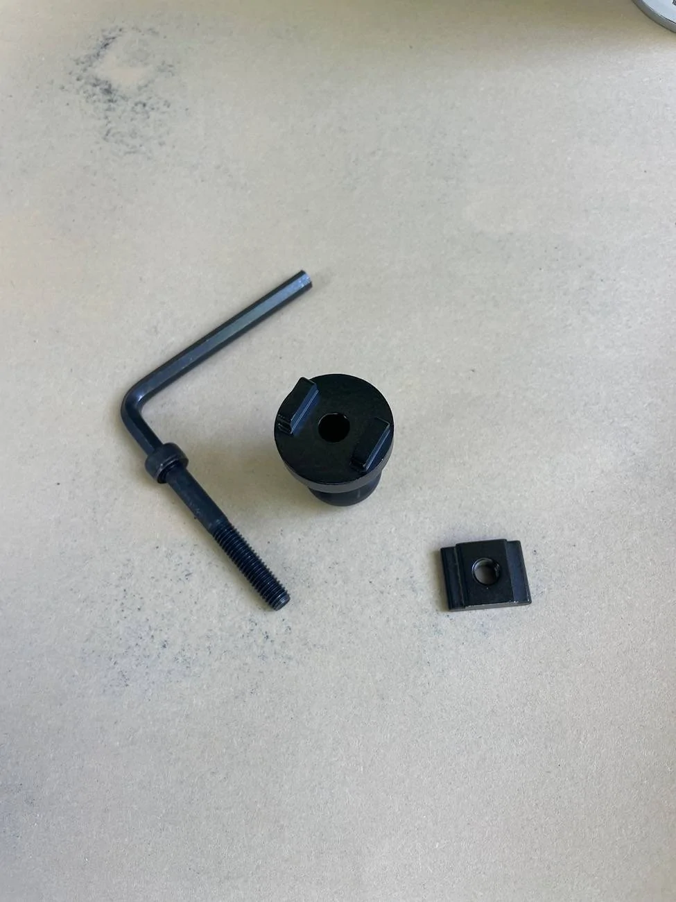

So I bought the Tracform ball mount system. I had to file down the tabs to 0.43” wide by 0.17” high so they fit the slot.
When the paint cures I’ll start assembly.

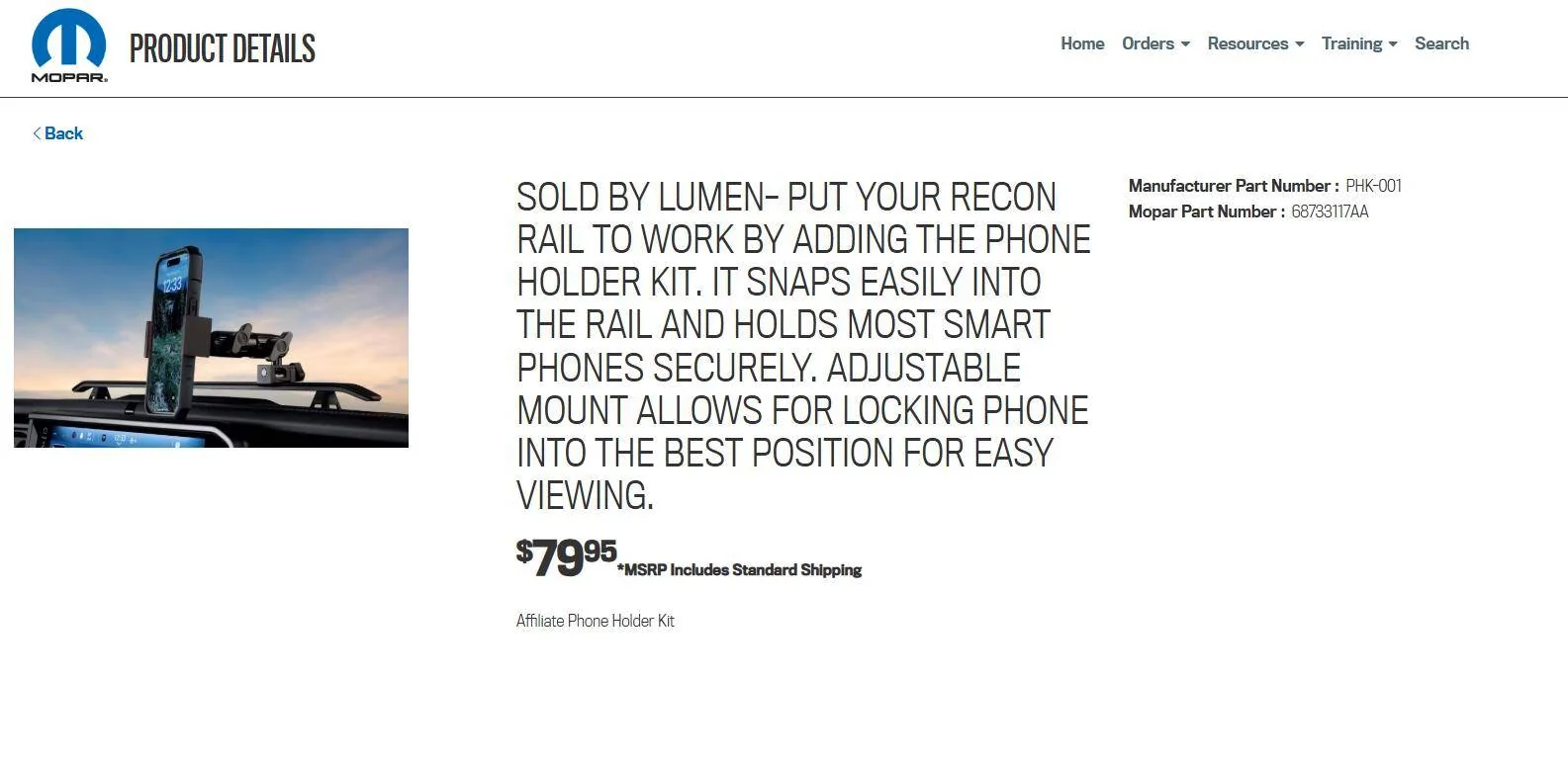

Hello! I just wanted to post here, MOPAR finally released the phone mount for the rail. It has to be ordered via dealer affiliate portal, but I ordered 4. 2 for my JT, 2 for my wife's JL. I ordered this number: 68733117AA
Also, I found this eBay link selling the mount and rail as a kit.
https://www.ebay.com/itm/316166549434

I work for a CDJR dealer, and I ordered my own. It has to be ordered through the affiliate website, like how you source non-OE parts and accessories, that is also our tire website, which I know makes no sense haha. But a CDJR parts or service advisor will know what I'm talking about.
