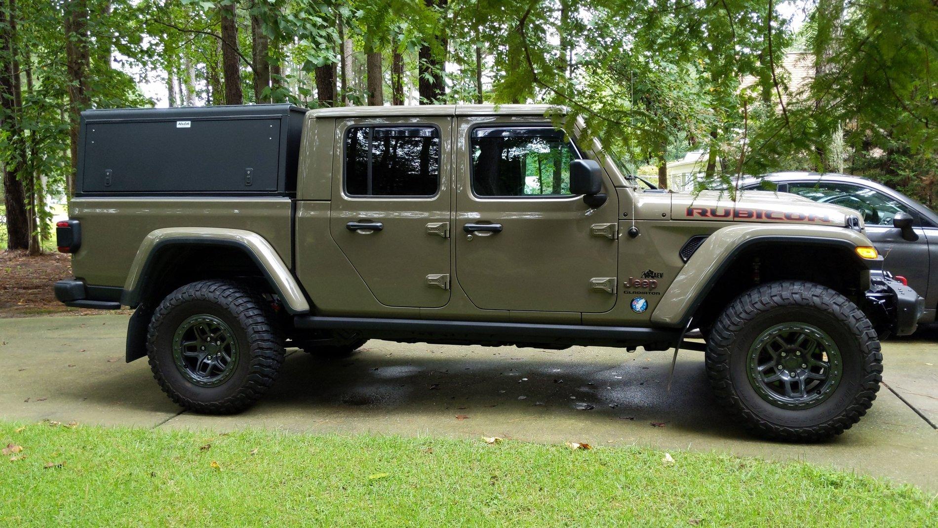

InvertedLogic
Aug 2, 2018
405
468
Denver, CO
20 JTR
Just installed it last night. On 35-in tires. It gives you the option of keeping or deleting the factory spacer on the rear top of the spring. This is what it looks like with that spacer eliminated. I'm leaving that spacer out and just using the AEV spacers. The instructions for the kit will require you to have some interpretive skills as they are not very well written nor well illustrated. Wasn't too bad though...
That looks great
