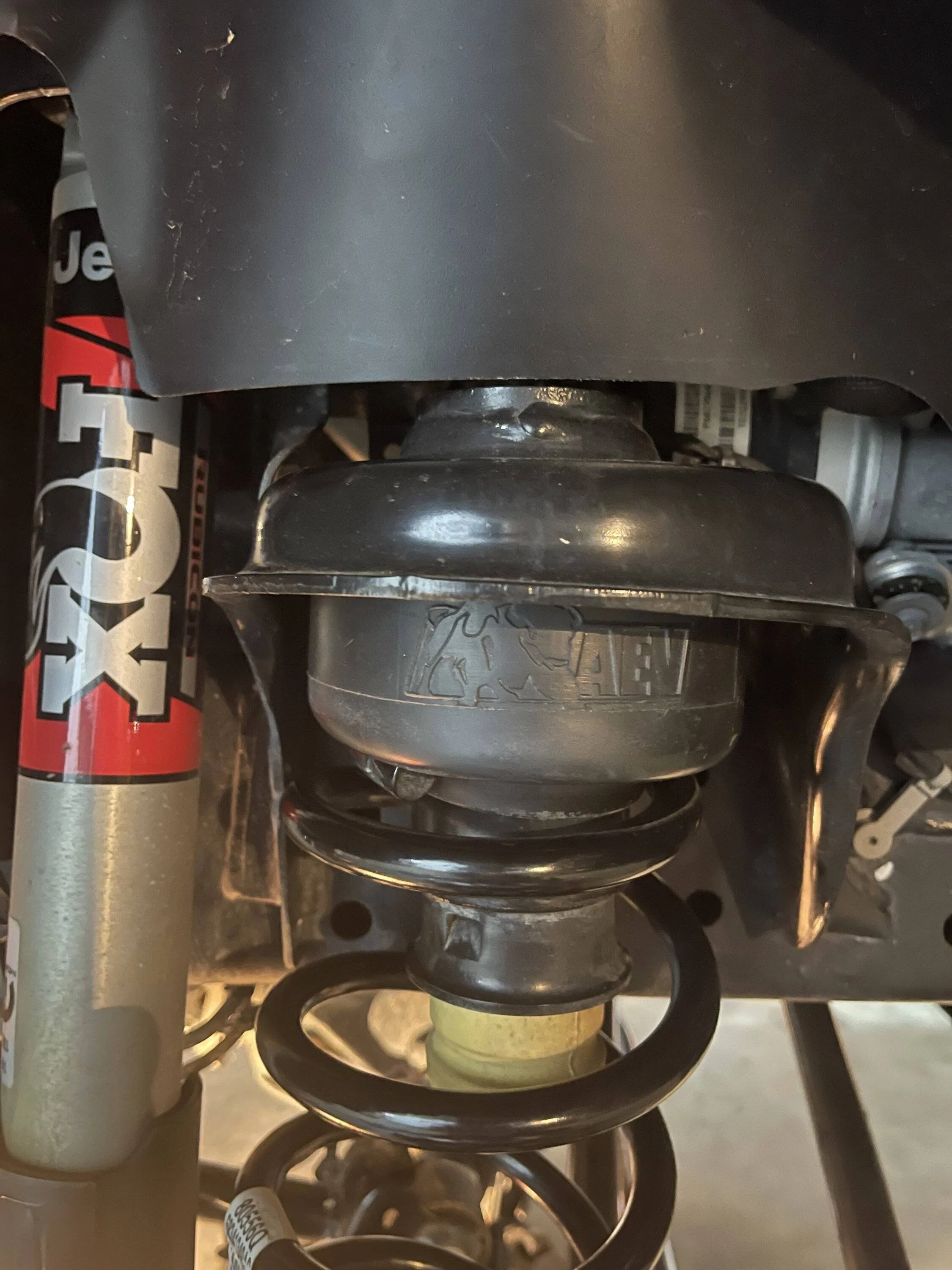

Any know if you can add a spacer to get rid of the rake up front? I had this AEV kit installed also but I hate the rake up front, when I purchased they said it would also level my JT.

So you want a leveling kit? The AEV kit is 2" in the front and 2" in the back so it would maintain the rack but just lift. I have the teraflex 1.5" that levels it pretty close. I originally bought the Rough Country leveling kit that was 2.5" in the front but thought that would be too much and make it high in the front.
Are you asking to stack spacer pucks?

Yes, stack spacer pucks up front to get rid of the rake. If that’s possible.

It's not ideal, but you can stack spacers.
The sway bar links and shock extensions with the AEV kit are made for 2" of lift. They'll be a little too short for more lift, but they can still work ok. Down travel will be a little less than it could be. And you'll want to make sure the sway bar will not invert itself when still connected and at full droop.
