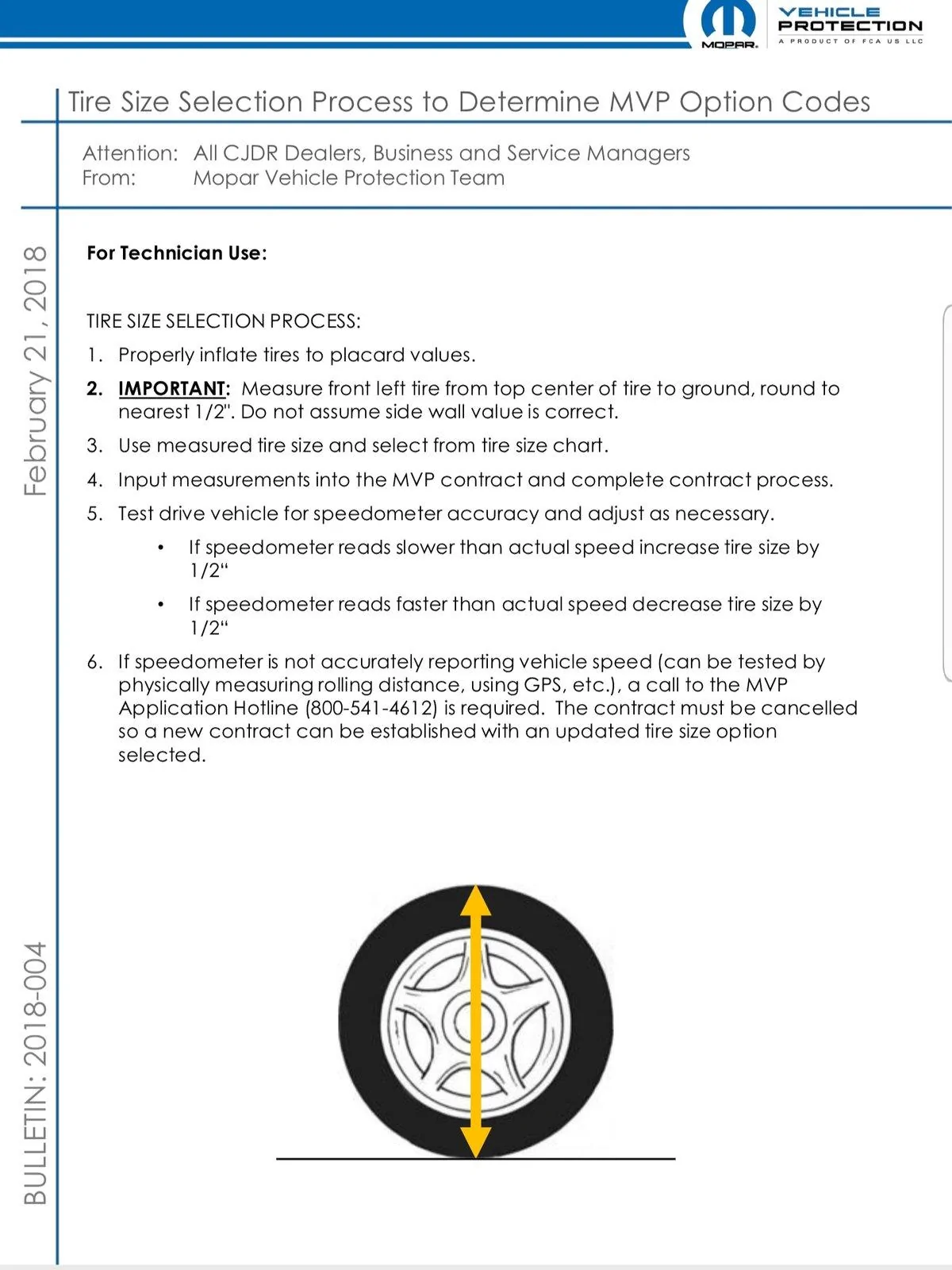

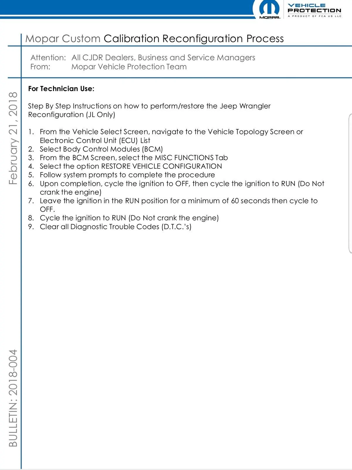

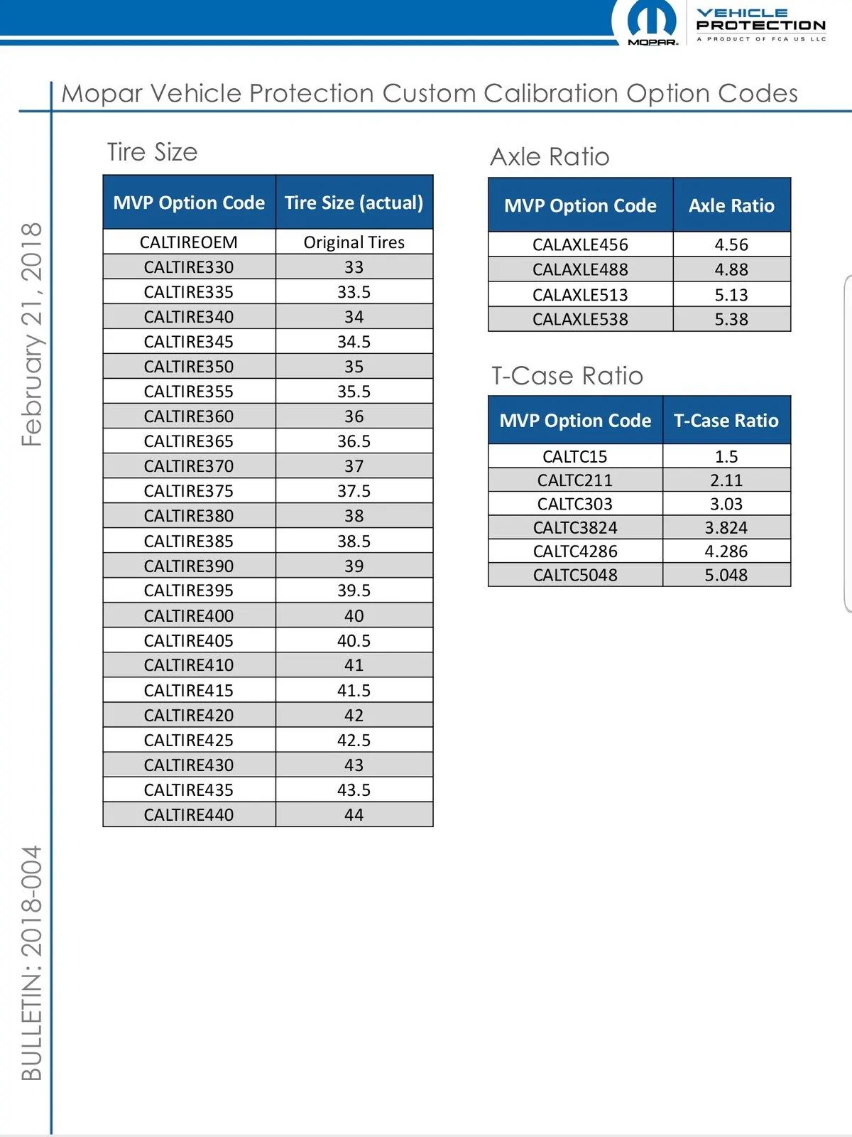

So how do we plan on recalibrating for the difference in tire size?
Dealership can adjust up to a certain diameter. Otherwise several places sell a handheld that plugs into your OBD2 port.

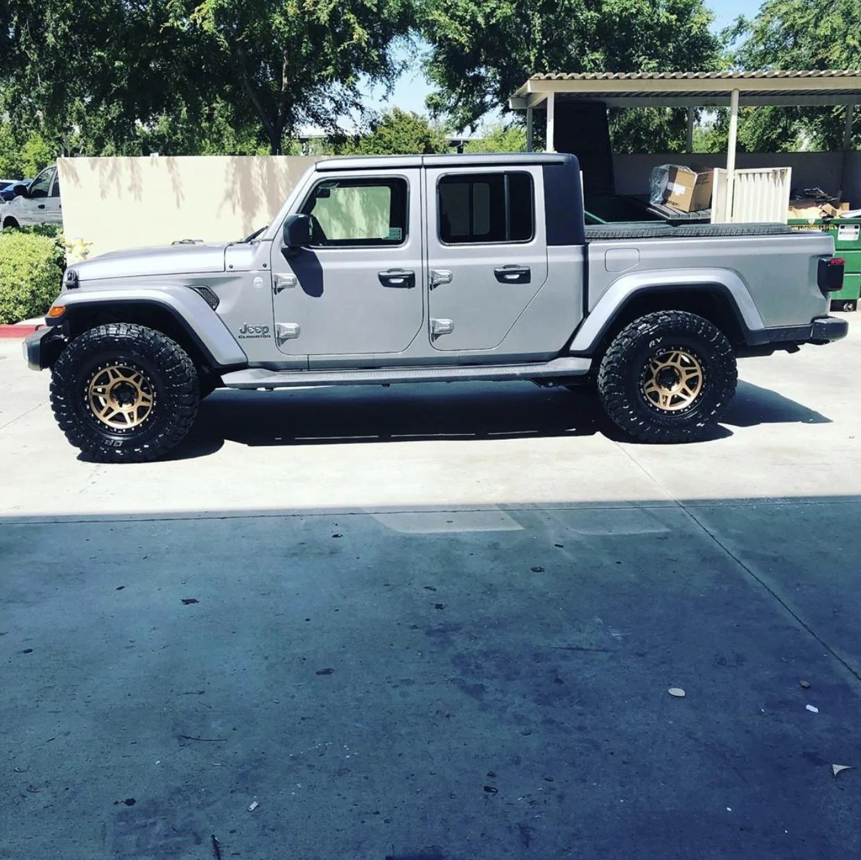

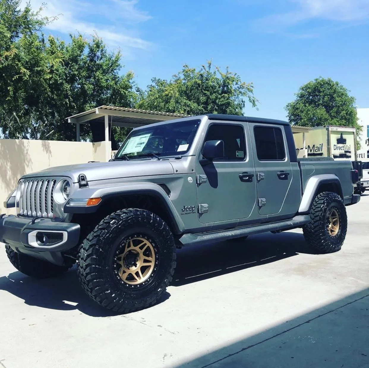

@SKT, that rigg looks sick! Im looking for some feed back on the ride, loss of power due to tire size and added weight. I'm looking at 37's but havnt made up my mind yet between that or 35's. Also, would you be able to give me an over all height of the rigg so I can see if it will fit in my garage? Thanks.
