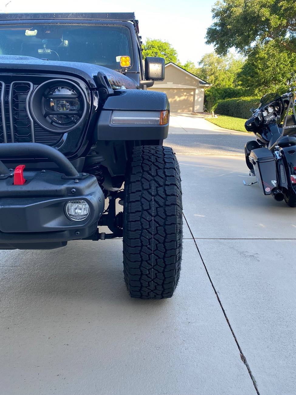

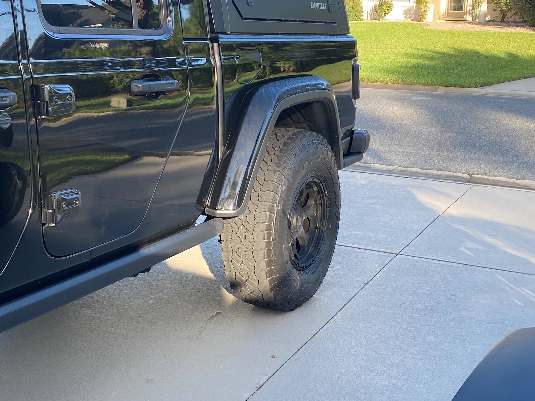

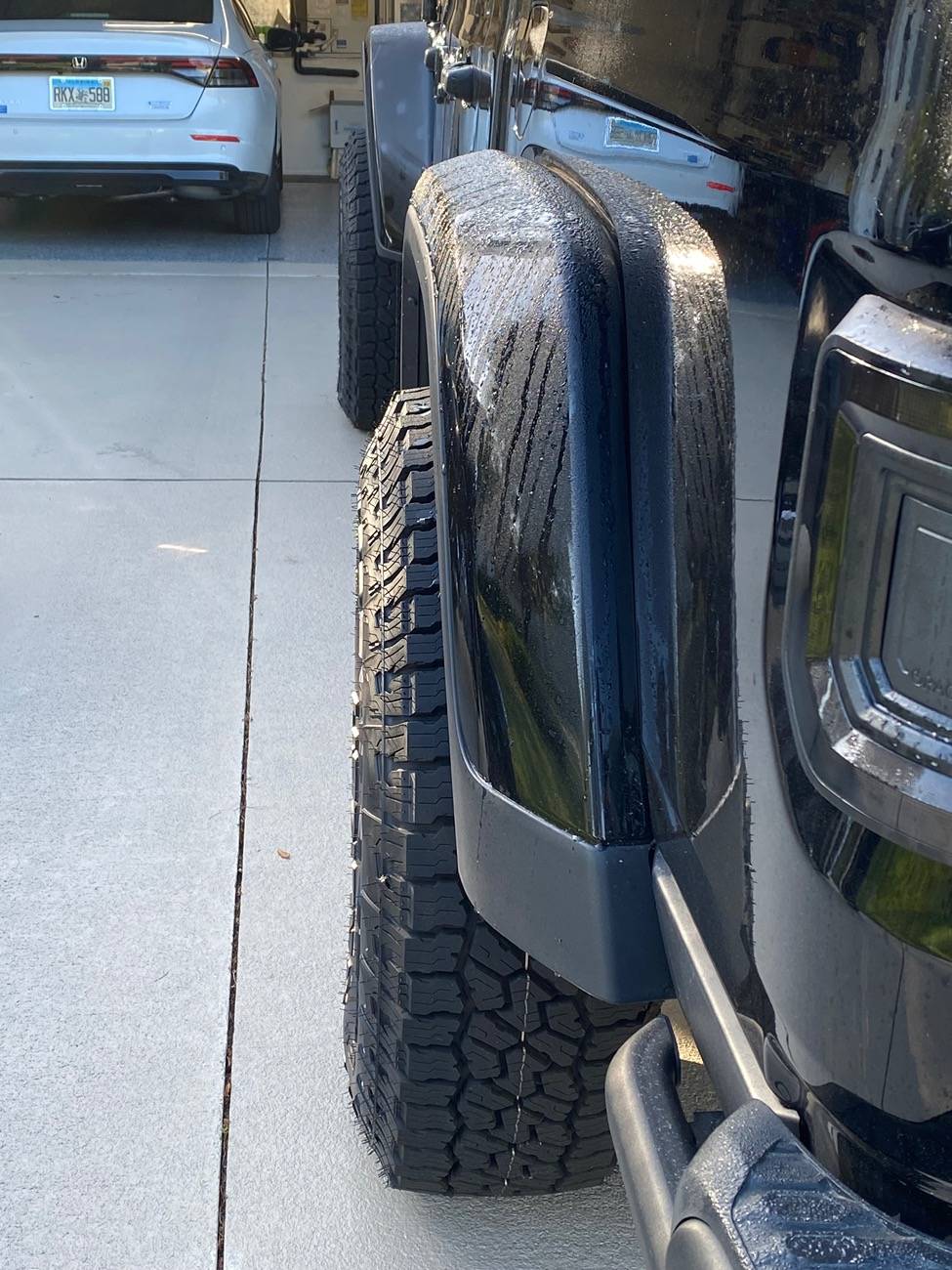

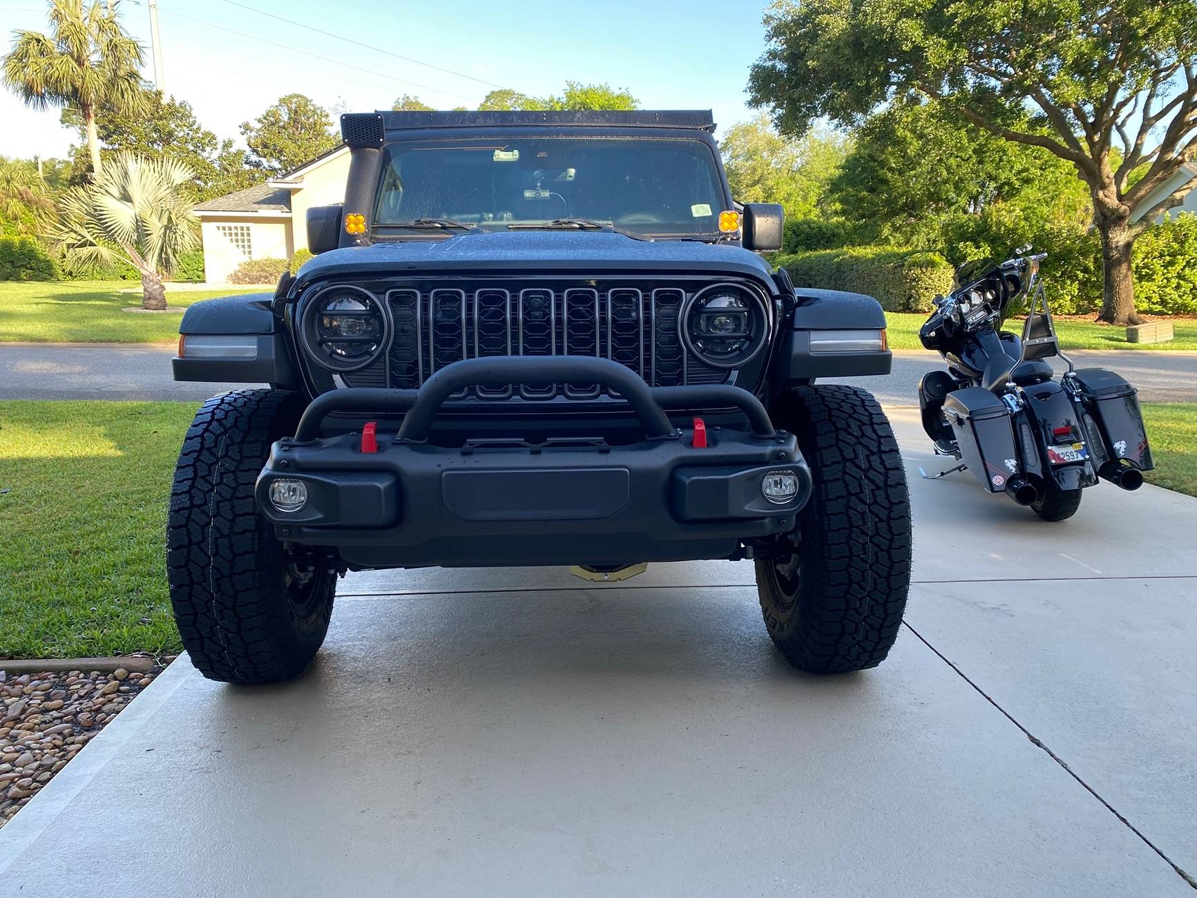

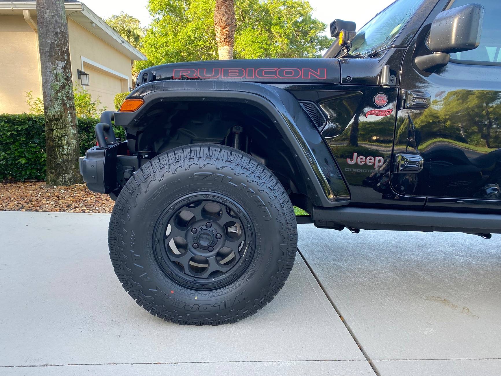

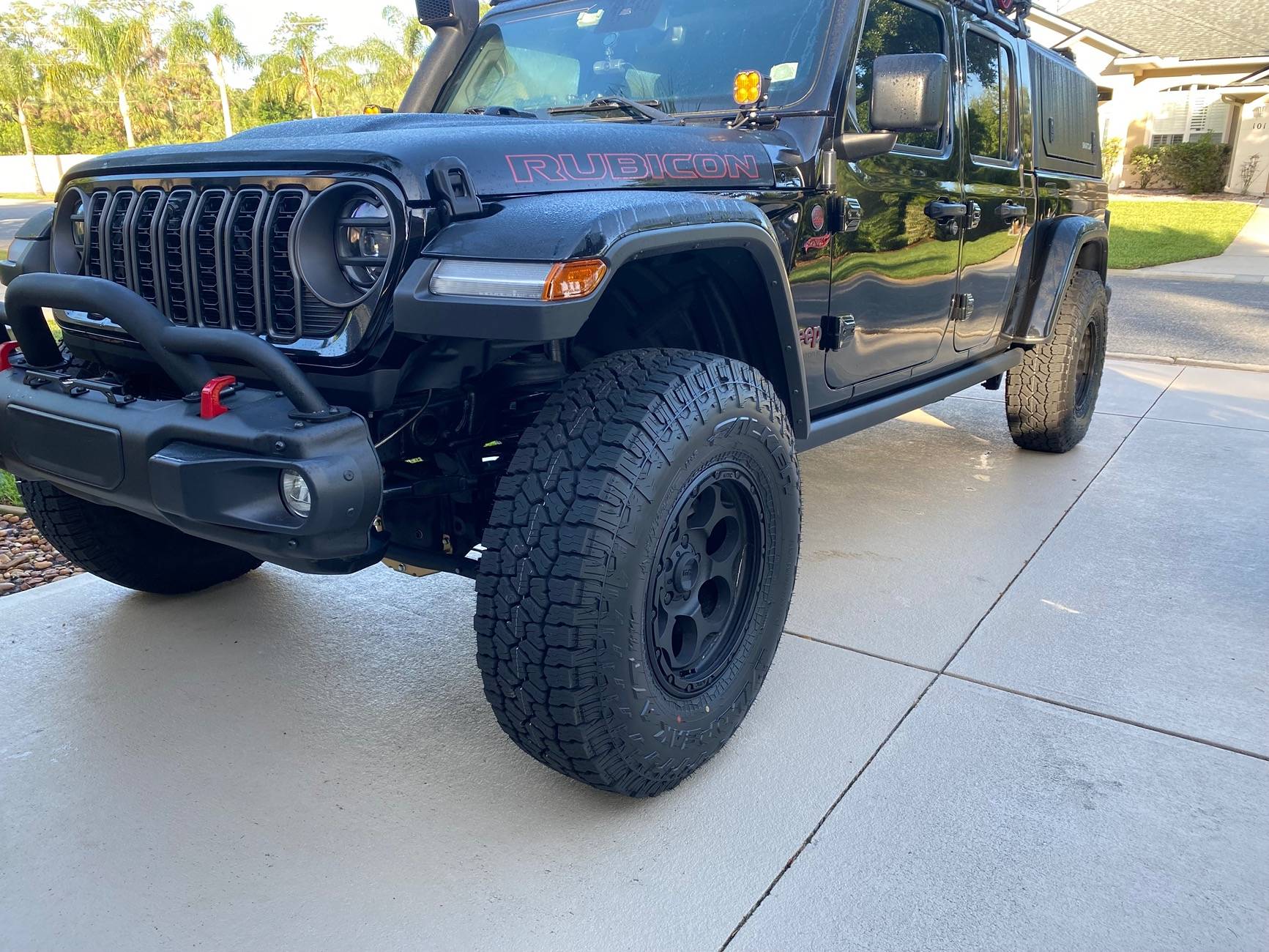

Falken Wildpeak A/T4W 35x11.5 (tread 8.7" wide v. stock 285/70 @ 9.6" wide) mounted on KMC Dirty Harry 8.5" wheels with +18mm offset so still has a little poke. Like them already!

Nice. I probly shouldn't have come back to look at the pics, it's been hard enough holding off most of the winter to put the new ones on. Any suspension mods?
Teraflex front 1.5” leveling kit and the 2-inch front shock extensions. The Rubicon has the higher front fenders allowing for a “no mod” increase to 35”s, but I didn’t like the nose down pitch attitude. Will probably go with a full lift kit and beafier springs with all this added weight (still have to add a WARN winch, skids and sliders).

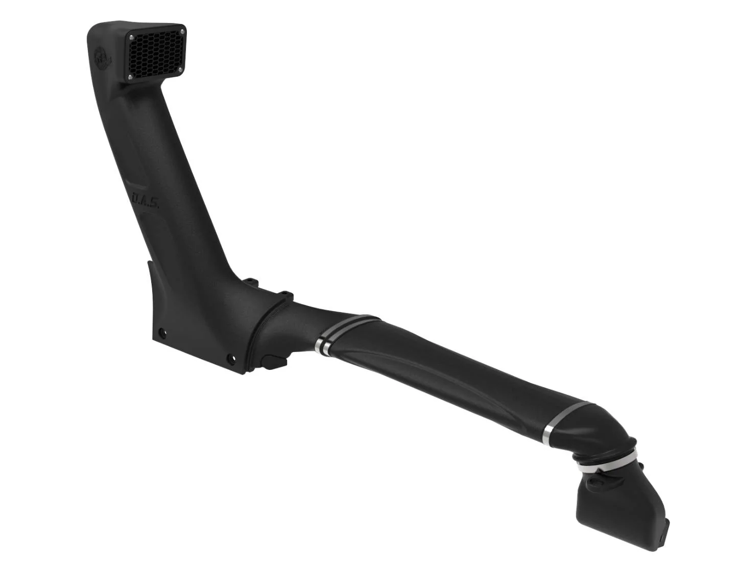

Slightly off topic...what snorkel are you running?

Can you do a review post? I like that snorkel! I want one for dust more than anything but AEV's you have to cut the hood and that's always bugged me, AmFib's had issues with the ducts collapsing and the big box section at the cowl messes with cowl lights.
This one seems to solve those cutting and cowl issues.
Like I said dust is my big thing, but even then an accidental splash/wave stream crossing this looks like it would help a lot to.

This is a awesome kit looks oem no cutting love it. This will not work with mojave hood but they will have one out for the mojave soon and than the diesel will be out soon after that, i can't wait.
I wish the intake scoop was removable, though, so a dust separator or pre-filter for dusty conditions.
