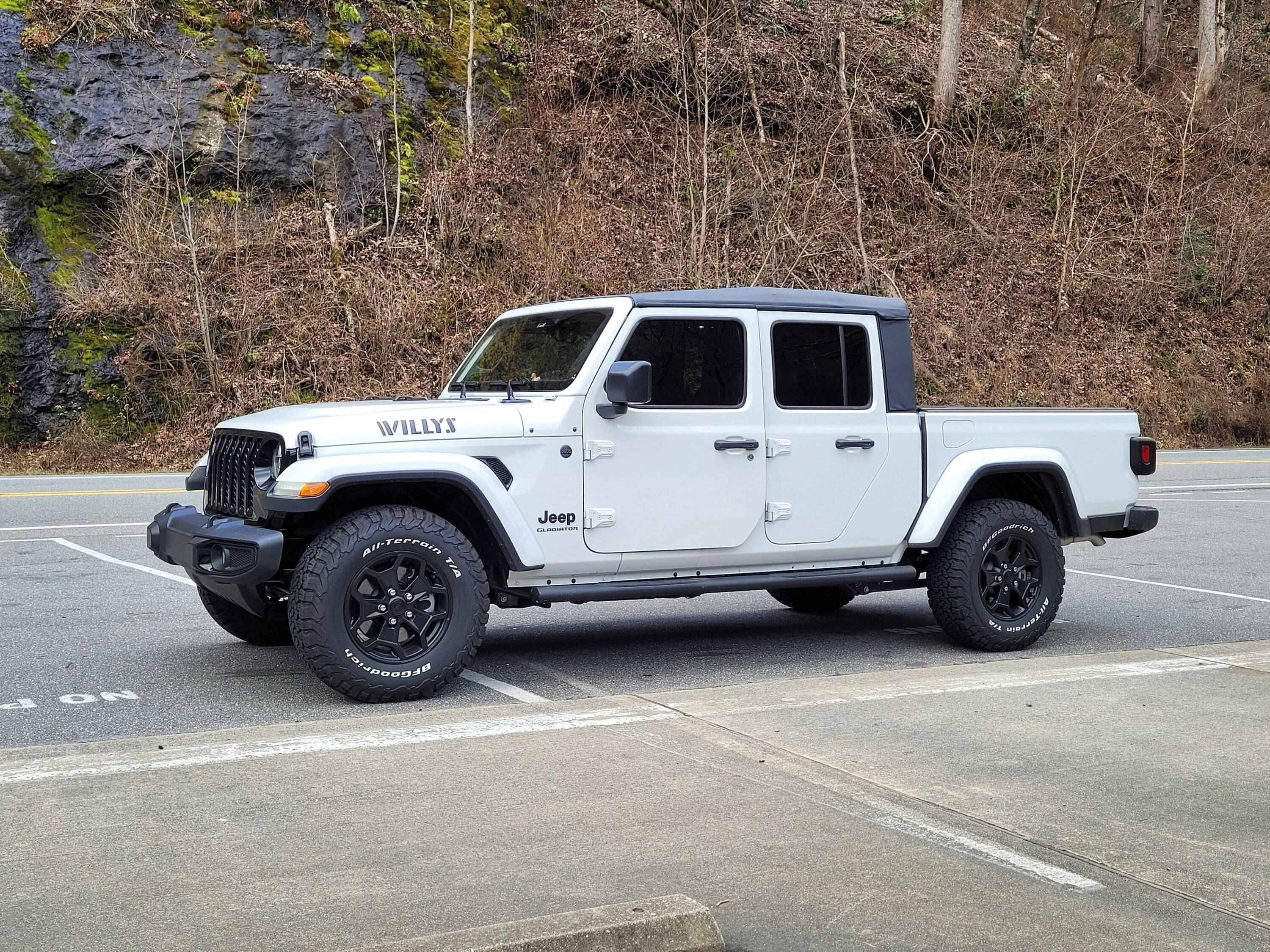

Maybe consider 33's, better look and capability than your stock, won't lose all the performance and MPG's of the 35's. I swapped the OEM MT's for these BFG KO2's and couldn't be happier. These tires exceeded my expectations on performance, noise and MPGs. I can hit 20 on the highway at a steady 70 and normally 16-17 around town.
Jeep Gladiator MPG impact with 35 x 11.5 Tires 20230123_154542

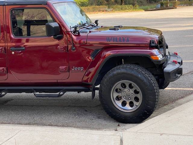

I have a 21' Willys and installed Toyo AT3's 35*11.5/17's about 2 months ago and yes I have seen a decrease in mileage. Most probably around 1-1.5 mpg.
Jeep Gladiator MPG impact with 35 x 11.5 Tires Jeep new tires 2
Looks great! I Like.
