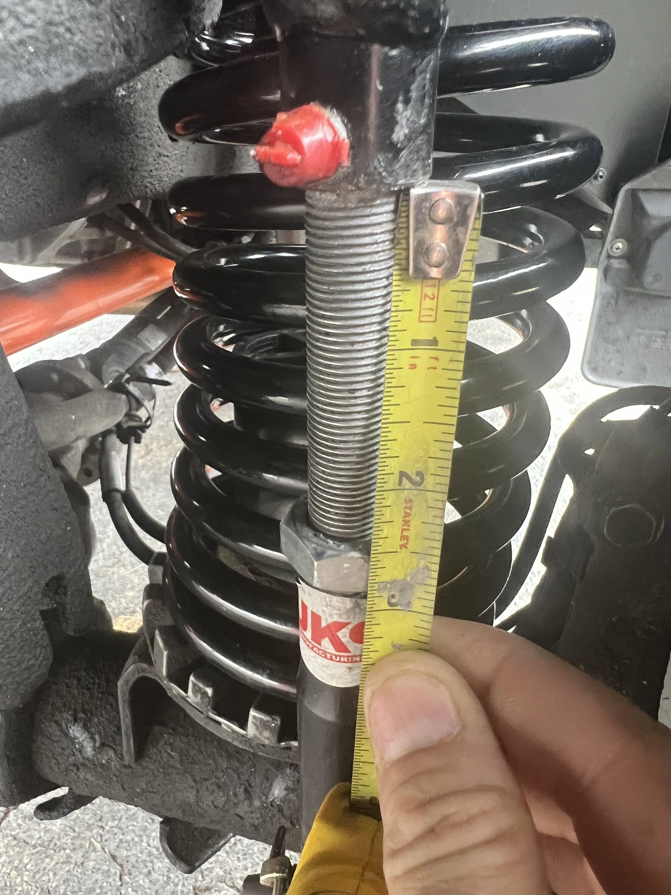

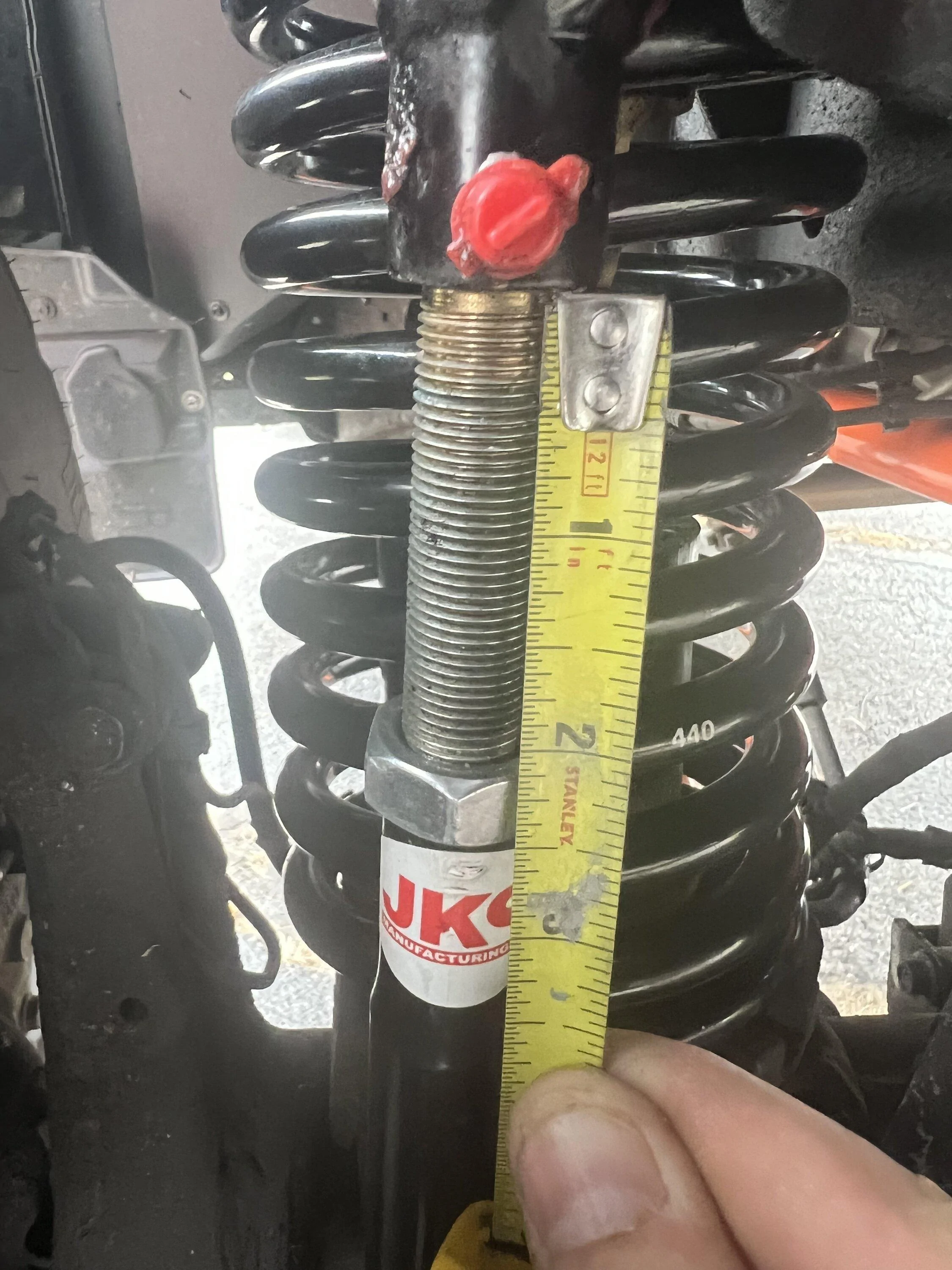

Anyone running the jks disconnects on their gladiators?
my drivers side measures 2.5inof exposed screw thread and passenger side is right at about 2in.
the instructions show me how to install but not the measurements I can not seem to find a chart by lift.
Not noticing any issues however without the old ones I’m not sure.
Oddly enough after the lift the passenger side is about 1/2 lower than drivers side but It evens with a driver inside.

I had mine set to the same length initially but ended up adjusting one side slightly longer. It was putting the sway bar into a bind and making it too difficult to disconnect, even though I was on level ground. I wouldn't sweat it. As long as the sway bar is at a slight angle upwards when connected and on level ground, and it's easy to disconnect you're good on the end link lengths.

All I needed to know, very much appreciated!!
