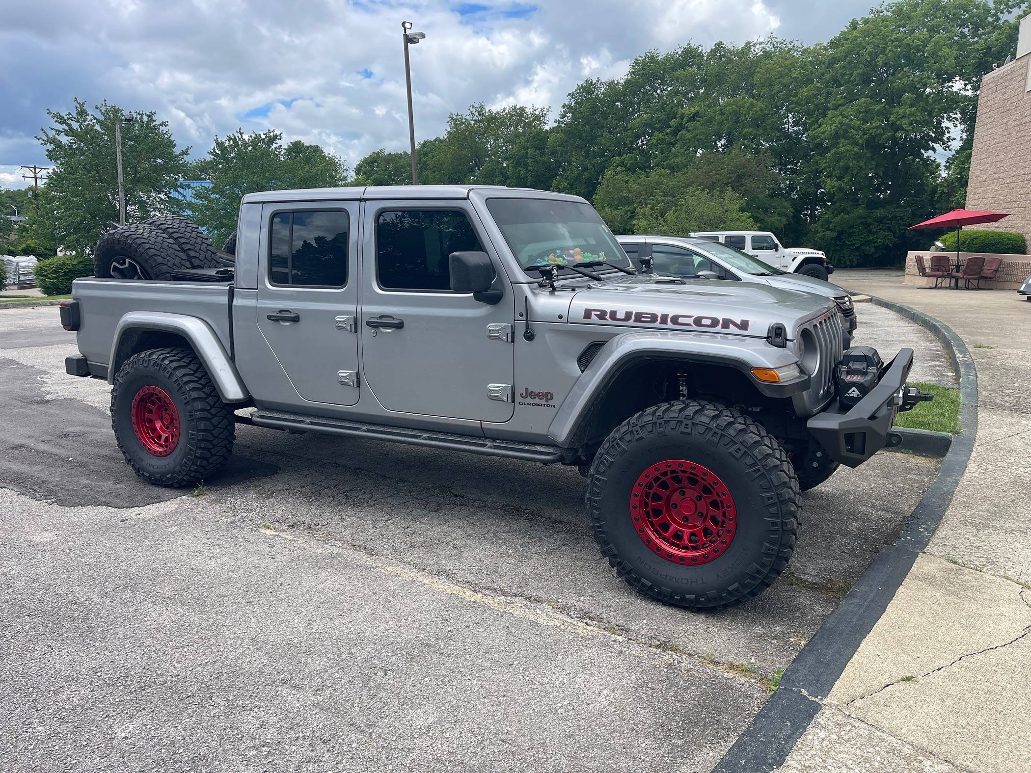

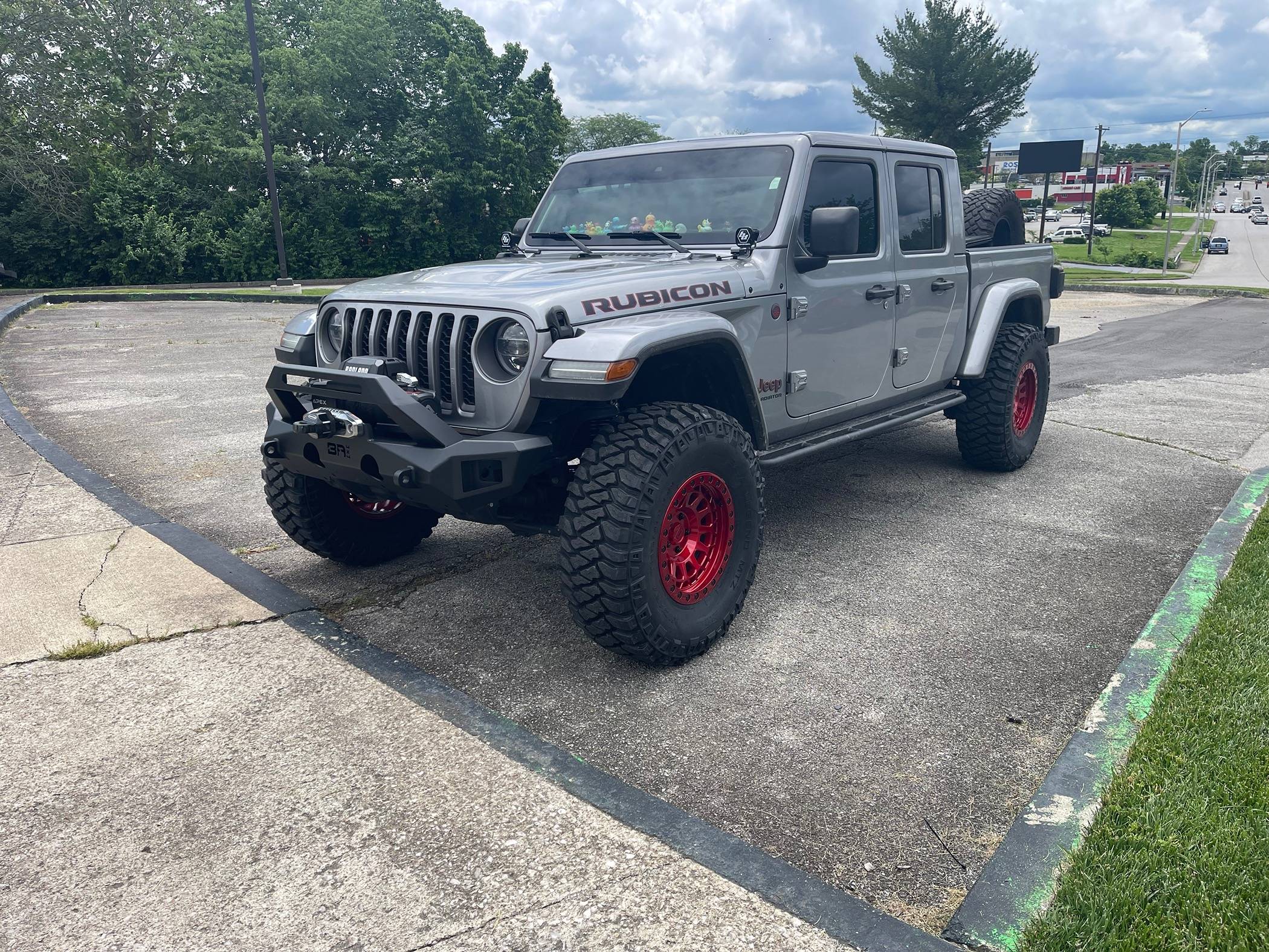

3.5” JKrawl with Fox 2.5” IFP shocks, Fox 2.5 steering stabilizer, 37x12.50x17 Mickey Thompson MTZs. Drives/rides better than factory. Couldn’t be happier.
Watch the control arm bushings if you have jks or bds control arms. They slide laterally and one side ends up being metal on one side. Their springs are fine, but the control arm bushings suck. If they start to fail, don’t let them screw you over. They wouldn’t give me a refund and had no solution. Out about $1,000 as a result. They’re dead to me.
