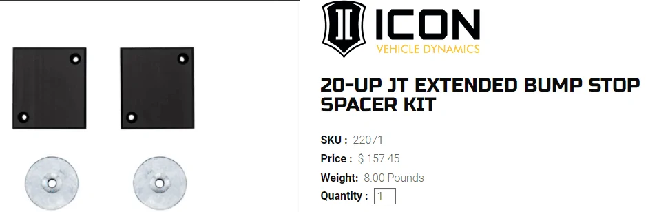

Just wondering if theres any other arms or bars I need to get to complete my lift kit or make it stronger. I already purchased:
- Icon Stage 4 Lift https://www.iconvehicledynamics.com...20-up-gladiator-25-stage-4-suspension-system/
- Icon Centerline Stabilizer Kit https://www.iconvehicledynamics.com...l-20-up-jt-centerline-stabilizer-kit-non-adj/
- Metal Cloak 1"-4" Front & Rear Adjustable Extended bump stops
Is there anything else I need to get? or will this be a fine (daily driver / weekend trail) setup

There are 1" front bump stop extensions in that kit, and it does not need them in the rear if 35" tires are used. Relocating the rear sway bar can be better than extended links actually, because it keeps everything higher up and away from rocks. I considered doing that, but it was easier to just order links. There is an optional bump stop kit available if you want to use 37" tires.

I was going to get the icon bump stops but instead I went with the Metal Cloak 1-4" adj. bump stops. Yes, I will be going with 37s as well.
