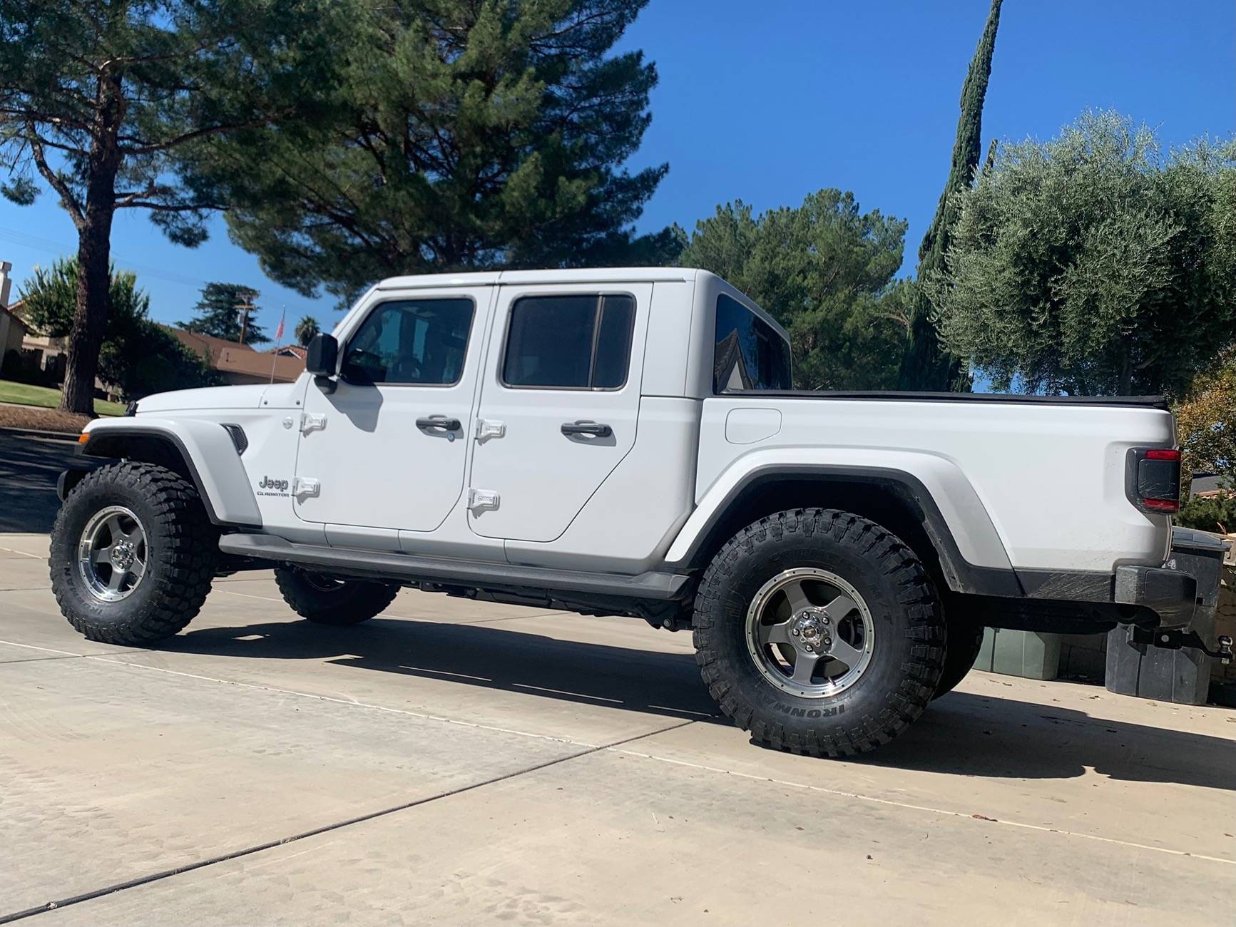

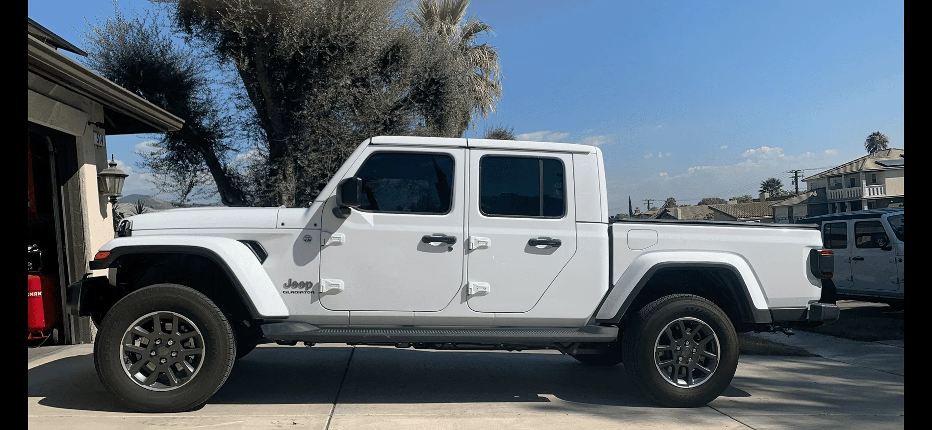

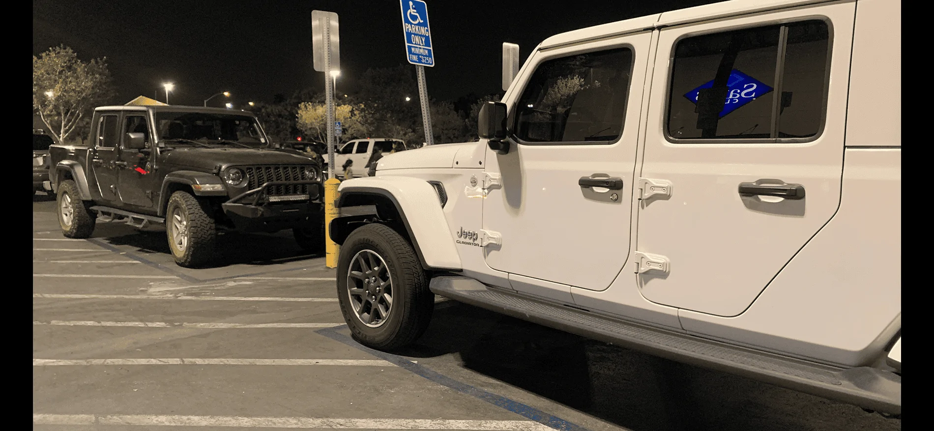

I went with a cheap Amazon leveling kit when I first bought my overland. My reasoning for cheap was I knew I would be lifting in the future. It came with 2” spacers, shock extensions, bump stops, and sway bar end links. Less than 100 bucks. I would have had zero complaints if I were still running that setup. My wife drove 40k miles and several tough trails in her JLU with just a spacer setup.
Jeep Gladiator Recommended Level Kit for 2020 Gladiator Overland IMG_2552
Jeep Gladiator Recommended Level Kit for 2020 Gladiator Overland IMG_2558
if you’re not looking at doing trails, this setup will fit up to a 37” tire with ease.

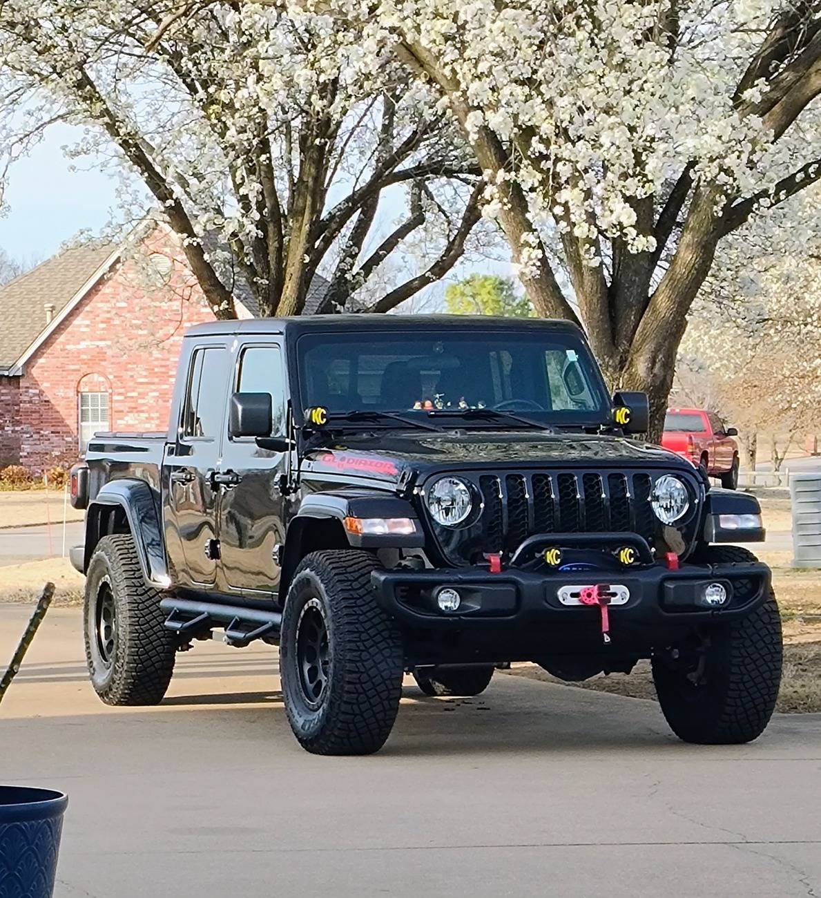

I have the Rancho level it kit. It's 1 1/2 inches for a Rubicon, so add about 3/4 to 1 inch for non Rubicon. I also added a 1/2 spacer to the front and a 3/4 spacer to rear. Also added Rancho geometry brackets. I have about 25000 miles on this without any issues at all.

Do you have any rubbing?
Absolutely no rubbing with factory tires. On 37s on the street no issues at all, but as soon as you start hitting the trails you’ll rub all over the place on 37s. I’m lifted 4.5” now and still find a way to rub on 37s. If you stick to 33-35” you won’t see as many issues.
