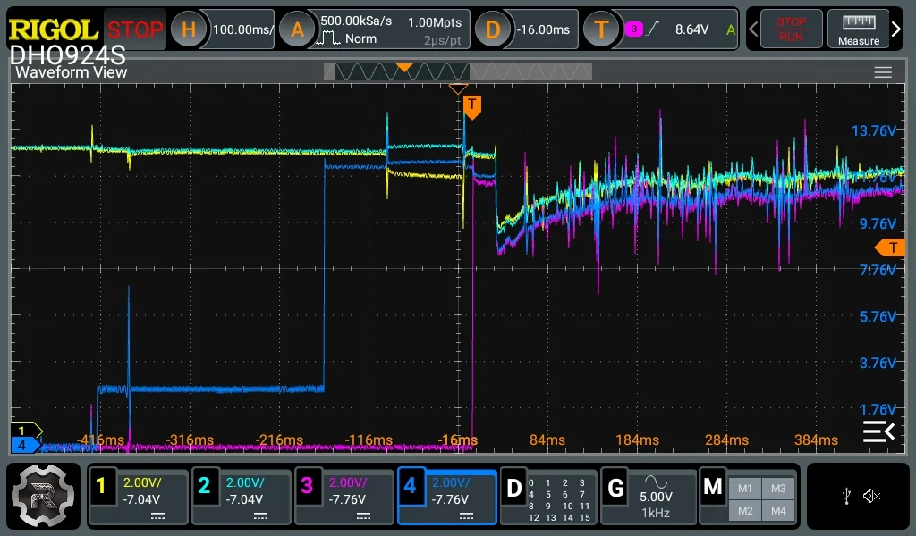

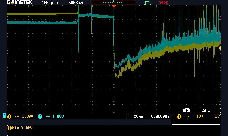

Yes, lots of noise when starting. This scope makes it easy to transfer the image.
That kind of noise isn't kind to things.

PCR relay closing, seeing things I did not before.
Jeep Gladiator Are the batteries really isolated during ESS stops? RigolDS3

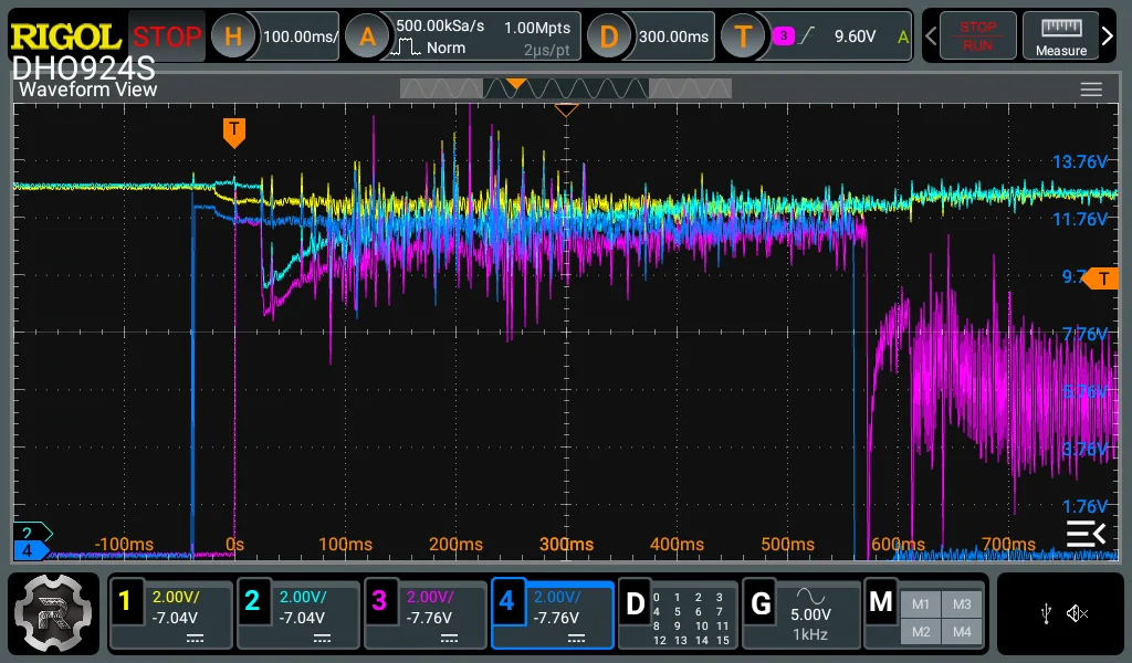

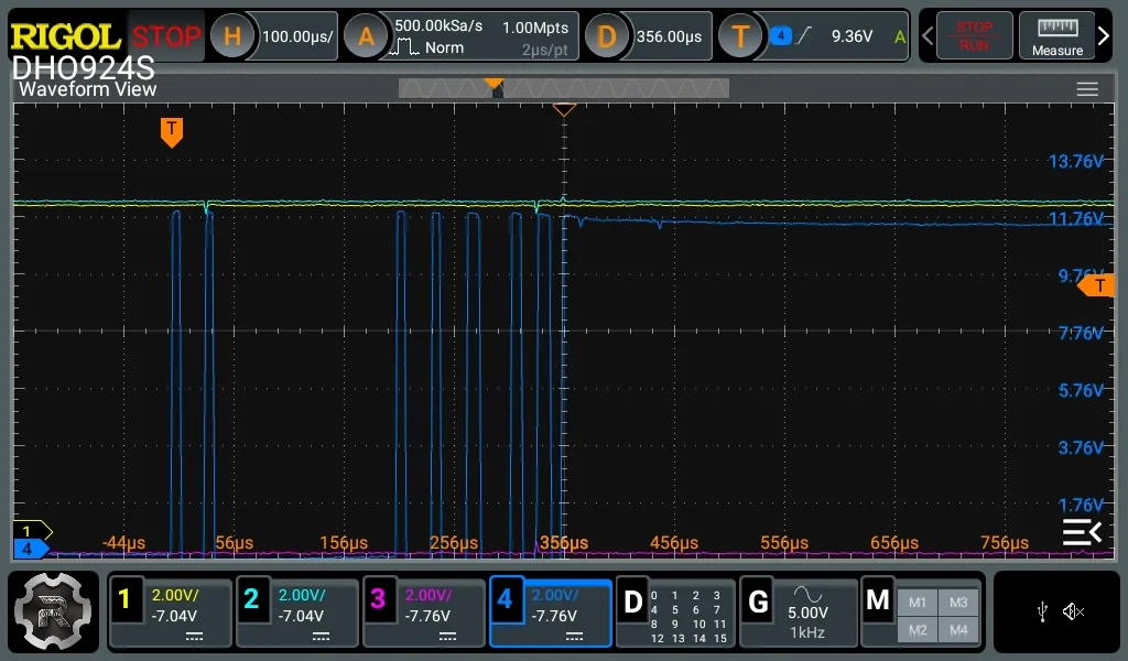

Nice scope! I came home after Thanksgiving with a 12-bit loaner to play with for the next month.
Those narrow pulses in #302 are only one sample wide. That scope can store at least 10M pts per channel. The waveforms can look even hairier.

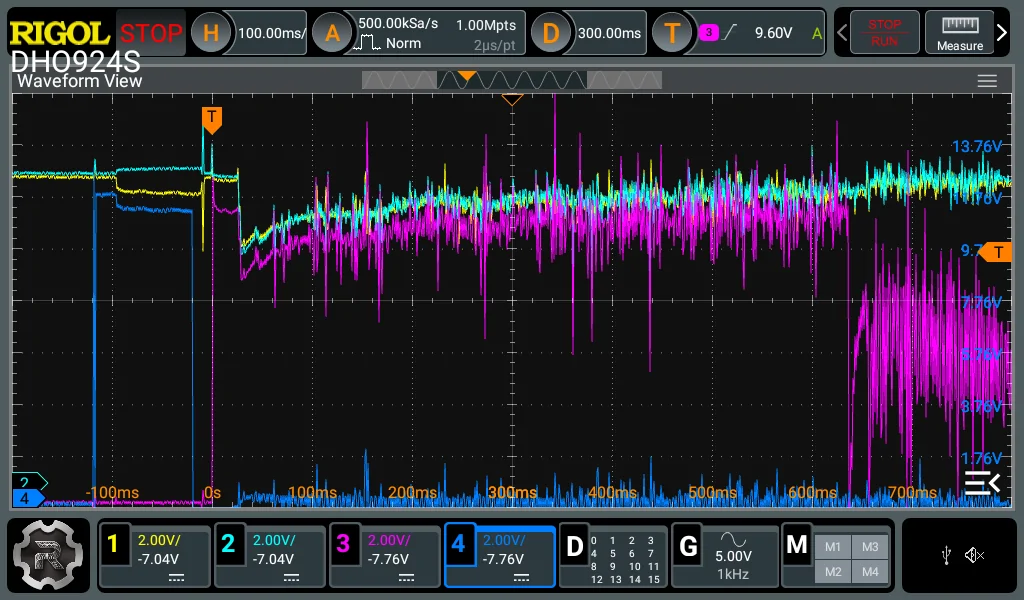

K1 run/stop relay is blue
Jeep Gladiator Are the batteries really isolated during ESS stops? RigolDS8

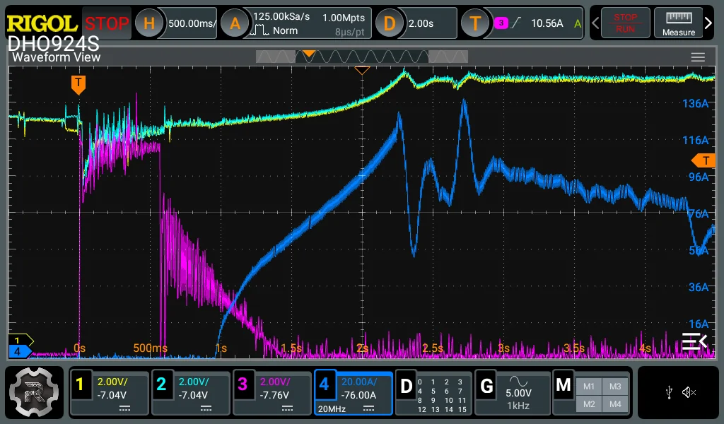

Cold start alternator current. Blue is current.
Jeep Gladiator Are the batteries really isolated during ESS stops? alter0
