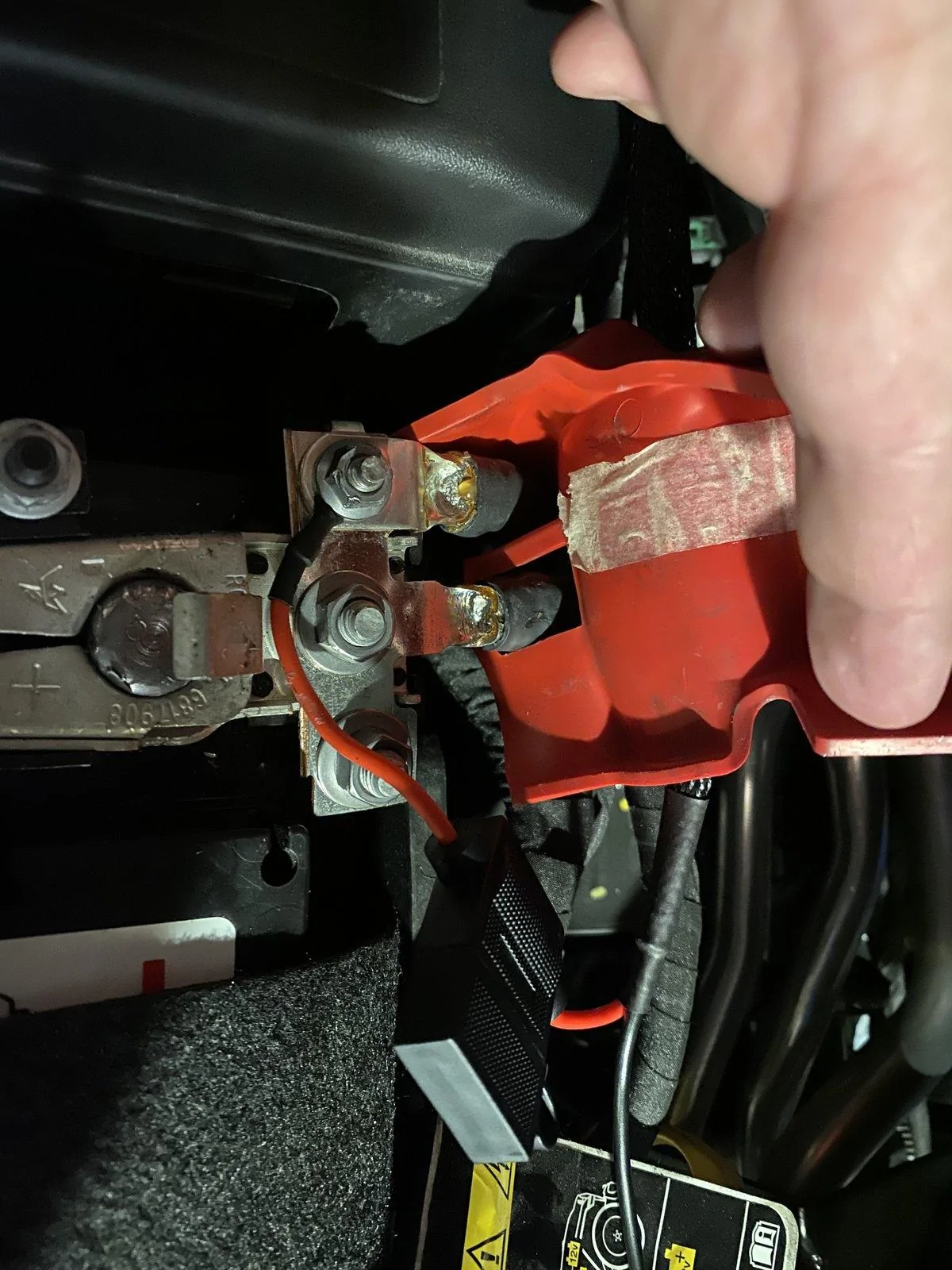

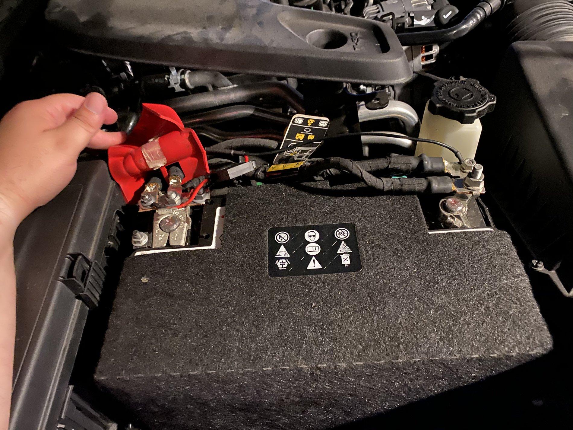

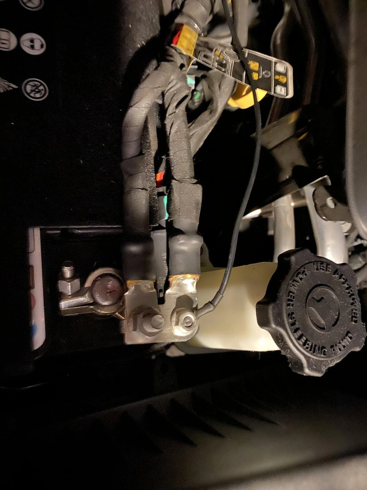

I just completed the Rock Slide Engineering install. Everything works as advertised, but when I went to start the truck, it wouldn’t start.
The main battery seems to have plenty of juice. The radio works, steps work, but I am getting a check engine light and sway bar disengage not working notice on the dash screen. Assume this is just caused by the battery running down, and will fix itself after I restart the vehicle.
When I hit the ignition, I do here a click, and some lights dim for a moment. I can also here the RSE steps cycle during that time. Before I bother jumping, I’d like to figure out what drained the battery in the first place. The only tie-in to the stock electrical is when I tapped into the battery for power. I thought it wouldn’t matter which bolt on the terminal I mounted my power feed from, but did I accidentally hook up to the ESS battery instead? Launch Edition if it makes a difference

Disconnect the new wires and see if it starts. If not, put a charger on it. Did you play the radio while doing the install? How many times did you cycle the steps without the engine running?

No radio the entire time, and the fuse was pulled from the harness until right before I tested everything. I probably cycled each side 6 or 7 times, and I have the LED package with the steps, but I can’t imagine that’d be enough to drain the ESS.
Tried disconnecting and reconnecting, but it didn’t make a difference. Everything was running fine yesterday.

I would disconnect the steps, charge the battery, and see if it starts. If so, reconnect the steps and test again. If not, disconnect both batteries for about an hour and then see if it will work.

Turned out I just had a defective ESS battery. Apparently there were a few bad batches early, but they never recalled them. Haven’t had any issues since they swapped it out early September.
