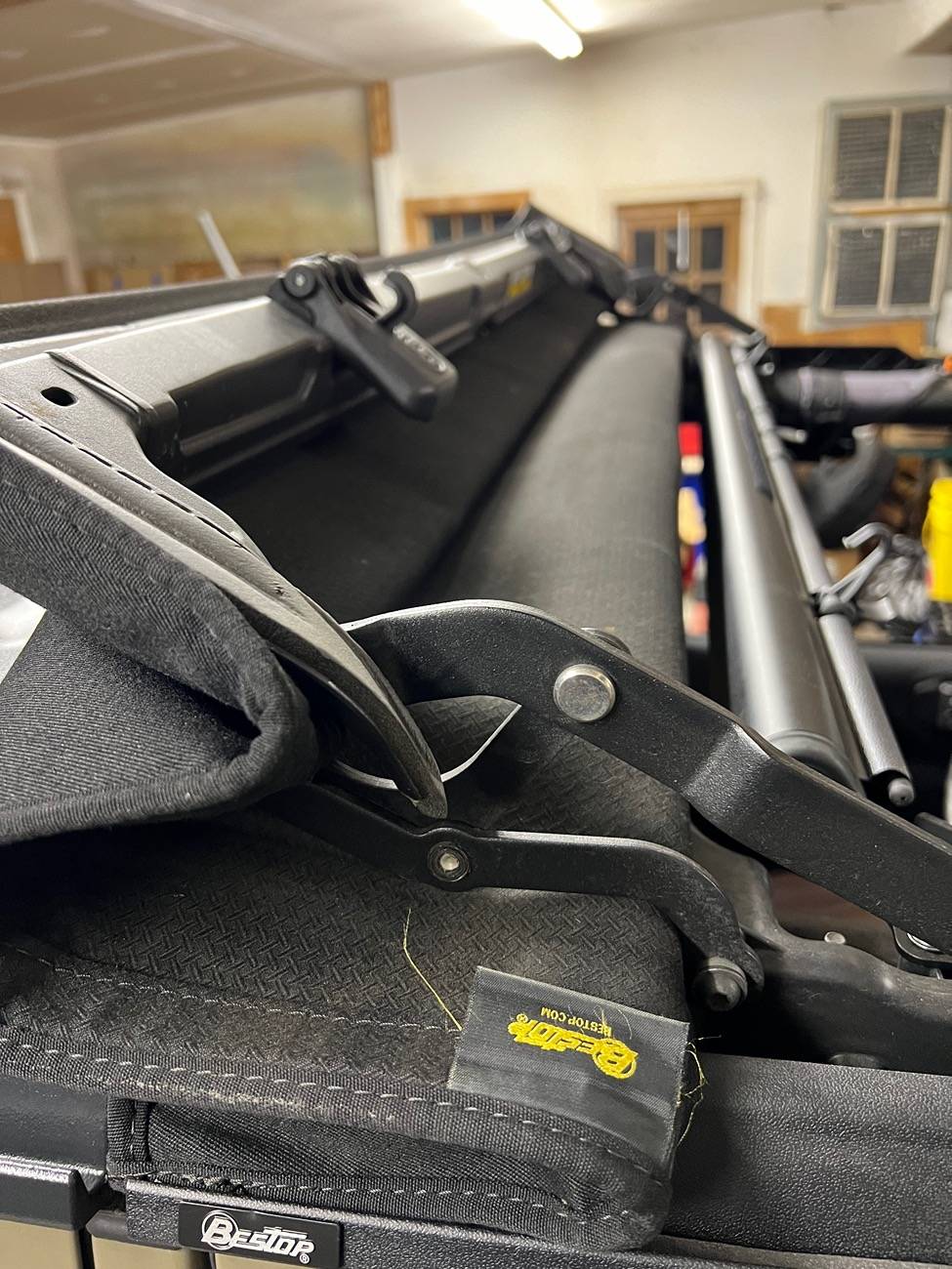

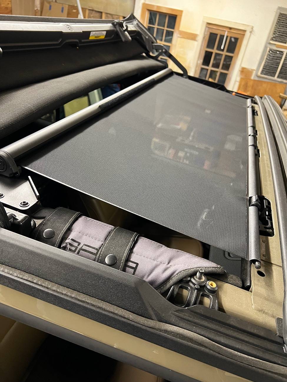

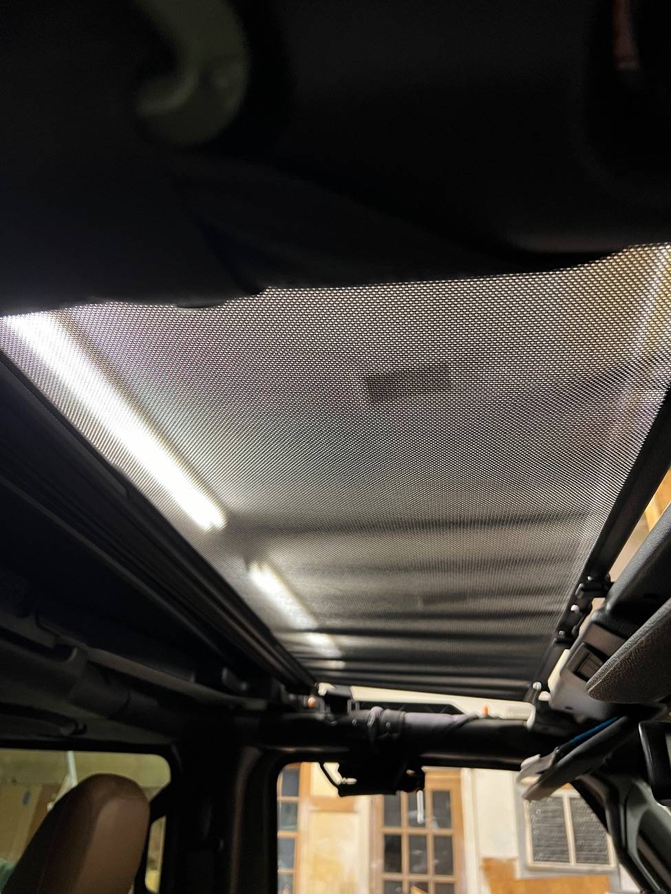

The Bestop Retractable sunshade sits high - but you need the Sunrider to use it.
