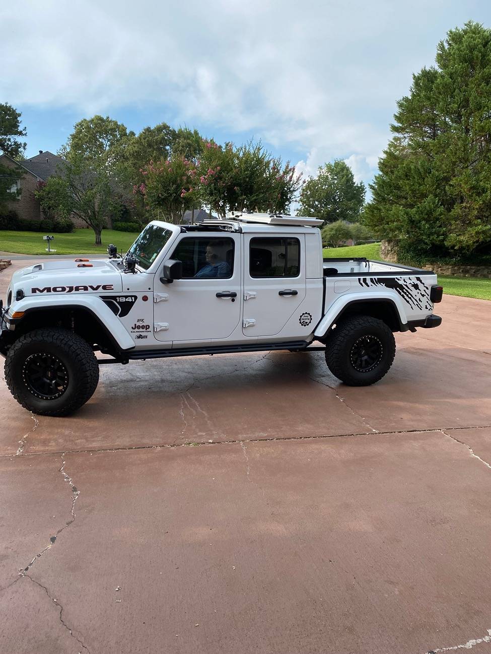

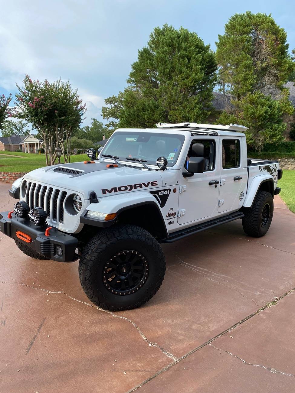

Those looks awesome on the Mojave, I thought about this for mine, Really want to get some good honest opinions on it and the effort of install.
I was 70 when installing the top. To install using just the 3M strips is fairly easy, other than getting on top of the cab. You need to be a little patient and make sure the pieces are lined up properly. There are videos on how to.
The kit comes with the bolts and drill bit to use to make the top more secure. The flip panels are marked as to where to drill, all holes/bolts aren’t visible when Freedom Panels are in the down position.
As mentioned in my first post to install the bolts on the fixed part of the roof you have to slide the roof back a little bit to gain access to the bolts. You don’t need to remove it.
I did the install by myself but perhaps a second pair of hands would be better.
