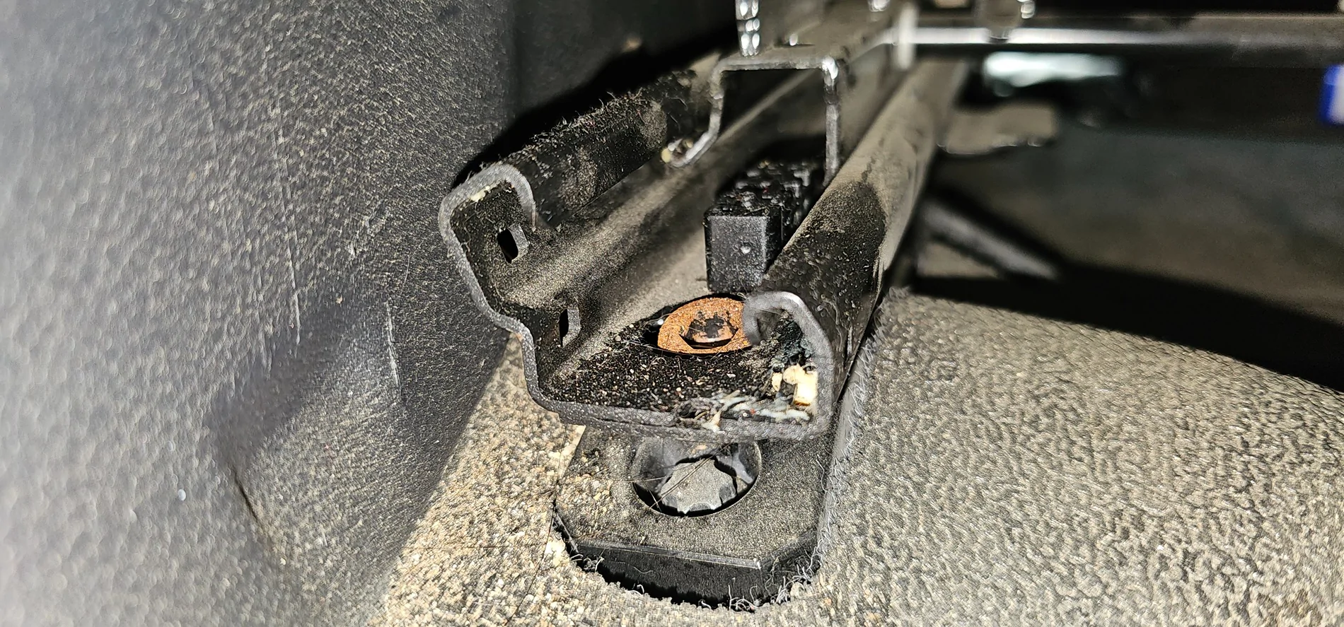

The rusty ass bolt head is the jacker bolt.

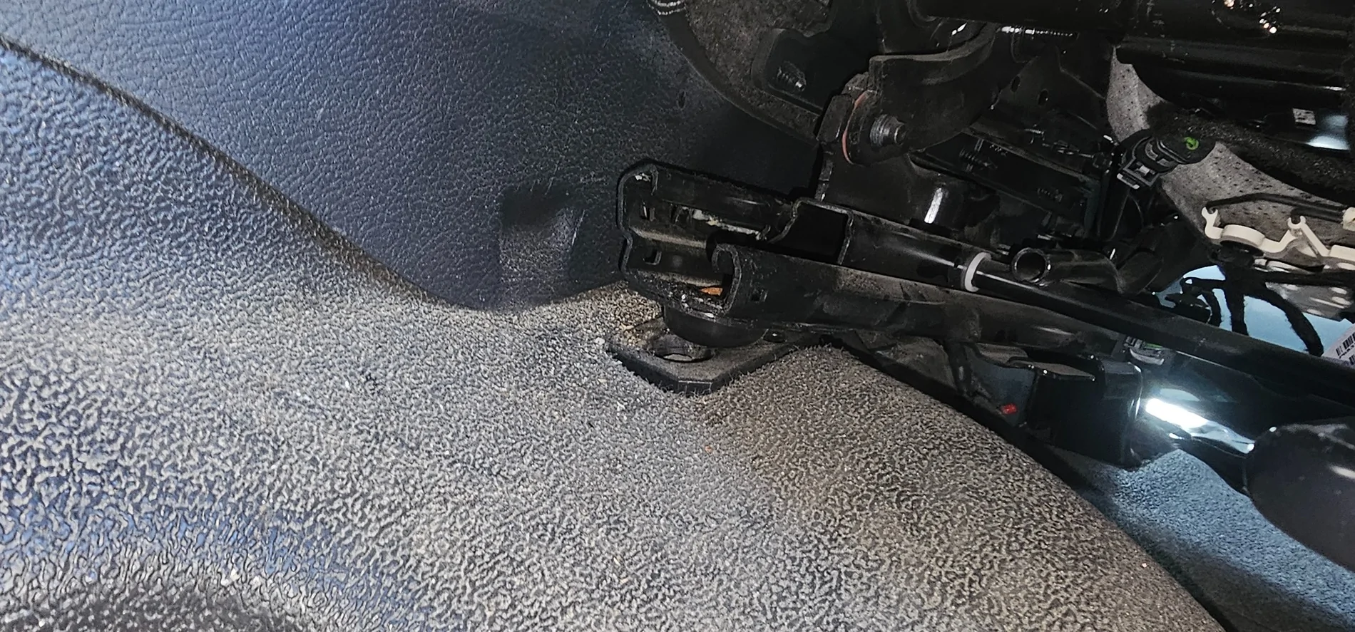

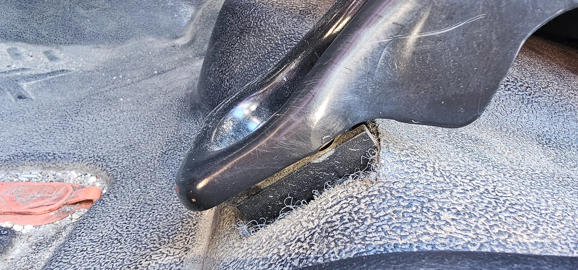

Some additional pics of driver inboard and outboard.
Jeep Gladiator Armorlite and SeatJackers 20251102_112020
Jeep Gladiator Armorlite and SeatJackers 20251102_112008

Looks similar. I might try to just loosen the other bolts and slip it in again and see if I can get it to line up. Thanks for the pics and good lord that is a rusty bolt 😂
Yeah I feel like they could have used a higher quality bolt :( the outboard bolt is the same just not visible in the picture
I don't go water fording or anything...
