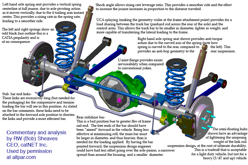

First, if you answered the poll above with selection 3, then you might want to review the info below starting with the Allpar info in the second post in the thread;
http://www.jlwranglerforums.com/forum/threads/articulink-in-the-jt-wrangler-pickup.1141/#post-5317

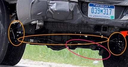

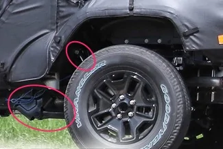

After looking at the recent spy photos in the other thread;
http://www.jlwranglerforums.com/for...-on-public-roads-shows-spare-tire-mount.1140/

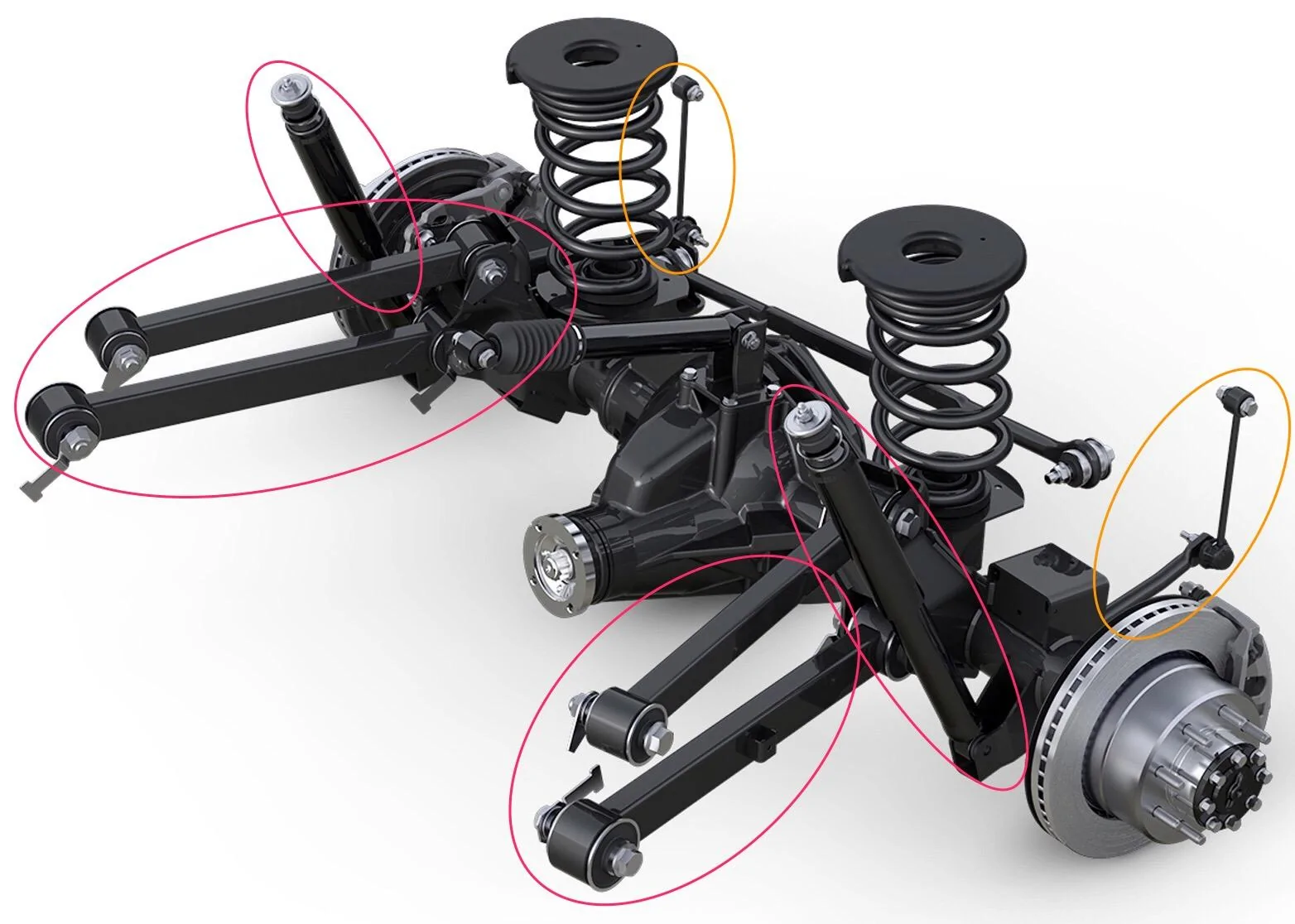

I think I've spotted the Link-Coil hardware (similar to that in the PowerWagon, only mated to a D44 instead of the AAM 11.5) in the rear of the JT mule, the actual Articulink hardware would be in the front. But looks promising.
Although they could just stick with the traditional front axle, but there's been rumours of this in the JT for a while.
Would definitely allow for greater capacities for towing and payload, and if it also gets the air suspension more flexibility for load leveling as well as raising that long box for improved departure angles.

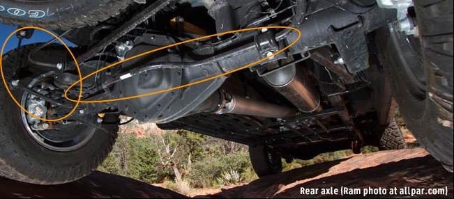

Anywhoo... first, no the Articulink wouldn't be be in the rear it would be in the front, the only reason I posted the rear was as reference to a change vs the JK, and one in which we previous had thought articulink was spotted with the same configuration. I also mistakenly thought the PowerWagon rear was different than the standard 2500 rear due to pics in another review I quickly checked before leaving, but their image was simply missing parts.
So seeing the updated rear-end gives me pause / makes me wonder if the front won't also get an update too.
I was hoping that all this would result in clearer photos of the front or at least existing ones without the JL logo.
Anywhoo, essentially the Articulink replaces the upper and lower control arms in the front with a single radius arm attached to the axle (often at the two points the upper and lower would usually connect, but could even alter that design.
Benefits
- A little more stability and predictability, especially under braking with heavy loads.
- Less likely to bump-steer or death wobble (but the cause is really worn out bits for both not design issue per se)
- With more freedom of travel up/down should be smoother at high speed and even at clower speed for things link speed bumps.
Drawbacks
- Slightly less articulation (but still much better than IFS)
- Bushings tend to wear out quicker if you are constantly putting strain on them off-roading*.
(likely last fine for an on-road or dirt/soft-road truck, but wear out quicker if off-roading/crawling alot)
- Large lifts are slightly more complicated, expensive and harder to come by until the aftermarket catches up.

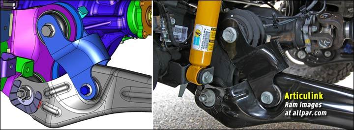

Allpar PW add-on description with front view of Articulink setup and how swaybar etc attaches;
http://www.allpar.com/trucks/ram/power-wagon/2017-specs.html

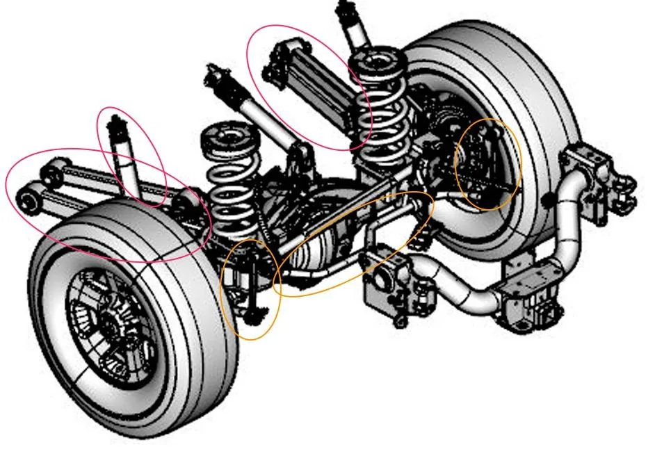

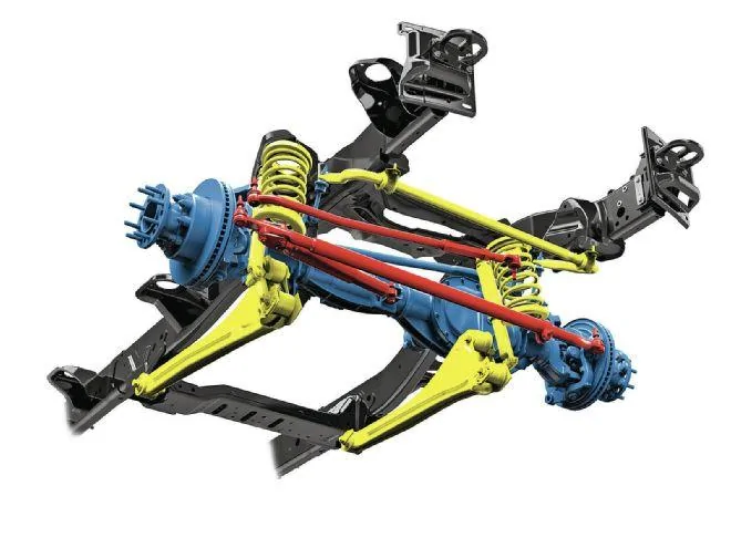

View of Entire PW front and rear suspension (Sorry I didn't make it clearer what was visible in the spy shots);
Jeep Gladiator Articulink in the JT Wrangler Pickup ? IMG_0286
View of just the 3 link suspension setup (from a 3500);
Jeep Gladiator Articulink in the JT Wrangler Pickup ? IMG_0341
