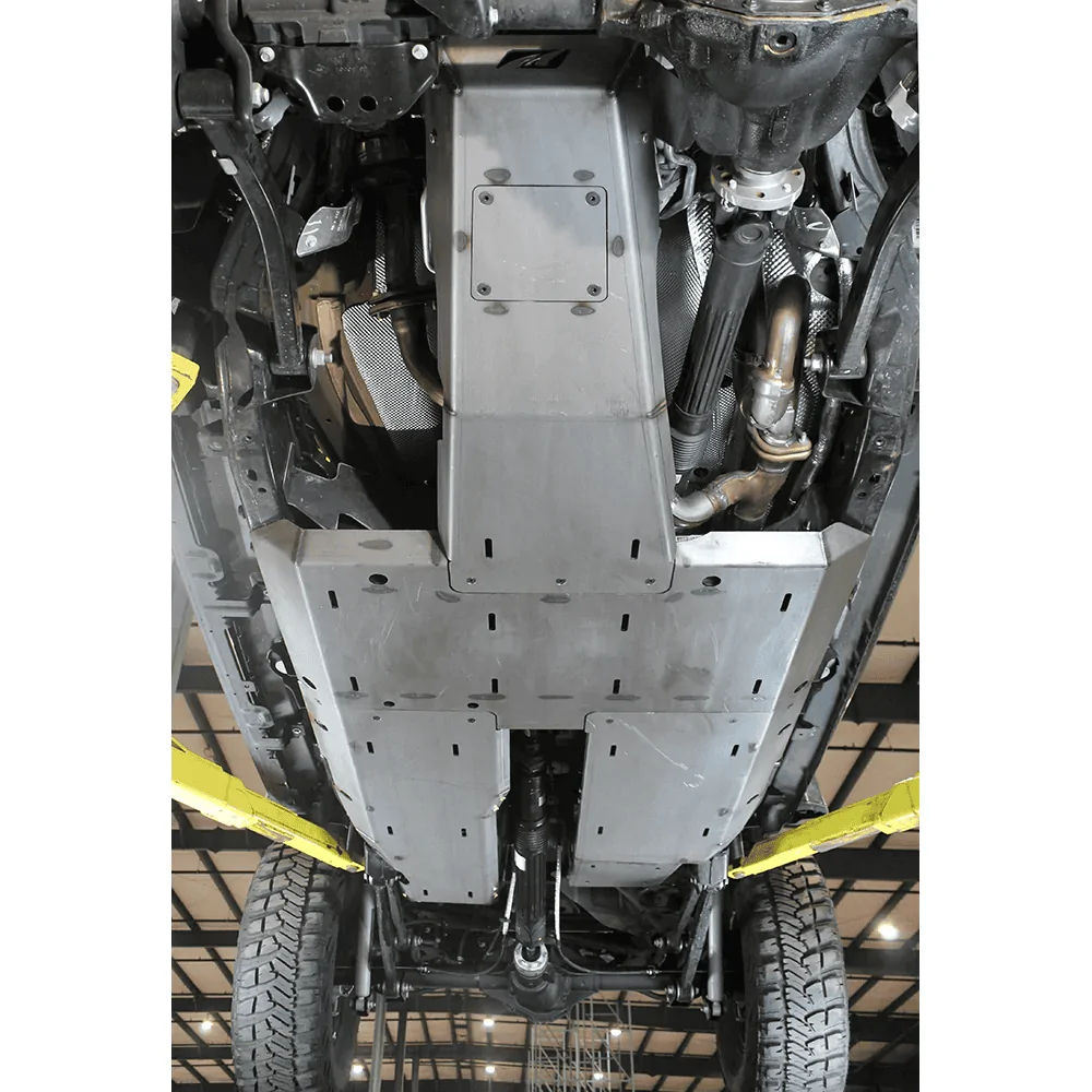

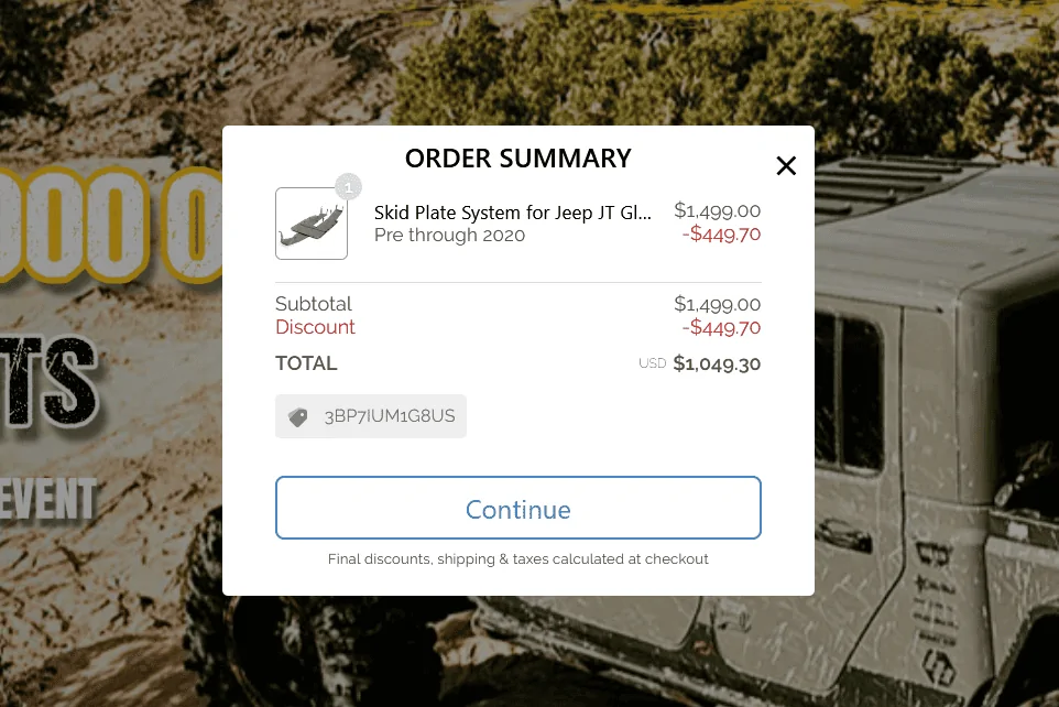

May I suggest an alternative? Motobuilt has a full skit system for $1050 right now on black Friday deals...
Jeep Gladiator Asfir vs Metalcloak 1669538971552
Their kit offers frame to frame coverage for the same price as Asfir. You are losing out on the diff covers though. And it will need to be painted/powder coated since it's raw, but you can pick the color powder coat, or even paint it yourself if you want. But after paint, it will be similar to the metalcloak system price, and will need touch ups when scratched.

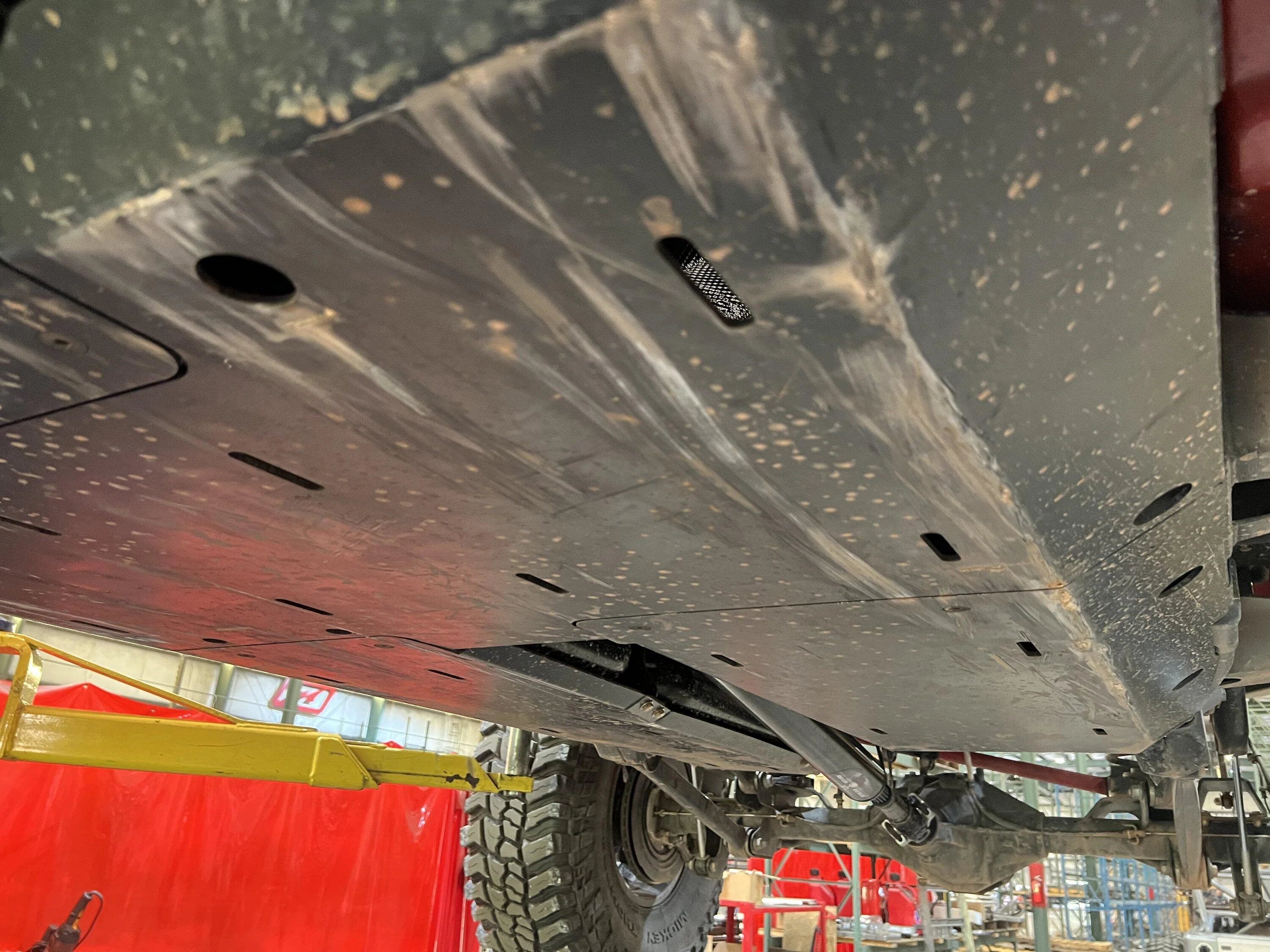

The cost is painful right now. Steel is heavy af but if you’re not rock crawling save some weight and go aluminum. I wish RCI would hurry up and make some for this truck. They make great skids. I’m going to tryand get some used ones on until next Fall’s sale at Motobilt?
These cover a ton of area.

No these are MotoBilt with black steel-it for paint
