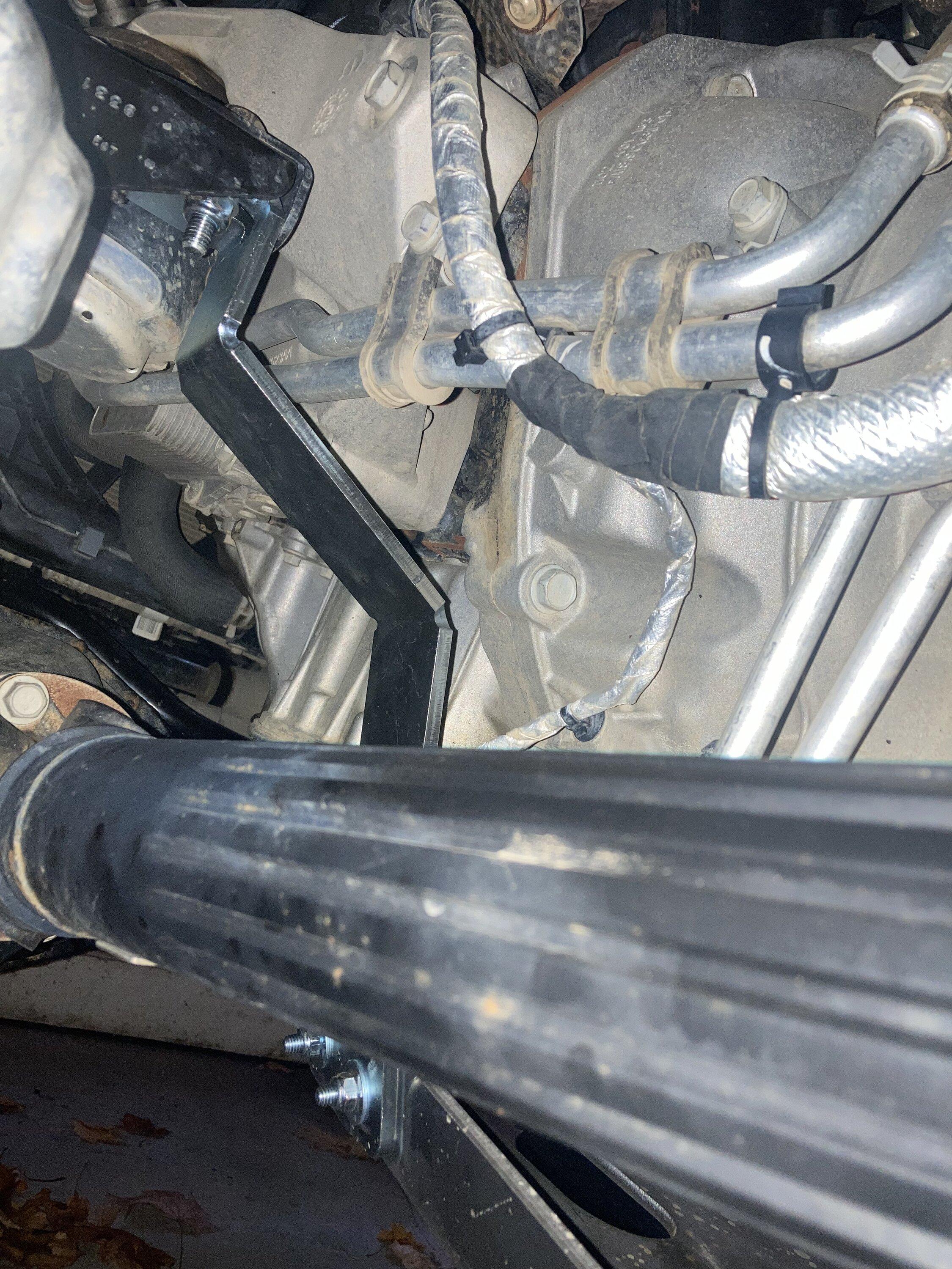

Not sure how but the front drive shaft is making contact with the front skid. Doesn’t make any sense because they are parallel with each other. Anyone else seen this with these skids?
I had that happen on mine, only it was more on that corner to the. Thought it was because of using it with my hemi swap. I just took a cut off wheel and cut that corner off at angle.

I have not had this happen on my diesel skid, but I'll watch out for this going forward. Did this happen to you folks while wheeling, under flex or with some impacts on the skids, or just kicking around town?
My main concern is that the support arms in the front are cut and bent, but don't have any bracing. Seems like under load they might flex or bend. These are significantly less expensive than some alternatives, so I understand there are some compromises, but smacking the driveshaft under routine use should not be one of them.
Did the engineers at @ASFIR 4x4 offer any thoughts.

OK. Two points make a line.

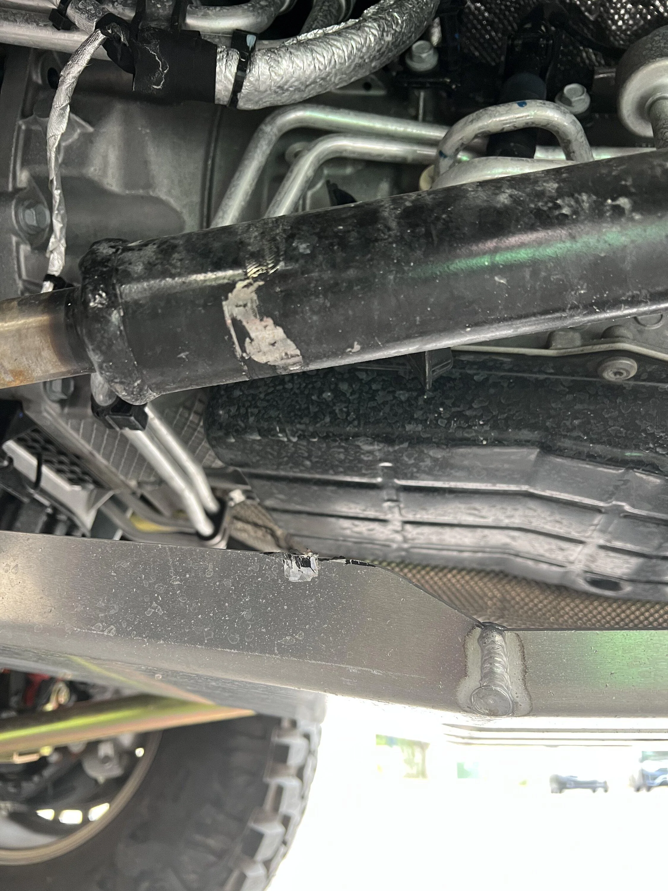

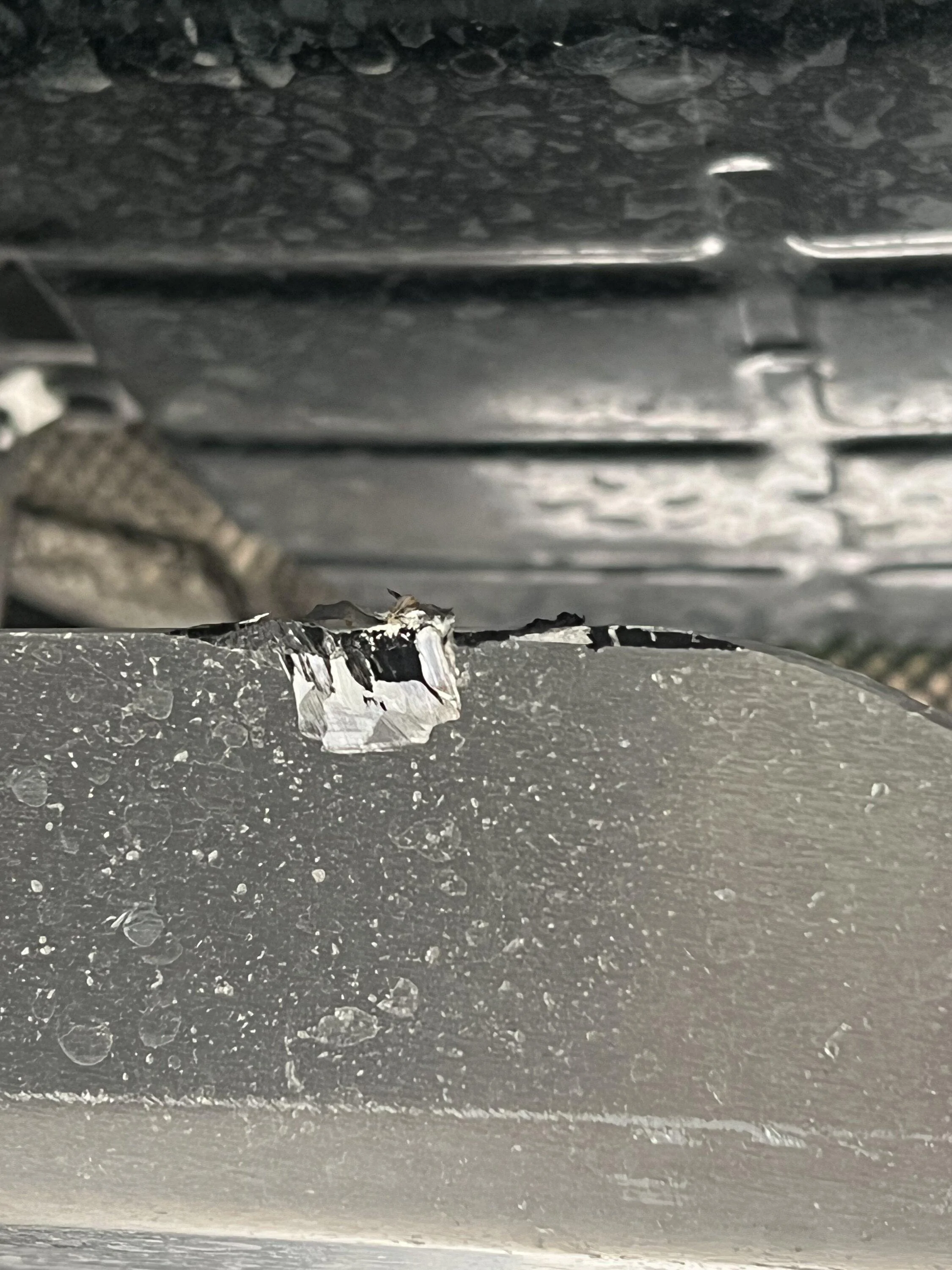

Mine happened after heavy flexing at Moab. I am guessing the axle shifted over enough to the passenger side to rub that corner. Wonder if amount of lift has something to do with it also. Taller lift increases angle of driveshaft which in turn increases contact with that corner when flexing and twisting. Here is approximately what I removed after seeing it.
Removed the edited phot with the actual modified picture.

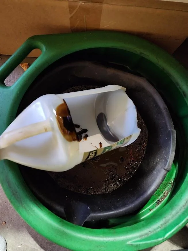

Also, has anyone figured out a way to change the oil without getting oil everywhere? The hole isn't big enough to get my hand or a big enough funnel in there and I am not gonna remove the thing every time. I am thinking of buying one of those bend/flexible ones that you can make all sorts of shapes out of, or possibly just install one of the drain plug valves so I use a tube to drain it.
Your suggestions would probably work. It is kind off a struggle to do with out a mess. Here is what I use. Kind of crude but I remove the lid to drain and then replace the lid to remove the bottle from between the engine and skid to reduce the mess.
This. Shifts due to track bar angle/swing.
This.

As you flex- the axle will walk driver or passenger side… Maybe just flap disk down that small area on the skid?
JK’s it’s the rear drive shaft on the fuel tank skid…. Once you start being able to lift the rear tires 38” up on the passenger corner it will rub…. ??‍♂
