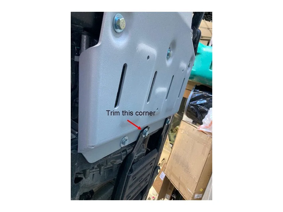

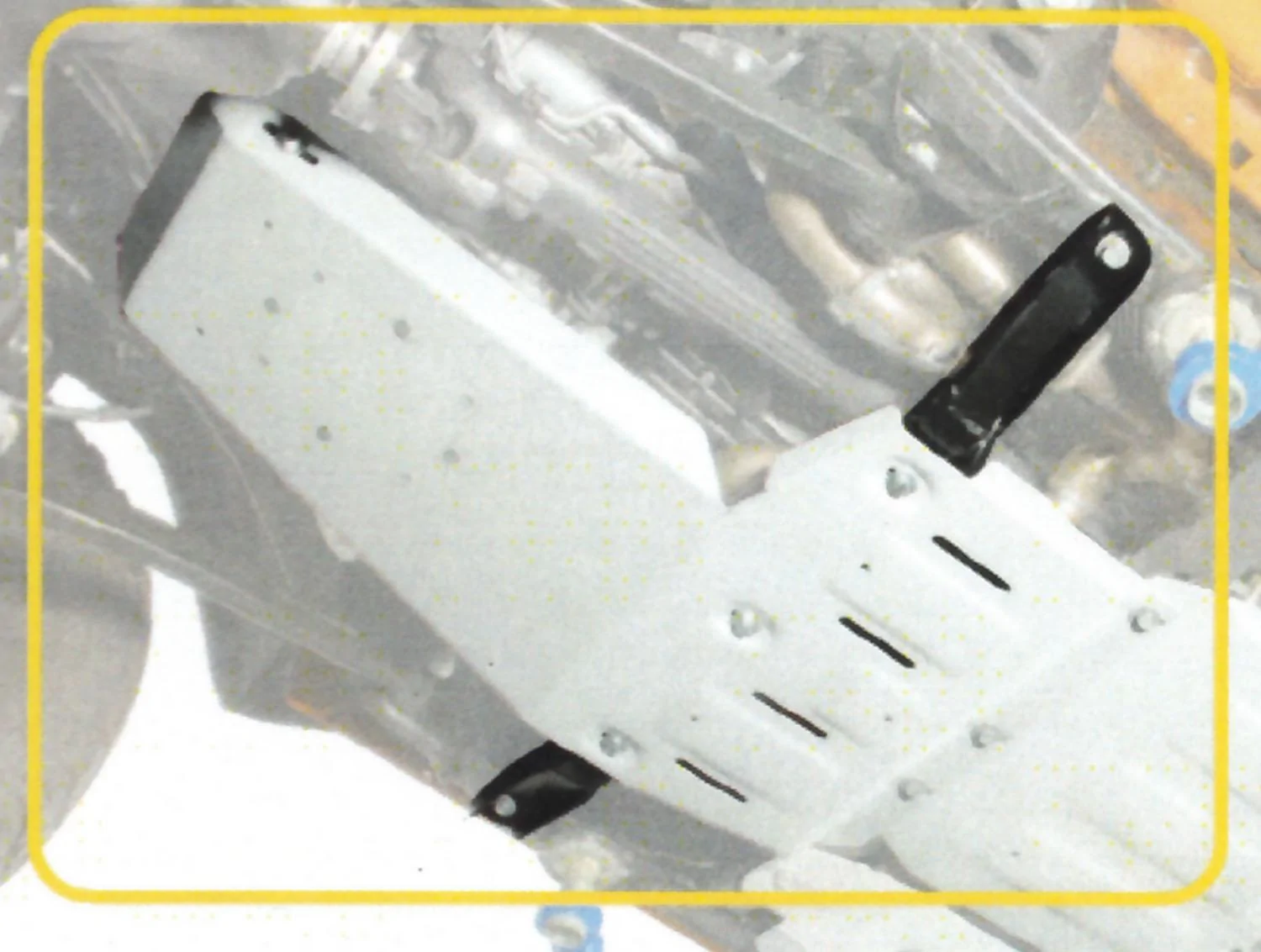

Today I installed Quadratec's powder coated aluminum engine/transmission skid plate. It is an extremely well engineered skid plate that's easy to install and uses existing attachment points (see images). Included hardware is high quality. On Quadratec's web site they state in response to a query about using the OEM transfer case plate: "that [you] may notice a little less ground clearance, and engineers have designed it to be used without." This is not completely true. While it is true that you have to install the OEM plate over the Quadratec's plate, their plate is just 1/4" thick (see image). You do have to trim one of the OEM brackets, but that's all. Their transfer case skid plate costs $300.

This is an excellent skid plate to protect the crankcase and transmission (MT or AT). It, however, won't fit diesels according to their website.
And the exhaust crossover. This particular plate has that improved cross member as well. The only problem I have with it is that you then lose the exhaust loop skid plate, but the new cross beam may help shield the loop some.
It covers the crossover if I understand what you’re saying and I kept the transfer case plate.
Someone else on here installed the entire modular system and didn’t keep the OEM trans case plate.

I agree completely. It will mainly be felt in breakover angle. We'll see. I have some 3-4' steps and waterfalls about 1/2 hour away I'll take my JTR to and see. I run that trail to test out new mods periodically and know it by heart, so it would be a good test. More on that when I finally get out there. Having said that, I do feel more comfortable that the oil pan and trans are safer now. I re-mounted the transfer case OEM pan. We'll see over time if the couple inches is a hindrance.

It has to go that low in order to clear the low-hanging exhaust crossover pipe. Which, with the manual transmission at least, could have been at least an inch higher.
I think that's an adequate compromise to protect that part of the exhaust system.
