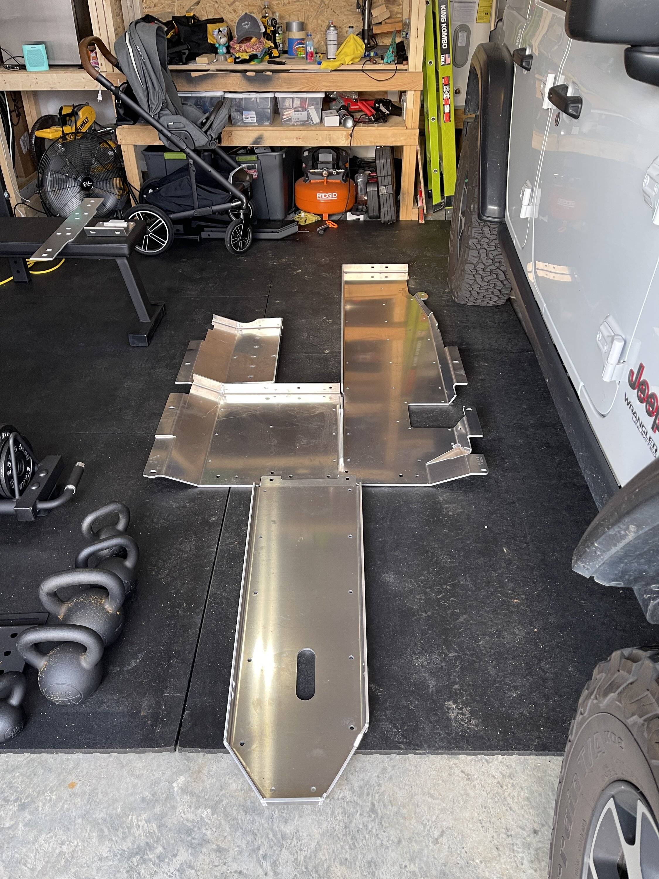

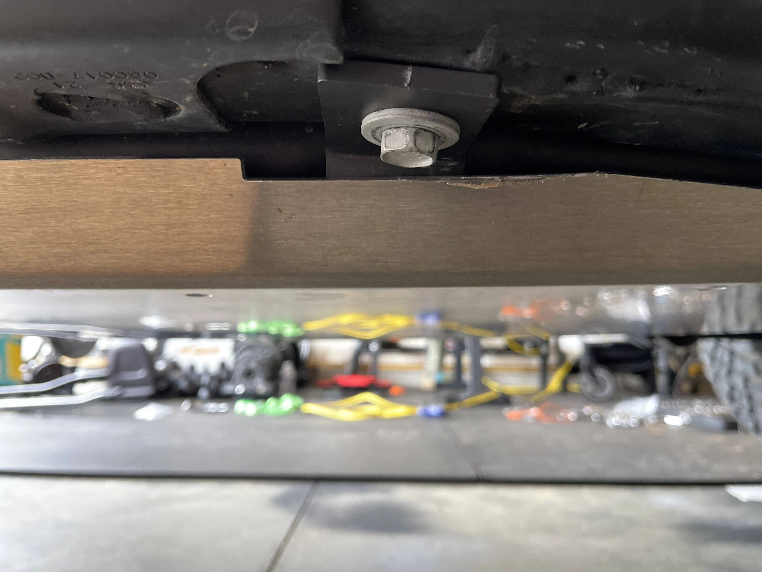

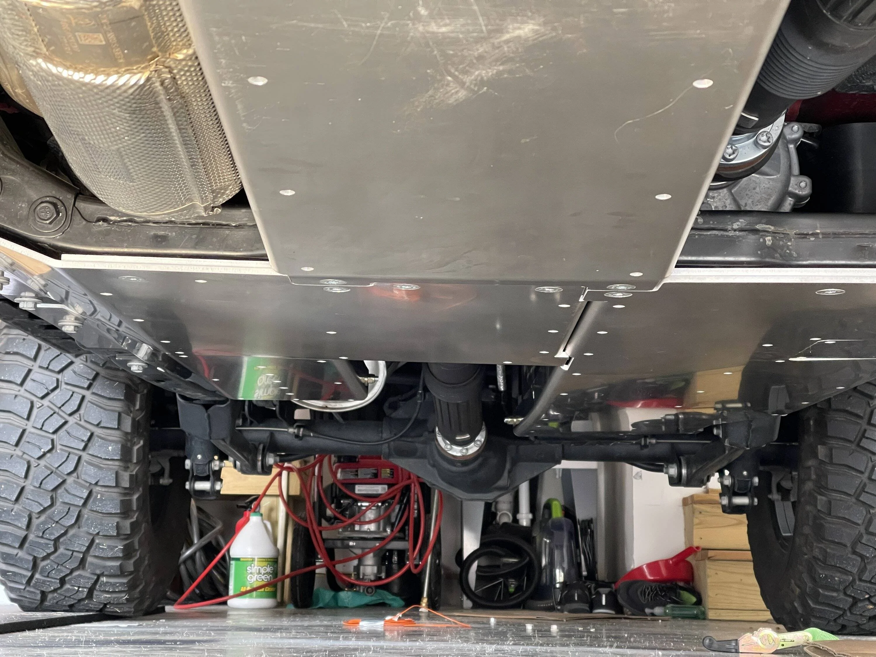

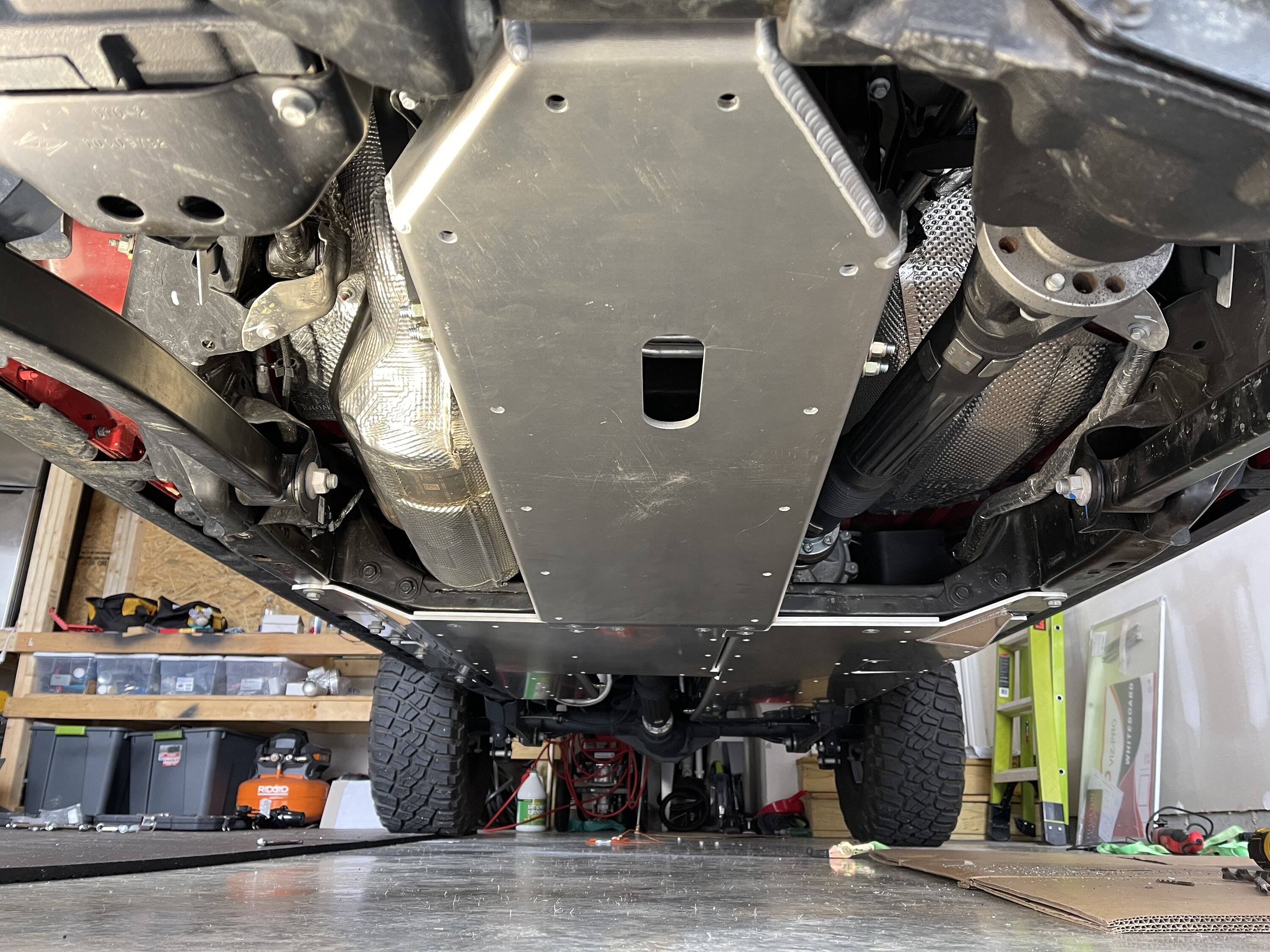

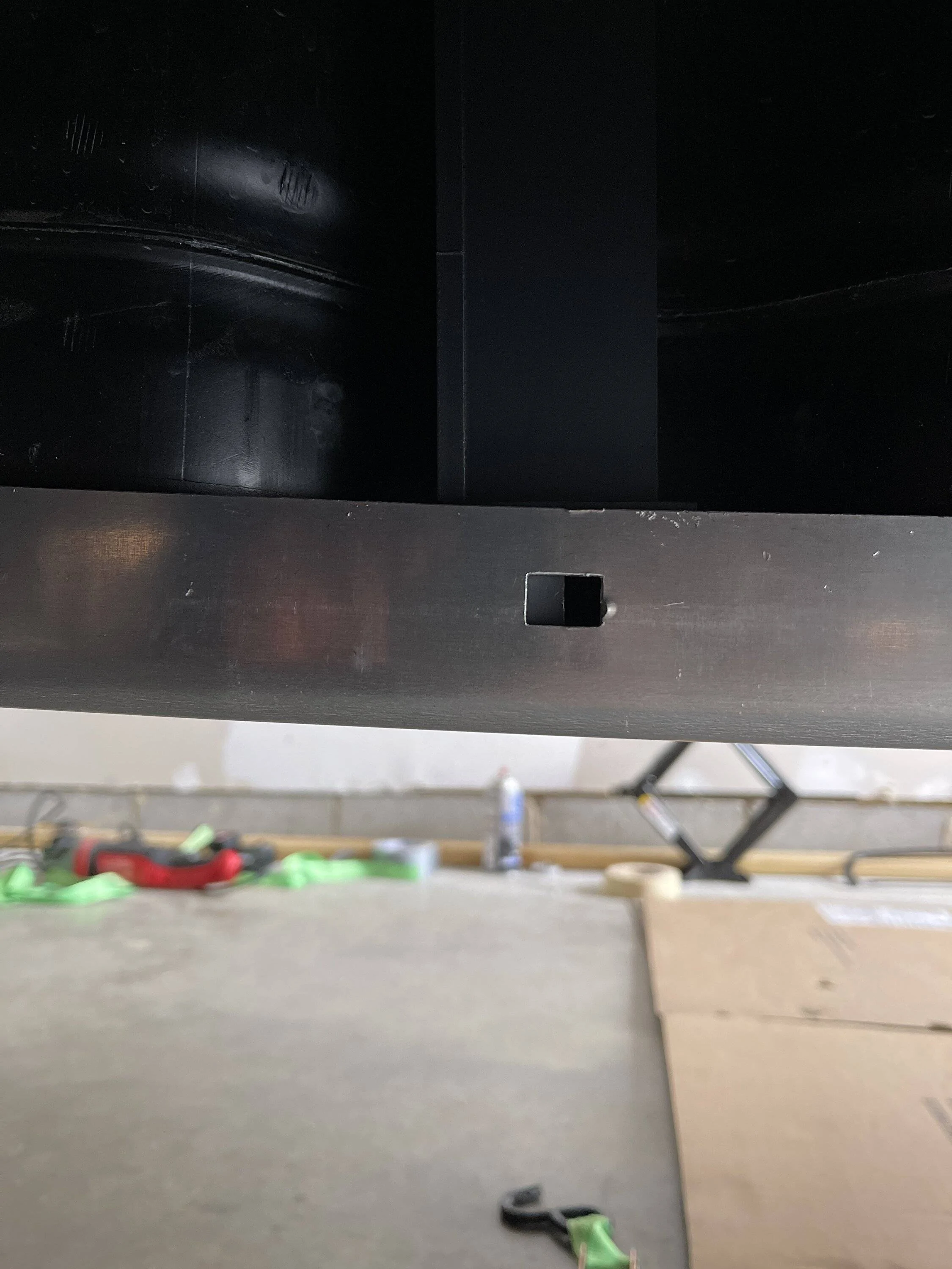

Next venture skids installed.
Overall I’m impressed. I only had to do some minor trimming on the tank skid to get everything to line up perfectly. The fit and finish is top notch.
Weed eater string worked great for feeding ratchet straps underneath the tank to hold it up during installation. Also heating up the factory bolts to loosen up the loctite made a world of difference getting some of the stock hardware off.
I can’t wait to get out and inevitability put them to use.

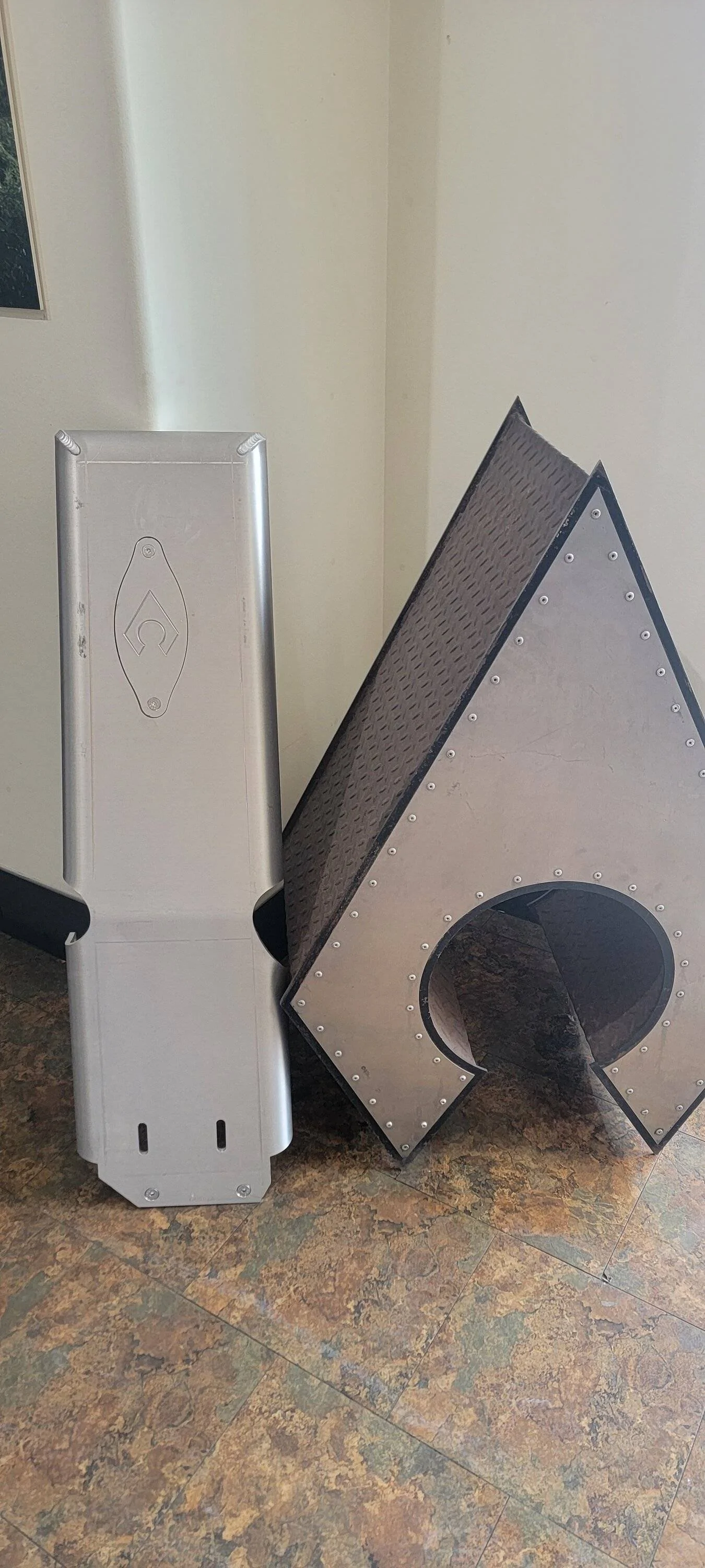

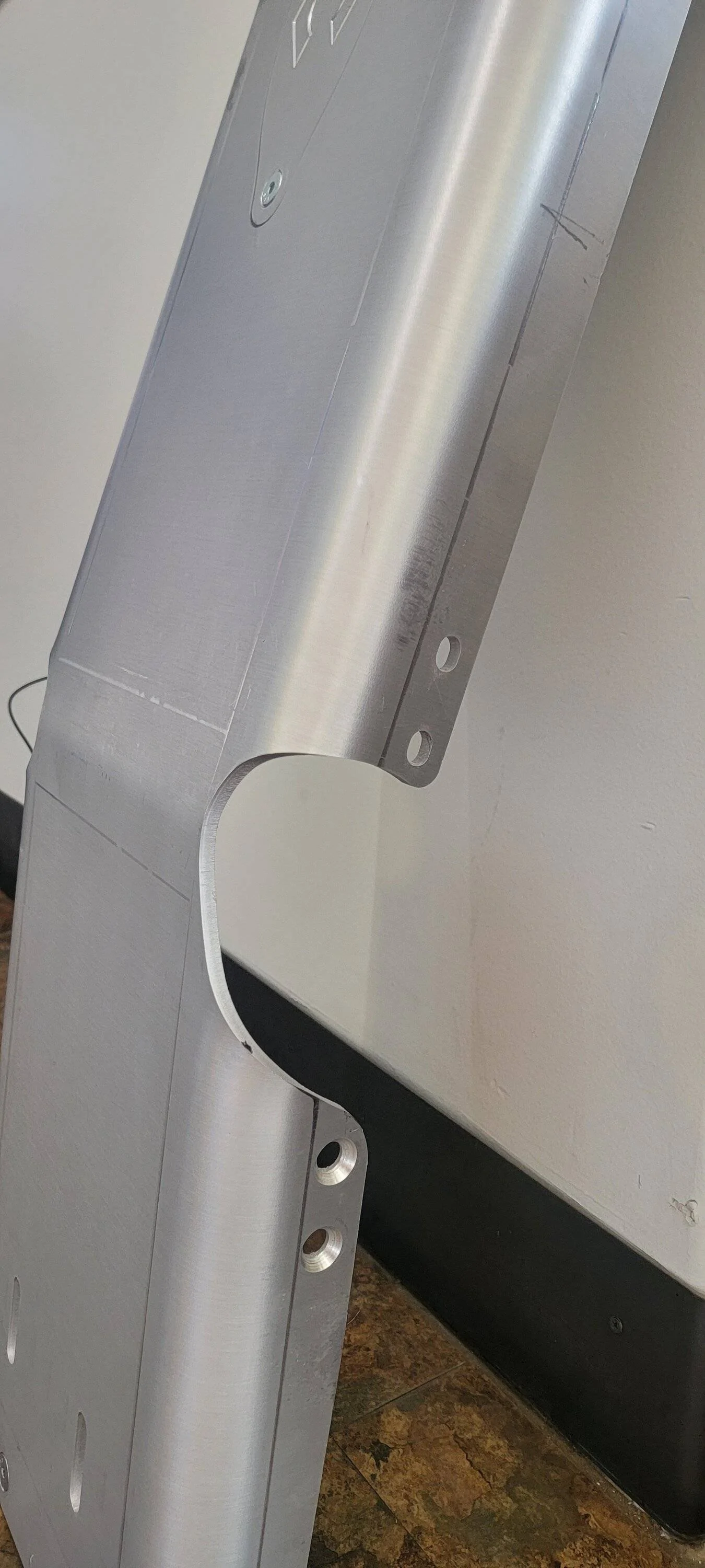

The new belly pans are in production and should start shipping out soon as brackets come back from zinc plating We did have one on display at Salt Lake offroad expo last weekend Here's a pic of the oil skid off the display . When it was test fit on our JT I was able to fit my hand all the way around the crossover pipe.

That's great! I beat the heck out of my crossover pipe, and it still buzzes when it's really cold out. I'll be placing one of the first orders for this. Will it require replacing the front brackets too @Artec ?
