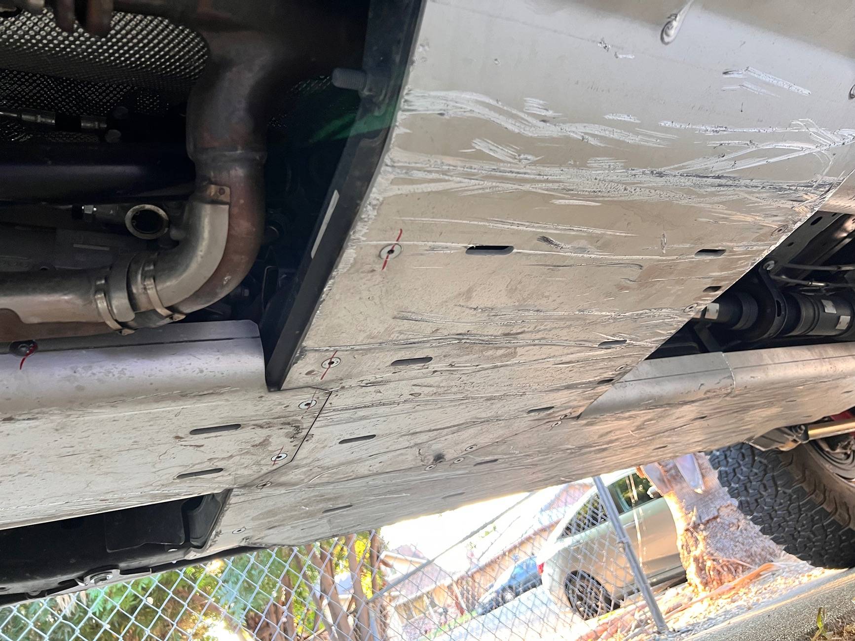

Definitely got a good curve going in my Next Venture alu + UHMW diesel tank skid after getting very high-centered on the Back Way To Crown King. UHMW did its job though - where there used to be a hellacious deafening screech whenever the stock skids make contact, now it’s just silent. Winch out of the stuck was way easier than usual.

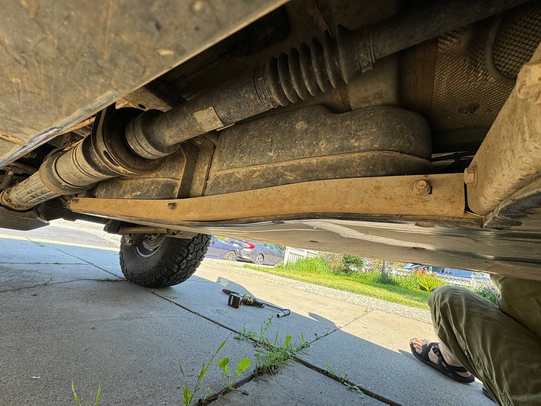

Quadratec aluminum engine and transfer case skids w/ steel braces, stock height. Brushed against the ground while going down some general two-track. That's the ground clearance thing there. Otherwise haven't gone offroad enough to test it. In general I like having the steel cross braces, stronger than the originals.
The braces are rusting though. I have a new rule that anything I add to the truck gets an extra coat of paint first. Aftermarket powder coat doesn't seem to last well.
I added anti-seize to the bolts. Nothing has backed out yet that I know of. I replaced the oil access port bolts with flat head allen bolts. They stay put, and come out easily every time. The large access port makes it trivial to change the oil. No spill to speak of. But the large port may not be as strong as the rest of the plate.

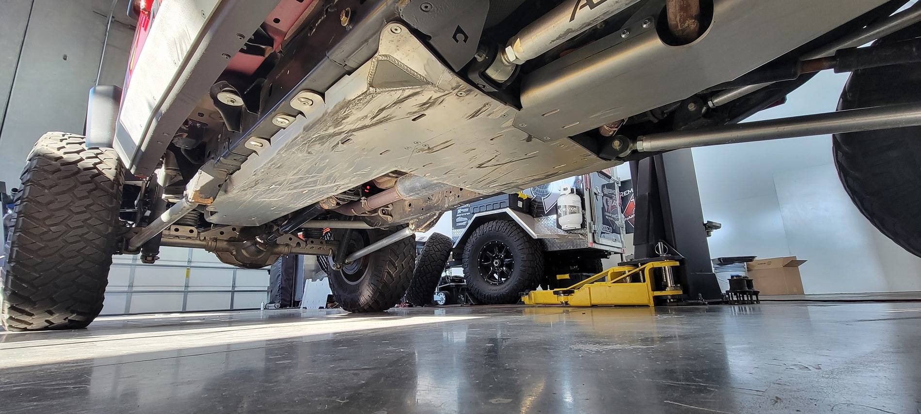

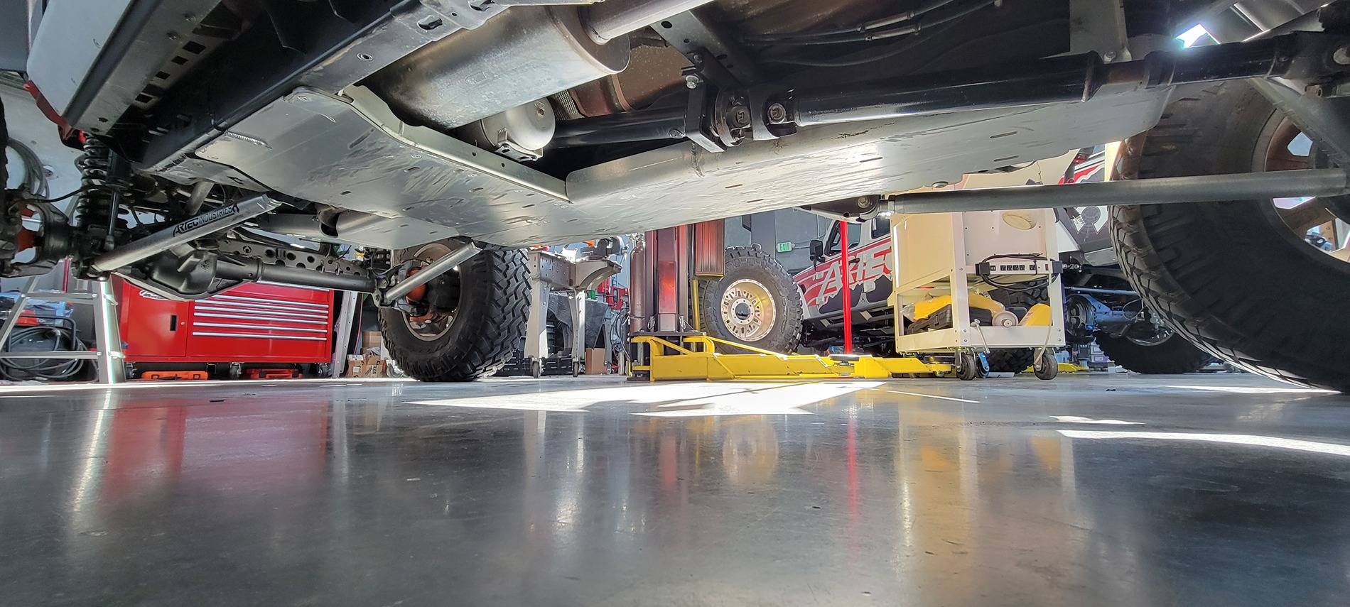

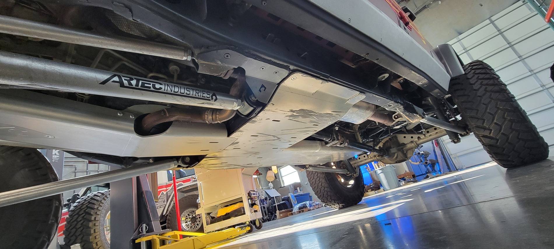

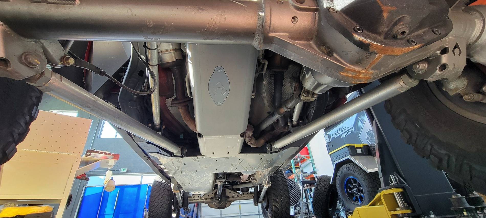

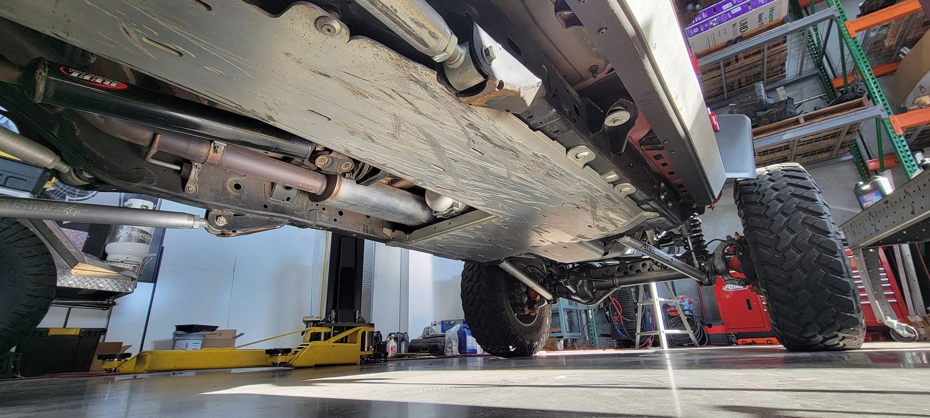

Here is one of the Artec Alpha series belly pans on our Red JT running out Soon to be released Triangulated longarm rear suspension on a SD60 and Sterling 10.5 on 42's she's a heavy rig but the skids are holding up great to mainly 7 and 8 rated trails they just glide right along the rocks !
Jeep Gladiator Full belly aluminum skid plate comparison 20240710_090137
Jeep Gladiator Full belly aluminum skid plate comparison 20240710_090150
Jeep Gladiator Full belly aluminum skid plate comparison 20240710_090201
Jeep Gladiator Full belly aluminum skid plate comparison 20240710_090210
Jeep Gladiator Full belly aluminum skid plate comparison 20240710_090221

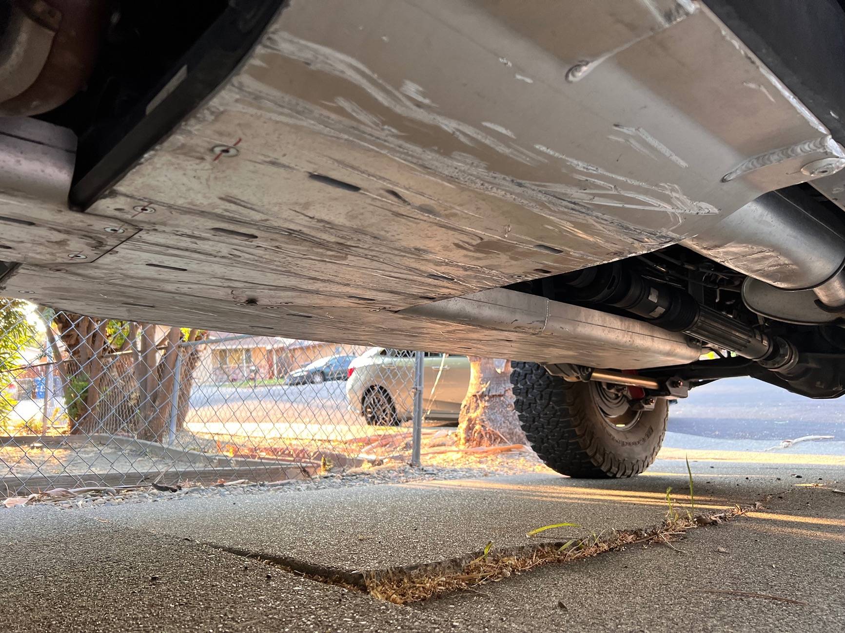

Does anybody have any updates on their AL skid plates?
Ideally after taking it rock crawling and having to slide the belly somewhat over rocks and other obstacles

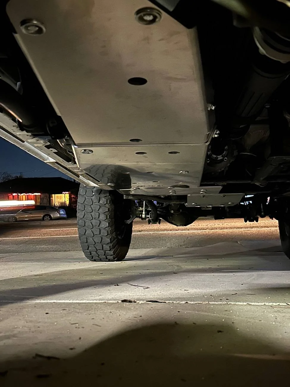

I will vouch for the Artec skids just went through the Rubicon during the Jeepers Jamboree no damage and only a bolt got loose. Probably some of the best money I spent on my Gladiator and would do it again.
Jeep Gladiator Full belly aluminum skid plate comparison IMG_6810
Jeep Gladiator Full belly aluminum skid plate comparison IMG_6809
