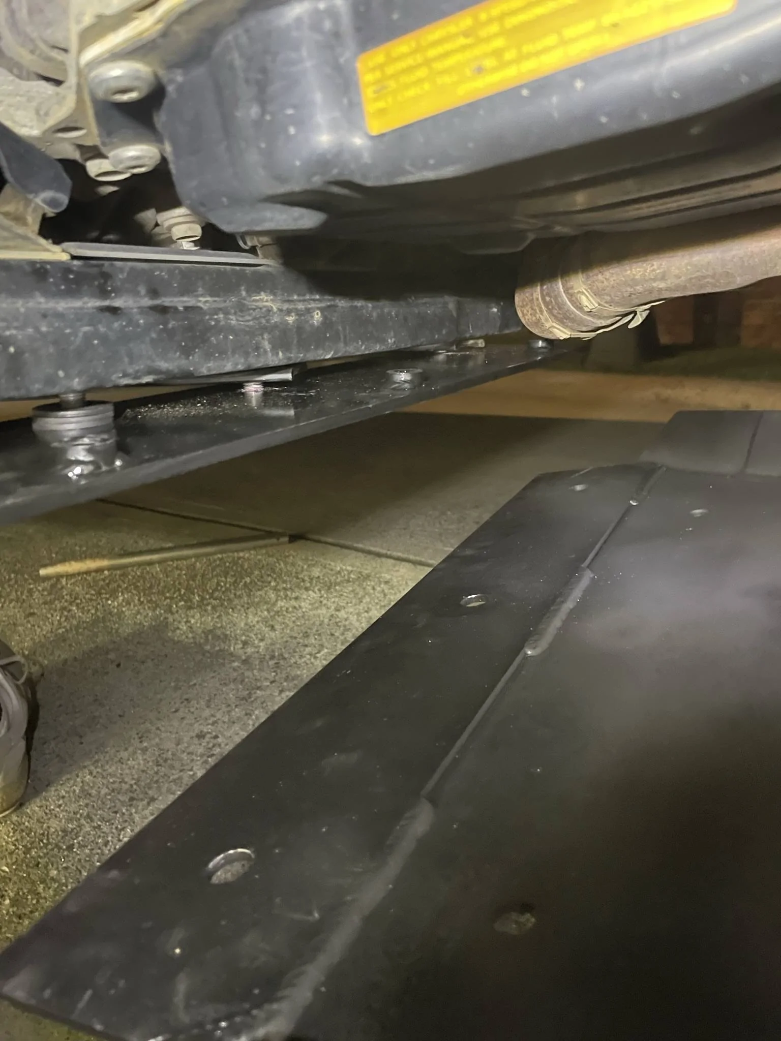

Jeep Gladiator Hauk Engine Skid Plate? 3AE06865-93BD-4447-9A49-FA22C881BF56
Attaching it to the crossmember piece they gave me. The bolt holes on the skid don’t match to the bracket. The holes don’t line up. We tried to put it on every way we could think of. Here we are just seeing if it fits before tightening it down at the engine. I know the skid is supposed to lay on top of that bracket but it still doesn’t line up anywhere near close.

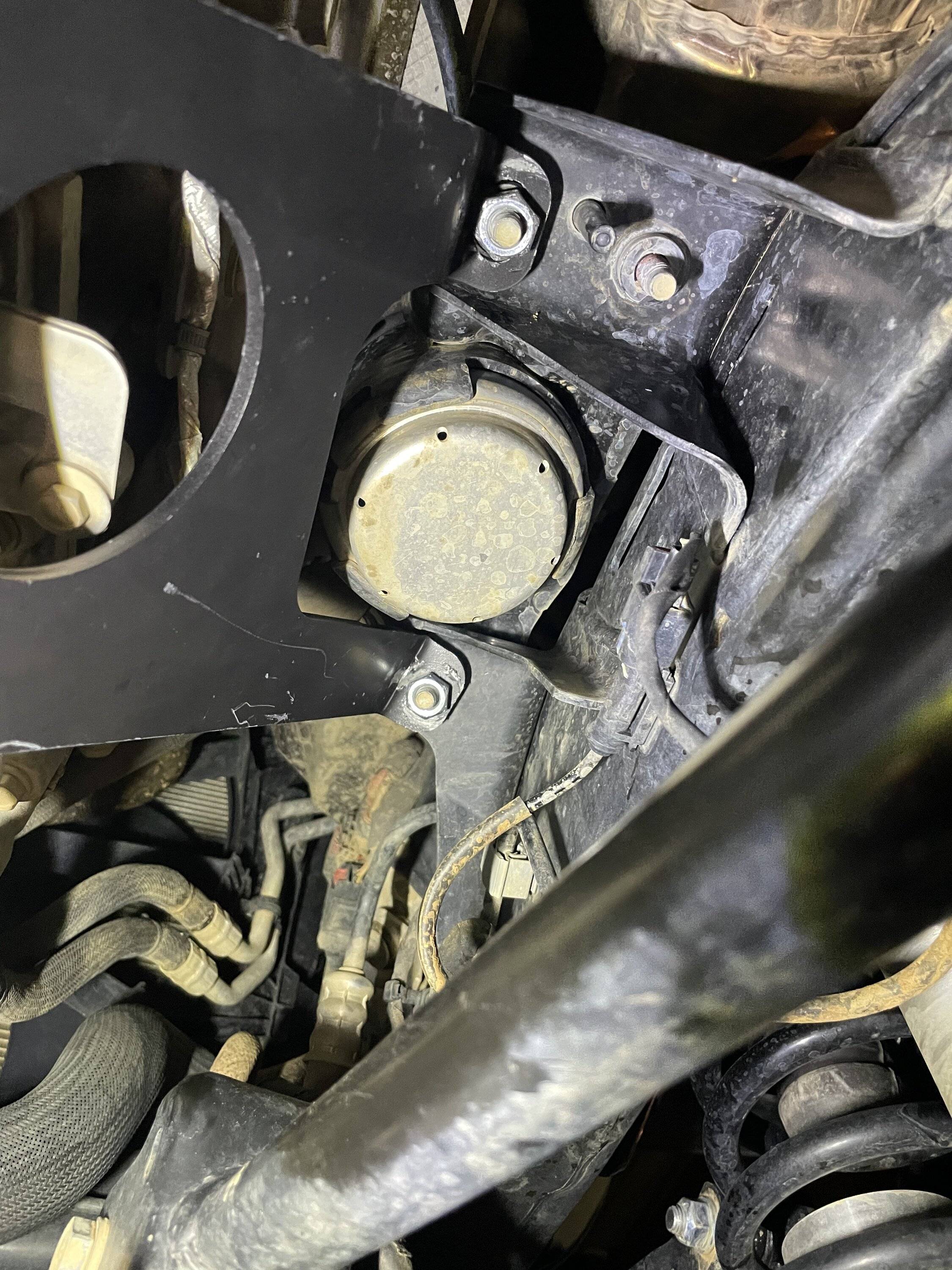

The “fins” that attach to the motor mount bolts were also touching the transmission cooler lines which was a big red flag for me.

Jeep Gladiator Hauk Engine Skid Plate? 27BA5374-75A7-4044-AC3F-6D1FD21A13B8
Jeep Gladiator Hauk Engine Skid Plate? AE9380C8-BC97-43BD-8579-700A822914F8
I could be doing this all wrong, but I wouldn’t know because it’s not very straightforward ?. Did lots of trial and error and just couldn’t figure anything out.
So the bracket/adapter plate is backwards in this picture. There are recesses in the adapter that will hide the bolts connecting it to the crossmember, then the bolts connecting it to the skid are exposed.
There also should have been a bunch of rounded head hex bolts in the hardware kit, you'll use them here.
I'll upload a picture of mine to another post in a moment.
