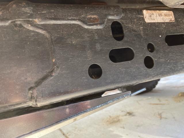

The gas tank skid comes in 2 pieces so I tried to install each piece separately and then bolt them together. That was a poor choice. I had to take the whole thing back off, put the gas tank skid together, then rehang it. That was 2.5-3 hours wasted. I never actually got the gas tank skid hung correctly. The front and rear bolts that go into the wholes from the old crossmembers didn't line up well. Here's how the front of mine looks. Big gap.

I swear the buttonhead bolts they sent to mount it to the frame were the wrong thread size and stripped the holes. I had to switch back to the stock bolts here. All the other bolts and brackets has it pretty well on though. Once I got it kinda on I moved onto the t-case skid.

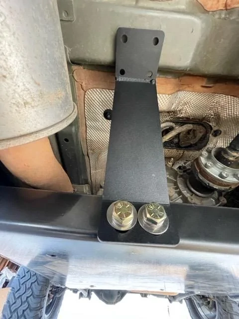

Again, shit instructions but this is WAY more straightforward. You need to open the engine skid box now. There is a large black metal plate with 4 threaded holes tapped in it. The engine skid slides in-between it and the t-case skid. I thought mine was missing because the instructions make you think it was supposed to be packed in with the t-case plate. There is a bracket that mounts to the back of the t-case skid that goes into the tub with self-tapping screws. Mine was comically bad and one of the things I wanted Hauk to send me a new one of. Its supposed to be inside the plate and I should have gotten all four screws into the body. Its still loose in the pic, so it doesn't hang that low but still I guess two screws'll do....
