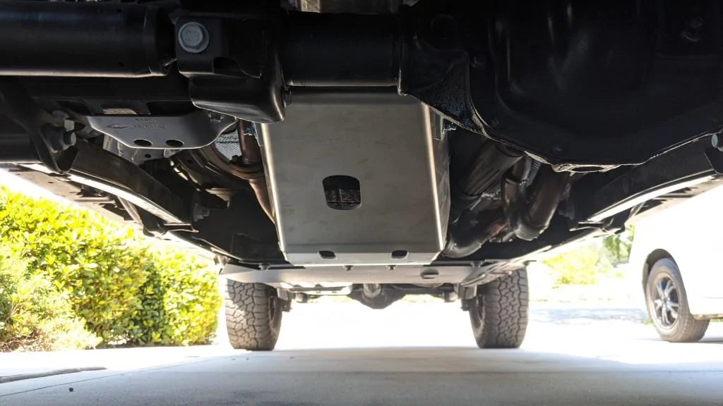

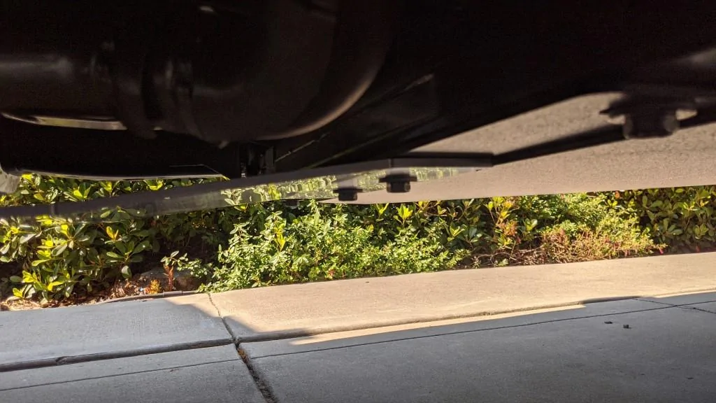

Undercarriage protection underway. I used Rubicon Express transfer case steel skid and Asfir 4x4 engine/transmission aluminum skid. Let me just say, what a difference between the 3/16" steel and 1/4" aluminum regarding weight. If Asfir made a transfer case skid that covered as much as the Rubicon Express, I would have gotten that.
I took the factory transmission bar out because I have seen how mangled they get. Not sure if I will need it or not. The Asfir instructions showed to reuse it. Maybe I'll fabricate something later. Might get Asfir gas tank skid next.
Rubicon Express skid from Northridge 4x4. Fast shipping. It was like 2-3 days. Box was beat up and the paint was chipped on the skid. Touched that up before installing. The Asfir part came in about 2 weeks. Comes from Israel.
Pictures, enjoy :)
Front view of Asfir engine/transmission skid
Jeep Gladiator Happy Labor day - Weekend project "Skid Plates" IMG_20200906_141501 (Custom)

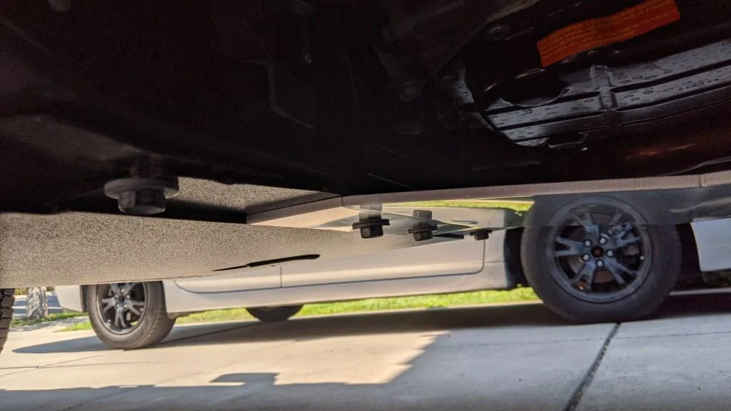

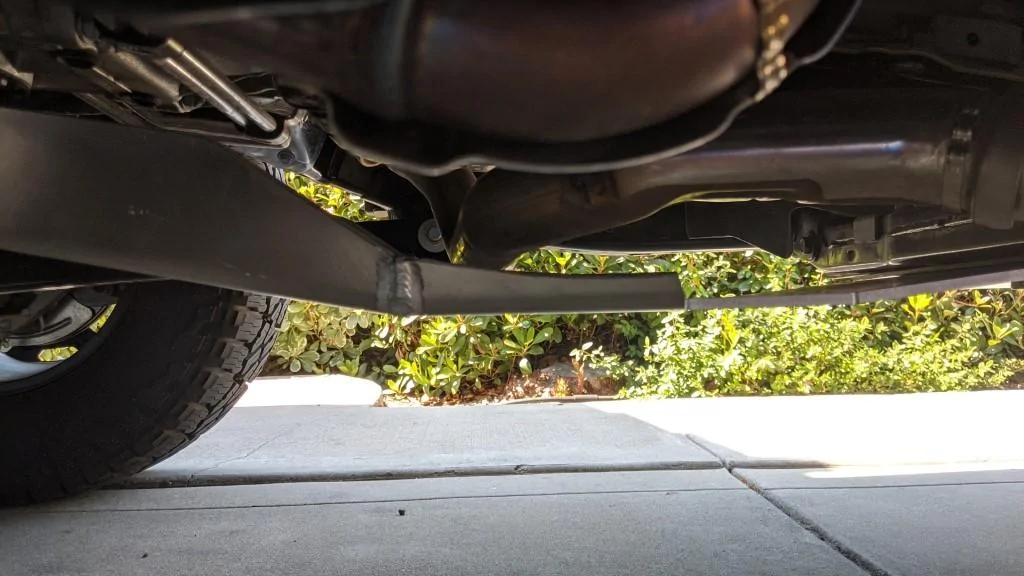

Trimmed about a 1/4" off both side just under the exhaust. I wanted to make sure I had wiggle room. Driver side.
Jeep Gladiator Happy Labor day - Weekend project "Skid Plates" IMG_20200906_141524 (Custom)
I really didn't have to trim passenger side, but I did anyways. Passenger side
Jeep Gladiator Happy Labor day - Weekend project "Skid Plates" IMG_20200906_141620 (Custom)

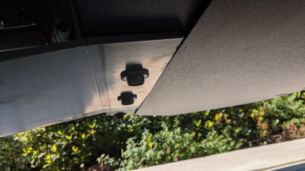

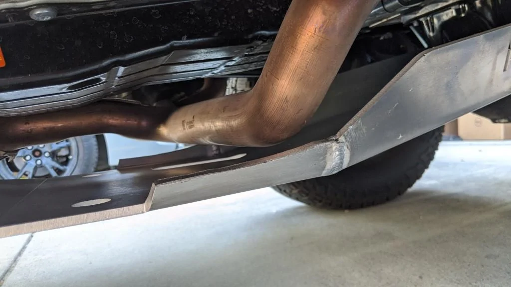

The Asfir skid was about 3/4" to 1" to long when trying to mate the two brands together. The Rubicon Express has a nice lip so there trans skid would mount flush. So I trimmed it. Nice flush mounted now.
Jeep Gladiator Happy Labor day - Weekend project "Skid Plates" IMG_20200906_141633 (Custom)
Better angle.
Jeep Gladiator Happy Labor day - Weekend project "Skid Plates" IMG_20200906_141544 (Custom)
Jeep Gladiator Happy Labor day - Weekend project "Skid Plates" IMG_20200906_141529 (Custom)

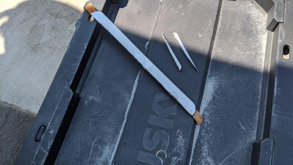

Scrap pieces
I just installed mine today and kept the cross bar. I might cut off the short piece that runs from the cross bar towards to rear of the truck So I can get the skid plate mounted up higher, 1/4” or so.
I read on the JL forum about someone’s experience with a different skid plate, where he landed on a boulder and the skid plate caved in and actually caused damage to the exhaust pipe where it crosses the skid plate. I know you created more room, but with no support in the center, that likely only makes the skid plate weaker and more prone to caving in, potentially biting into the exhaust pipe. I would recommend reinstalling the cross bar or fabricating something up now if you haven’t already. Just my two cents.
Rubiwoo
Rubiwoo
Michael
Jul 8, 2020
306
275
California
Self Employeed
I might have go revisit that. I noticed other skids don't utilize it.
