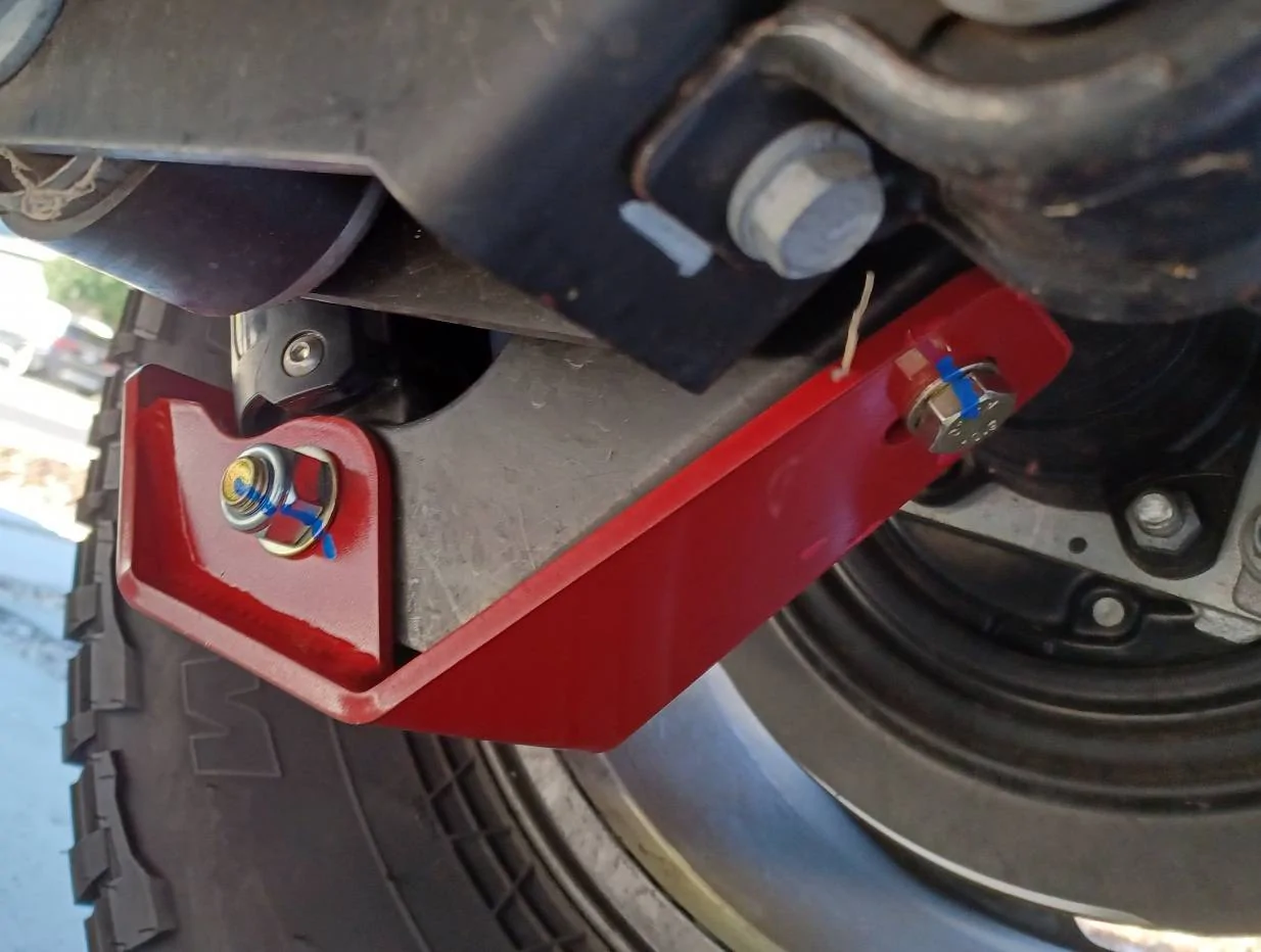

Did anyone get longer shock bolts? I am interested in getting these skids but would like the peace of mind that my bolts are secured. Where would one find these longer bolts?
This is one of the reasons I went with Rancho for the shock skids. I also prefered their use of a second bolt and of course the red powder coat

I installed the Rock Hard shock skid plates a couple days ago. I bought 9/16" by 3 1/2 inch grade 8 bolts, nuts and lock washers from True Value Hardware. I also use Loctite. I think it is worth the piece of mind to buy the longer bolts. My 2 cents!

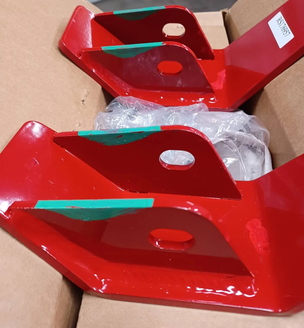

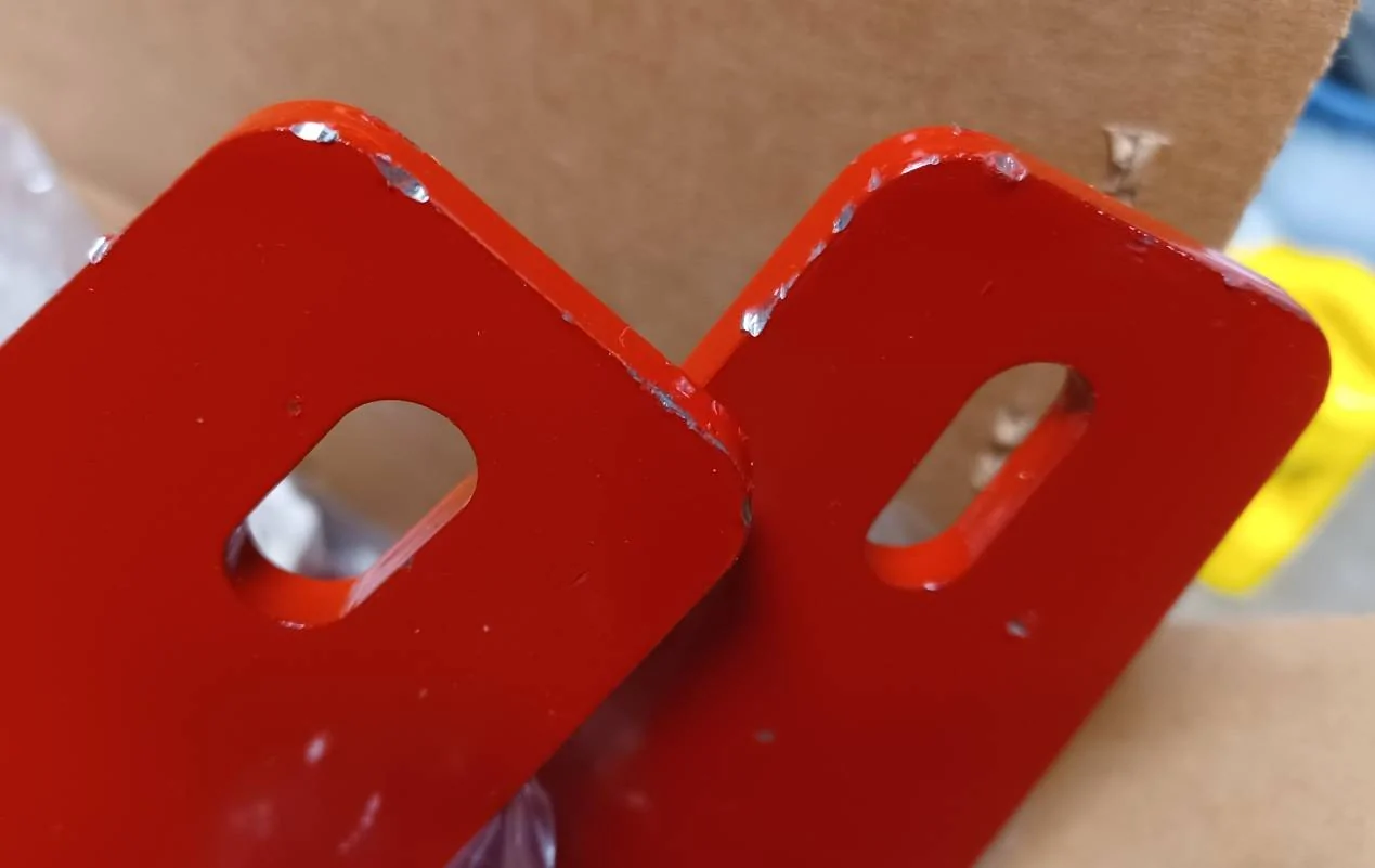

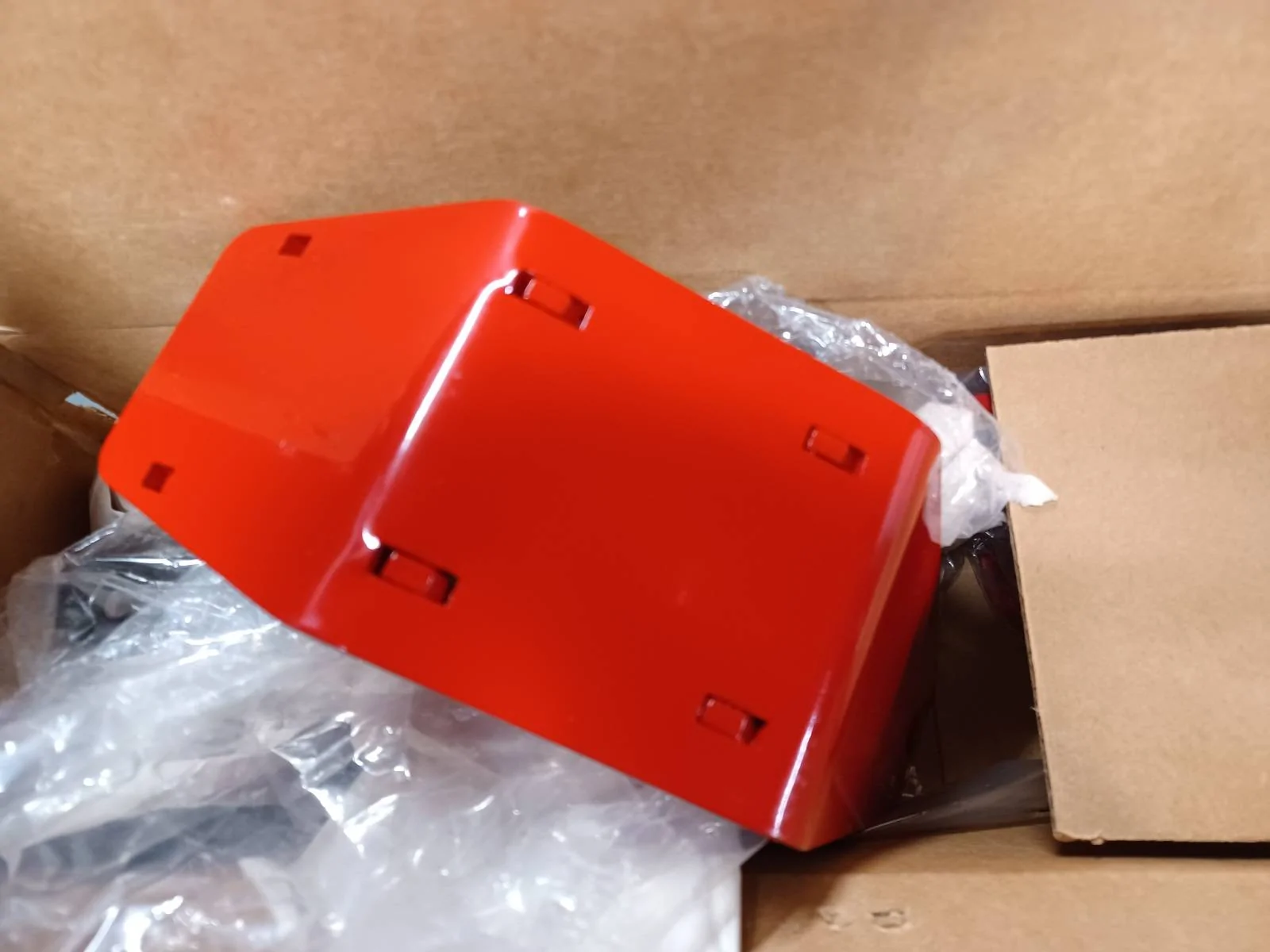

I bought the ranchos since they were on sale and I had some gift card to use up.
Poor packaging. Box arrived perfectly intact. Didn't stop the skids from banging and nicking each other.
Also, unlike the product photos, the keys aren't filled and polished.
I'd say you get what you pay for, but not always. Hahah.
Regardless, great customer support from Quadratec.

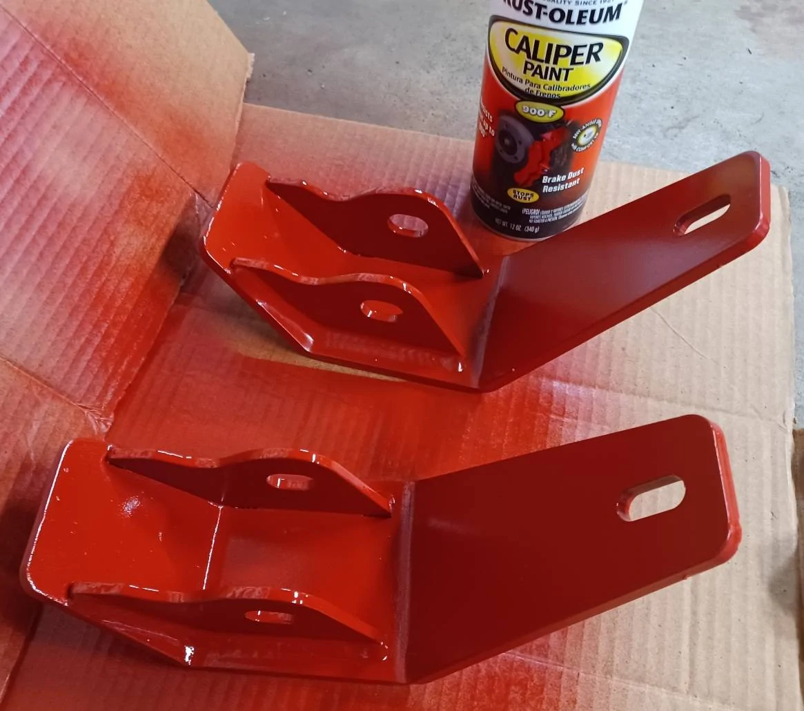

Already spent time cleaning up all the bad powder coating and damage.
Tired of companies wasting my time.
I'll probably hit it with my angle grinder when I have some free time. Don't feel like dealing with a return.

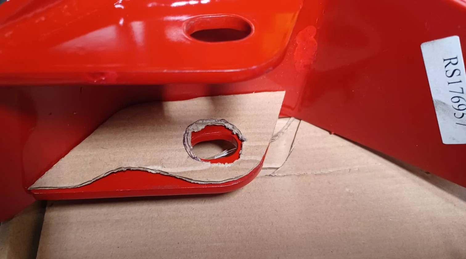

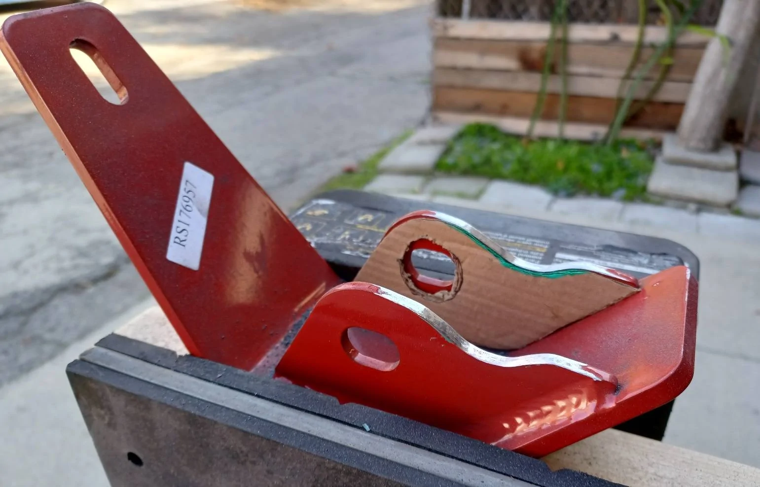

I made a template. Otherwise, I'd have to remove the shock bolt, fit, cut, fit, reinstall shock bolt, paint skid, remove shock and install skid.
Here's the minimum amount required to be removed to fit the rubi shock roost.

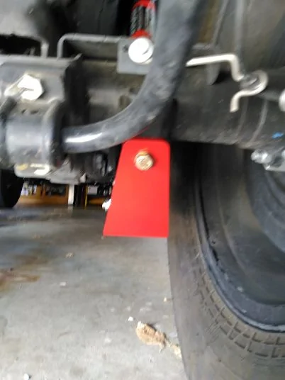

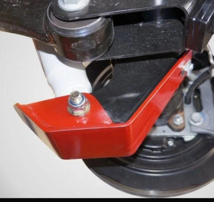

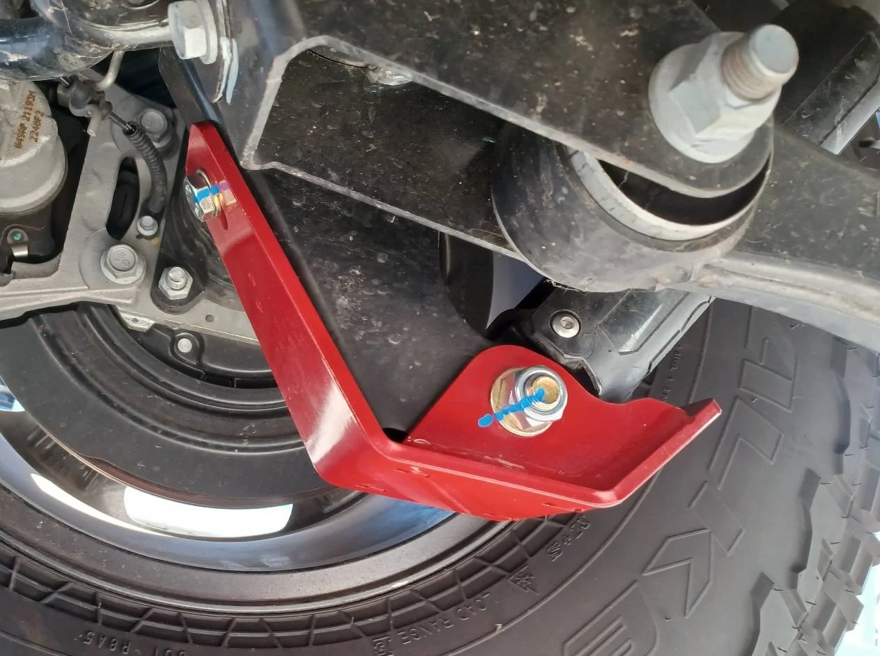

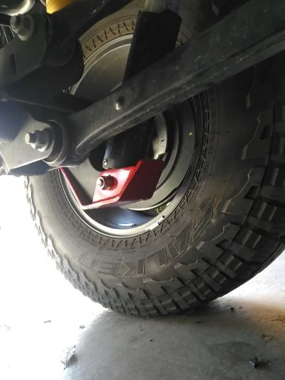

I used Rancho shock skids on me 2020 JTR and did not modify the skid. I did take a pair of side cutters and cut about 3/4 inch of the plastic shield on the shock, so the skid would fit, no need to remove the shock for this since it was such a small amount of plastic that had to be removed from the outside edge of the shield
Jeep Gladiator Shock Skid Plates 1-17-2021 shock skid
Jeep Gladiator Shock Skid Plates 1-17-2021 Rancho shock skid
