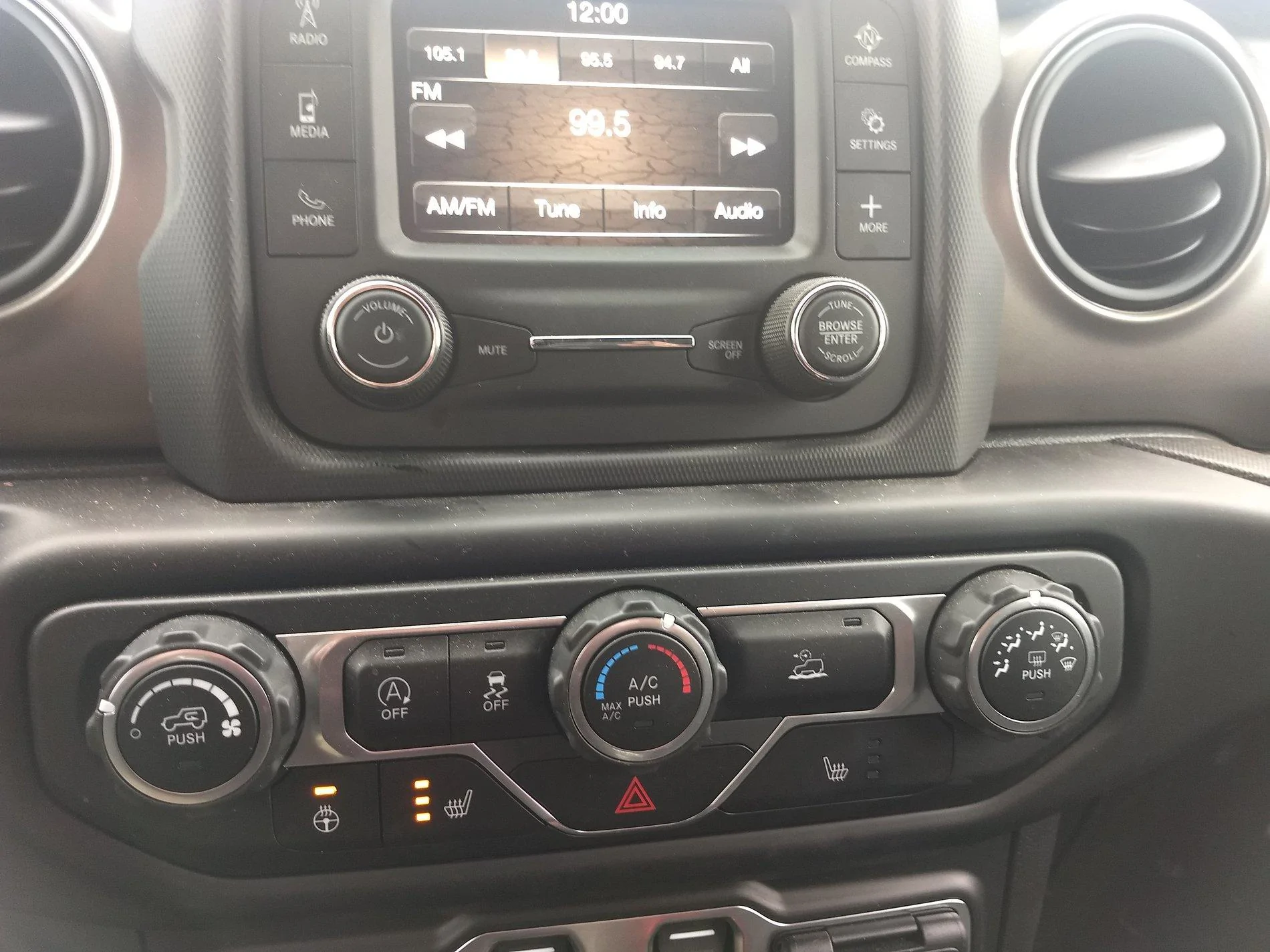

Auto climate doesn't seem to work

Update.... It does work. It just really takes a long time to come on. The engine temp can be up to normal for quite a while before it comes on. I can switch to manual and the air coming from the vents is warm. Then back to auto and it will come on soon after. I've had no issues with AC but It's not really been warm out since I bought it. Thanks for all the input.

Performance of the auto climate has been disappointing for heat. Haven't been through a summer in it yet. It is slow to come on and seems to dump mostly out the defrost vent. Every other auto climate system I've experienced increases fan speed as soon as the engine temp starts to warm, and directs air to warm your body and less so the windshield, but this doesn't. The other day temps were in the single digits and the fan finally kicked on a higher speed. I have resorted to using it like the manual system in my dear departed '03 TJ. Yes the AC comes on in auto mode, that is fine to lower humidity and help defog windows. At the first service I'm going to ask/complain about it, maybe its a programming issue.
