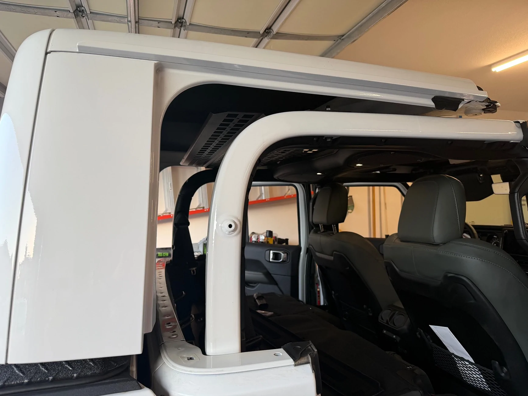

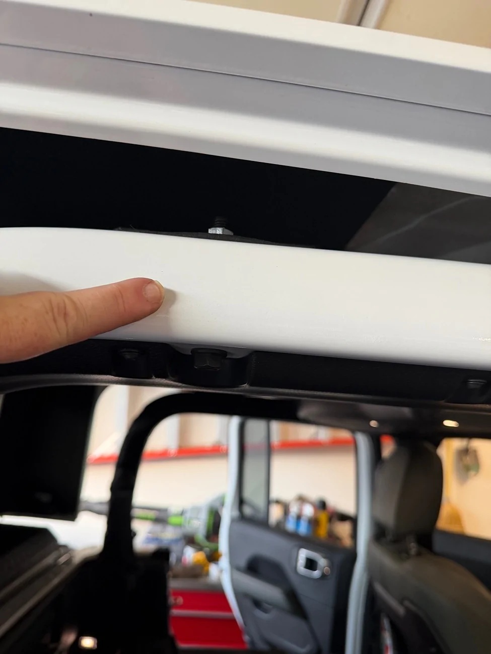

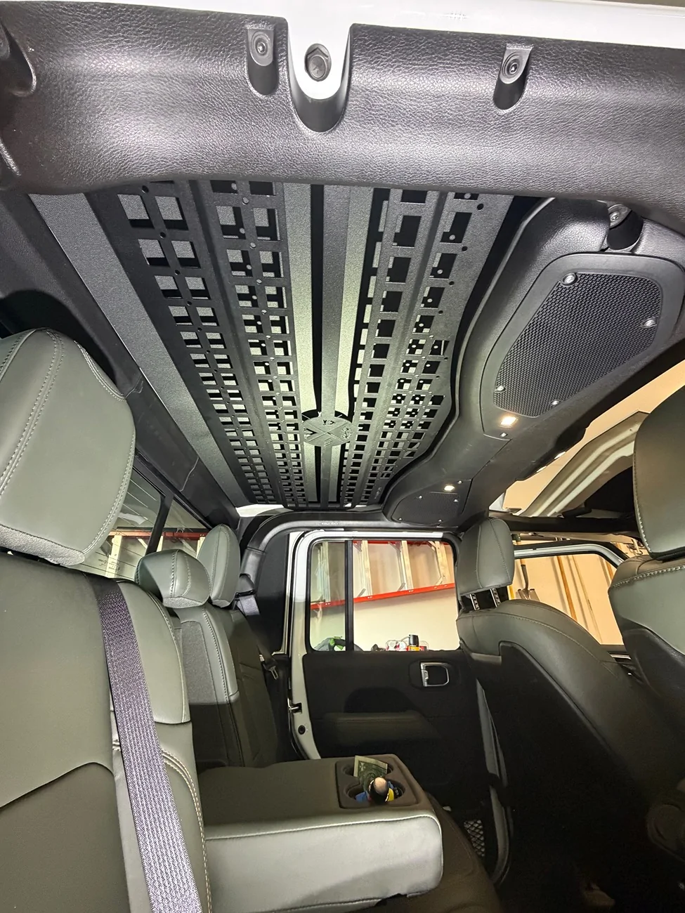

Installed the overhead molle panel from backseatdelete.com. Super-quick delivery from Mark. Ordered it Wednesday morning and it arrived Friday at noon in Colorado. Fit is perfect, quality is high, and install is super-simple. There is a shipping charge, but the packaging is definitely worth it. We only had to raise the rear top a few inches to slip it in. The panel has many molle provisions and also has a notched and gusseted clothes hanger rack built in. The notches will keep the clothes from sliding back and forth when going around corners. The retaining bolts fit through a factory hole in the roll bar, and there is enough clearance above to put the nut/exposed thread on the topside so that you have a cleaner look. The panel clears the side-curtain airbags in the event of an accident. Install time was about 20 mins.

I was surprised by the price at first, but it's worth it. It's a good heavy gauge steel, brake formed, the hanger rack is gusseted and notched, and powder coated. Mark is also very communicative and checked to make sure I received it and to make sure I was satisfied. I'll definitely be ordering from him again when I decide if I'm going to do the full seat delete or just the partial.
