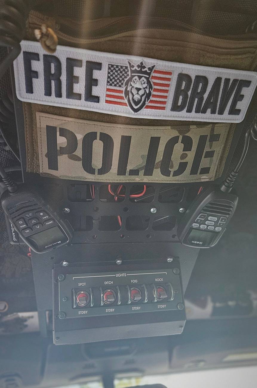

Finally got the panel in! I've been cooking up this overhead switch panel for months. Took forever to piece together the switch panel, the box it's mounted on and playing with space issues between the overhead rack and the radios. (CB and GMRS) Everything fits nicely. It took some creative placement and took a while to figure out how to power all the switches and the radios
Now, I just have to run the wiring down to a relay box under the hood or (maybe the driver's side cowl?)
run the power to the lights and then finally decide how to mount the ditch lights because I went and did the rugged ridge snorkel. I can only run the low profile version until I figure that part out.

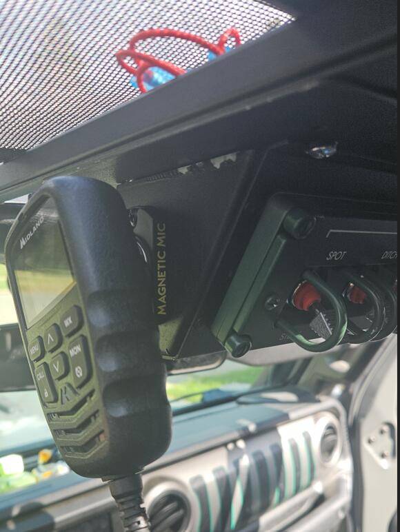

It's still an evolving project! I've added MagnetMic mic mounts on the sides of the box to hold the mics. I still want to clean up the wiring up top some more but I did get with S-Tech Switch Systems to get their relay box and wires so I could run a much thinner wire down the side of the windshield frame. It beats the homemade wiring rats nest I was coming up with. I still have to clean up the power wires and antenna coax on top of the molle panel. I haven't found a way to cover the top of the molle panel to my satisfaction quite yet, so the wiring is exposed to the elements when I have to freedom panels off. I'll post some more update photos so you can see it's current state.

The short answer: I wanted toggle switches and s-switch gave me the ability to do it.
Long answer:
Well, I knew from the start I wanted my own switches. I had an auxbeam panel before, and while it was effective, I'm more of a tactile person and wanted the positive feedback of the toggle switches. The push buttons are kinda boring. So, now with old school switches comes with the requirement for more, thicker wires. I knew I was going to get a little out of my depth and am not confident with wire sizes and power draw. In order to run the old style toggles, I needed to run bosch style relays. S-Switch was happy to give me a wiring/relay box setup that was correct for the lights I'm running and it came all prewired and protected. Wiring from switch to relays was as thin as possible and removed my anxiety over power draw.
