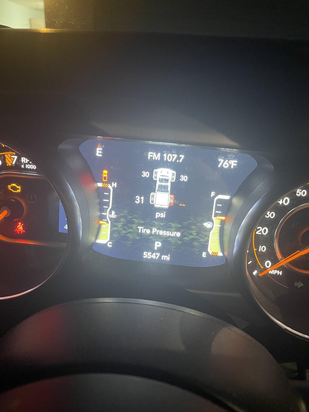

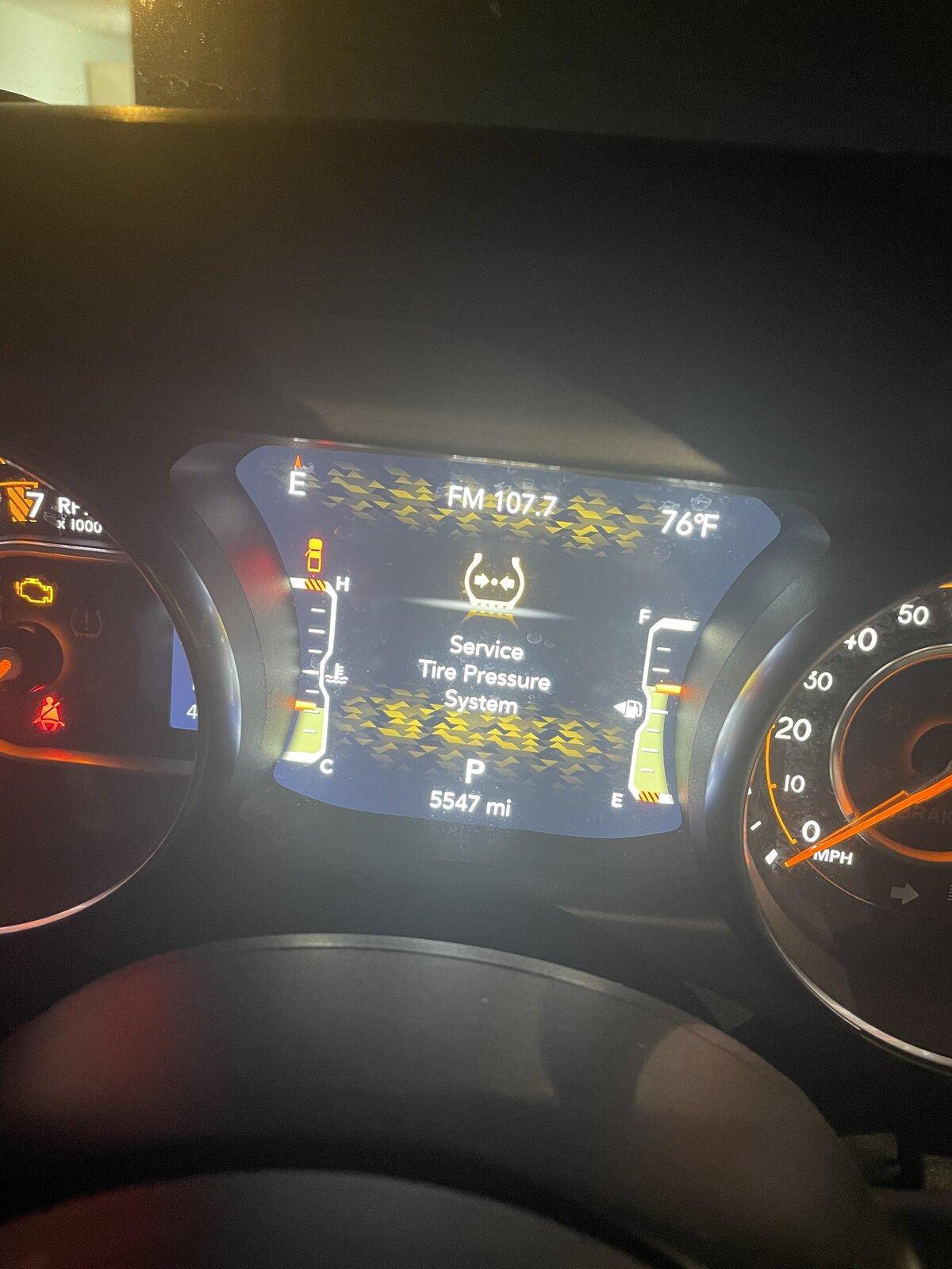

Does this mean I have a TPMS sensor gone bad? Or could it possibly be something else wrong?

I've never seen that before, but that would be my first guess. Curious to see what you find out. Hope it's a simple fix.

I would rotate the wheel that is not reading to the front and see if the problem stays with the wheel if so it is probably the wheel sensor, if not something with the JT system that reads the sensors.

Might want to try dropping the pressure down to around 20 psi or less and then back up.
I had a sensor on my JL act like it was dead and that got it reading again.

Well, after a week of not working the sensor started reading again in my way to work this morning

Ive got a weird issue with mine. All of mine display pressure, none are low, but I have my tire pressure light with the ! stays on. Even if I clear the light on the dash, it will come back.

I had that issue. Dealer was getting ready to replace a sensor when the "master mechanic" did a "Chrysler" reboot. Service guy said they let the air out of all the tires, did the reboot and filled tires back up. Everything working. So software problem.
