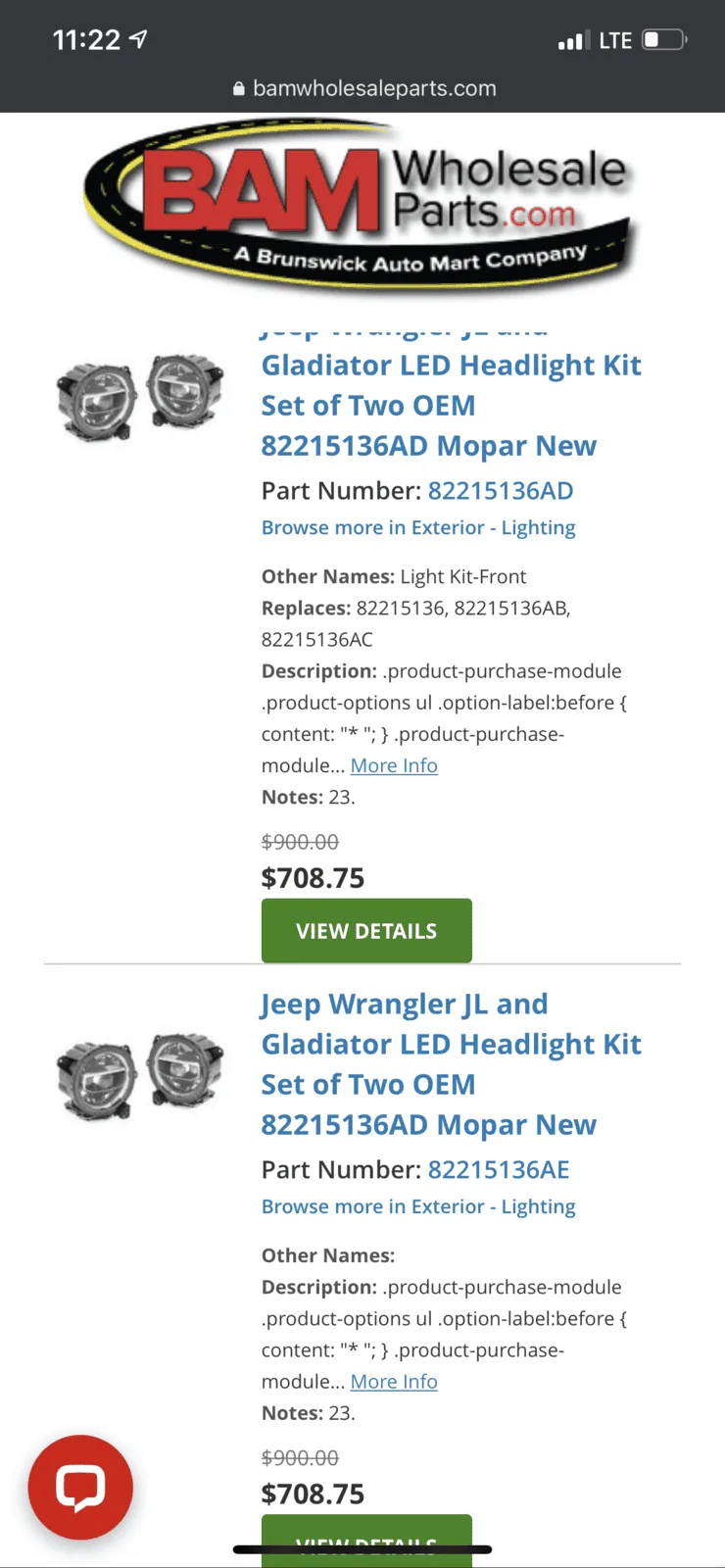

I am looking to buy a set of mopar OEM led headlights for my gladiator. I was shopping around and found the best price at Bam wholesale parts, but it looks like there are two different model options, does anyone know the difference ????

When the last digit changes, D to E,in this case, it indicates an updated part. Could be a different supplier, could be an improved part.
Jeep Gladiator Bam wholesale parts, OEM headlights which is which ? 54DA37A4-32E5-4A57-B7B9-145CA6E3E2A5
Are these just a direct replacement for halogens? No other hardware required?

The AD part has been superseded and is no longer available. This is likely just their system being updated and the old record not being deleted. I ordered the AD part number (edit: from BAM wholesale) when I did my swap and they delivered the AE package.
This is how FCA has always tracked part numbers because the core number is associated with the component and the two letters are a cleaner way to track revisions - every version of that part number is completely interchangeable.
As was mentioned, you need a Tazer JL or the dealership to enter the appropriate sales code to prevent errors popping up on your cluster but the lights work out of the box without issues otherwise if you wanted to use them until you can get that done.
