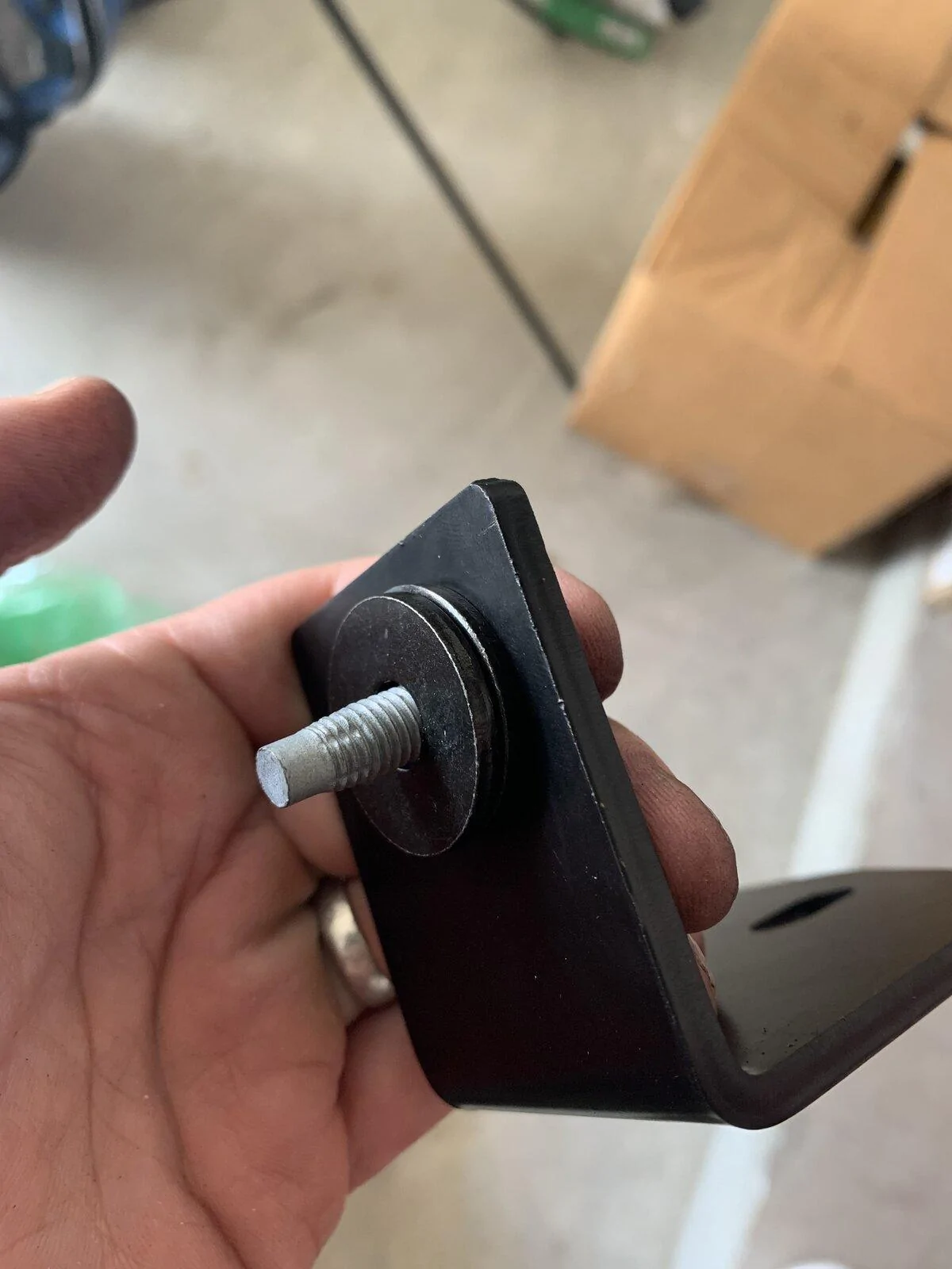

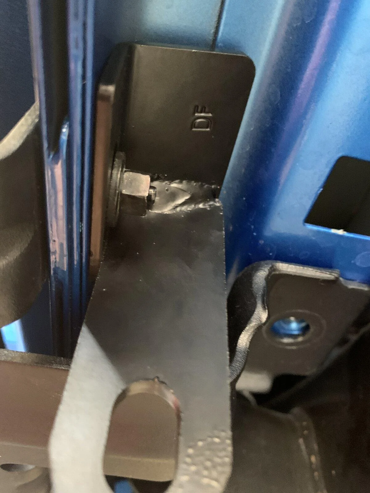

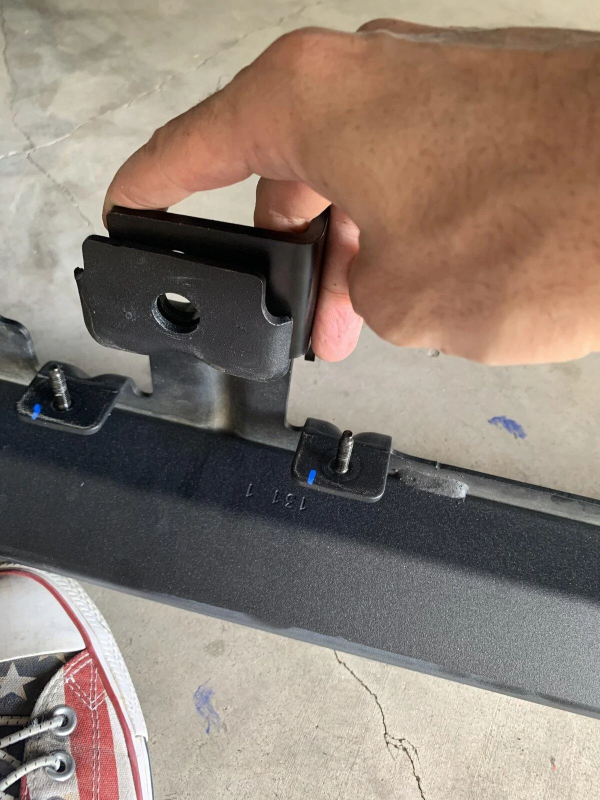

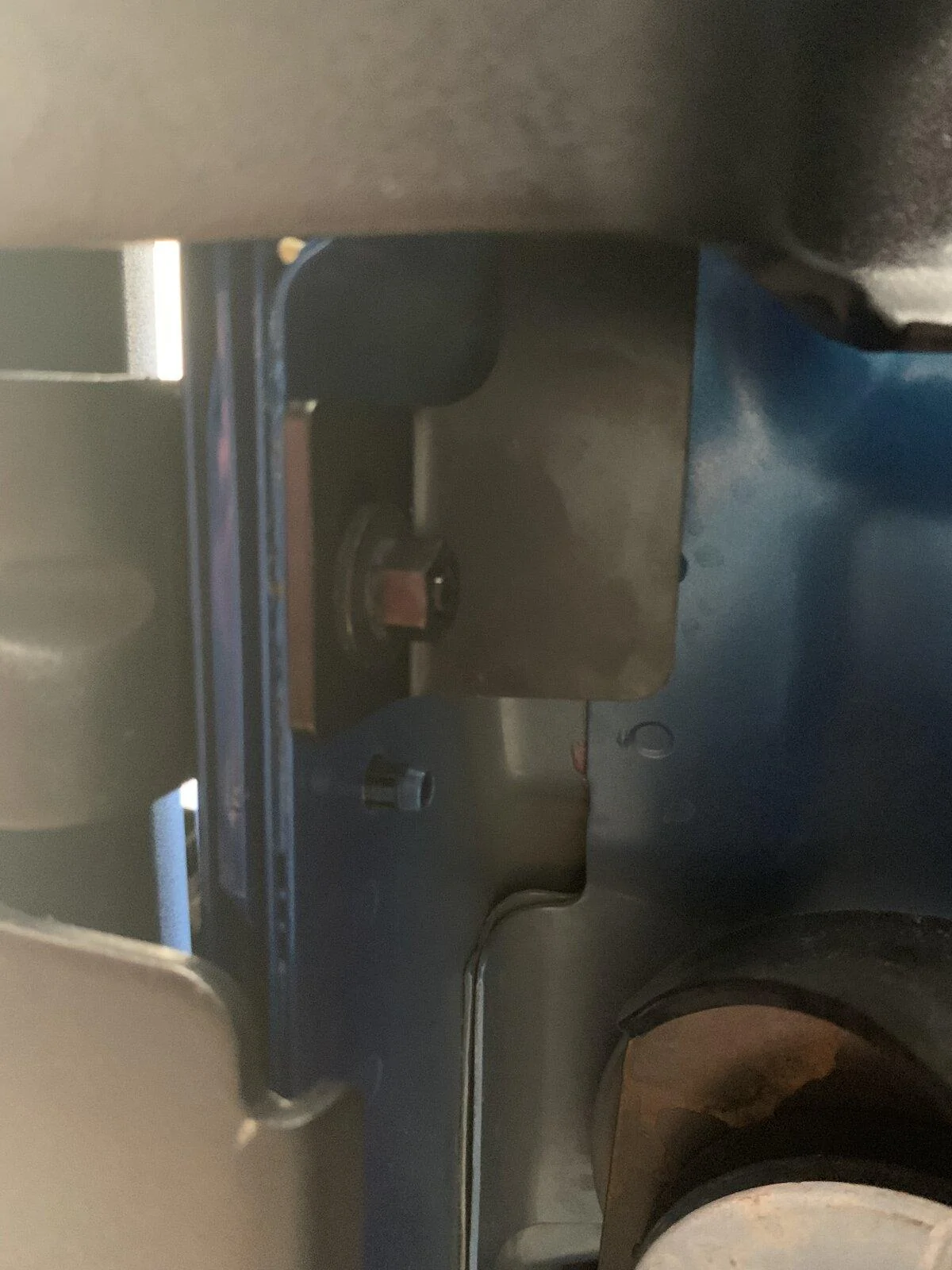

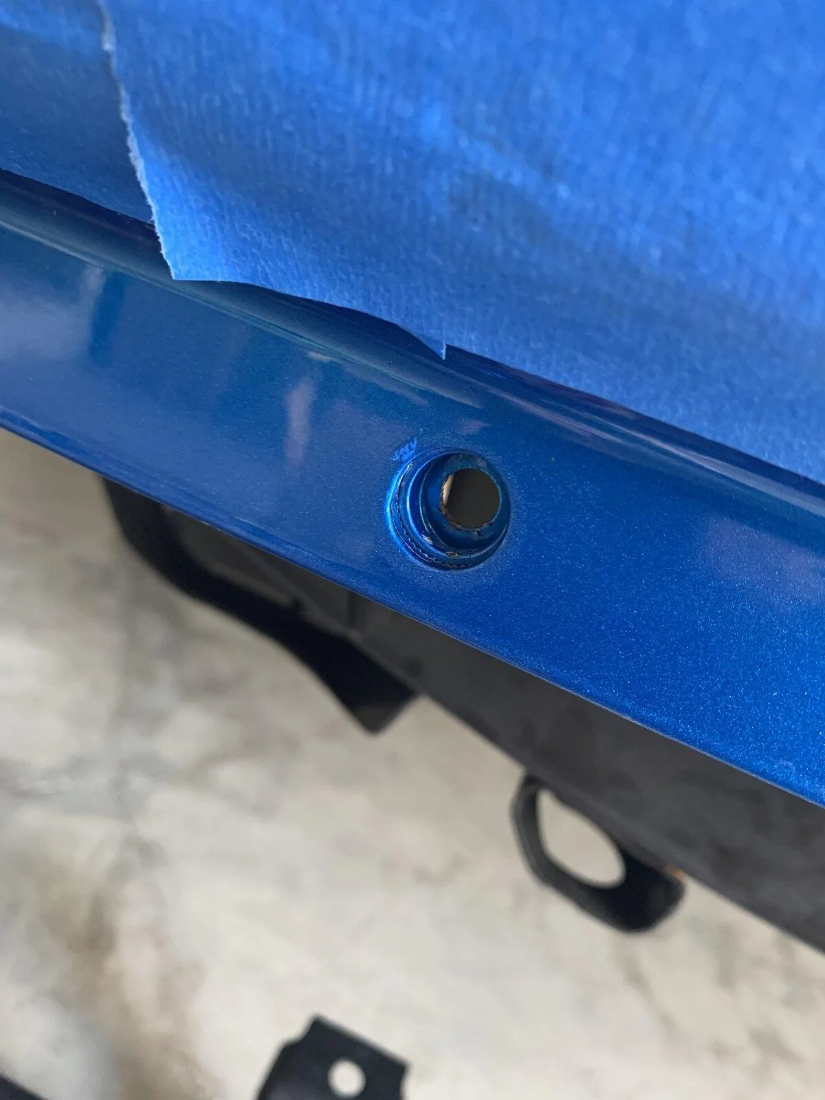

Finished the install. To use the sliders with the Jeep factory rock rails you’ll have to put the Barricade mounts over the factory mounts. I was able to reuse all of the factory screws with the exception being the front body mounts. The Barricade front mounts don’t fit exactly over the factory mounts due to a lip along the factory mount’s edge - so I had to use a couple of washers to fill the void between the two mounts to ensure the Barricade mount sat flush with the top of the lip. The Barricade front pinch seam mounting bracket can be used during the install - the center and rear pinch seam mounts can’t be used due to the factory rock rail brackets. The most frustrating part of the install was properly aligning the Barricade rails while all mounting screws were semi-tightened. I found it easier to start tightening the rock rails down at the center mount, then the back and finally the front.
I appreciate the pictures you sent, as they were extremely helpful in assisting me with my installation.

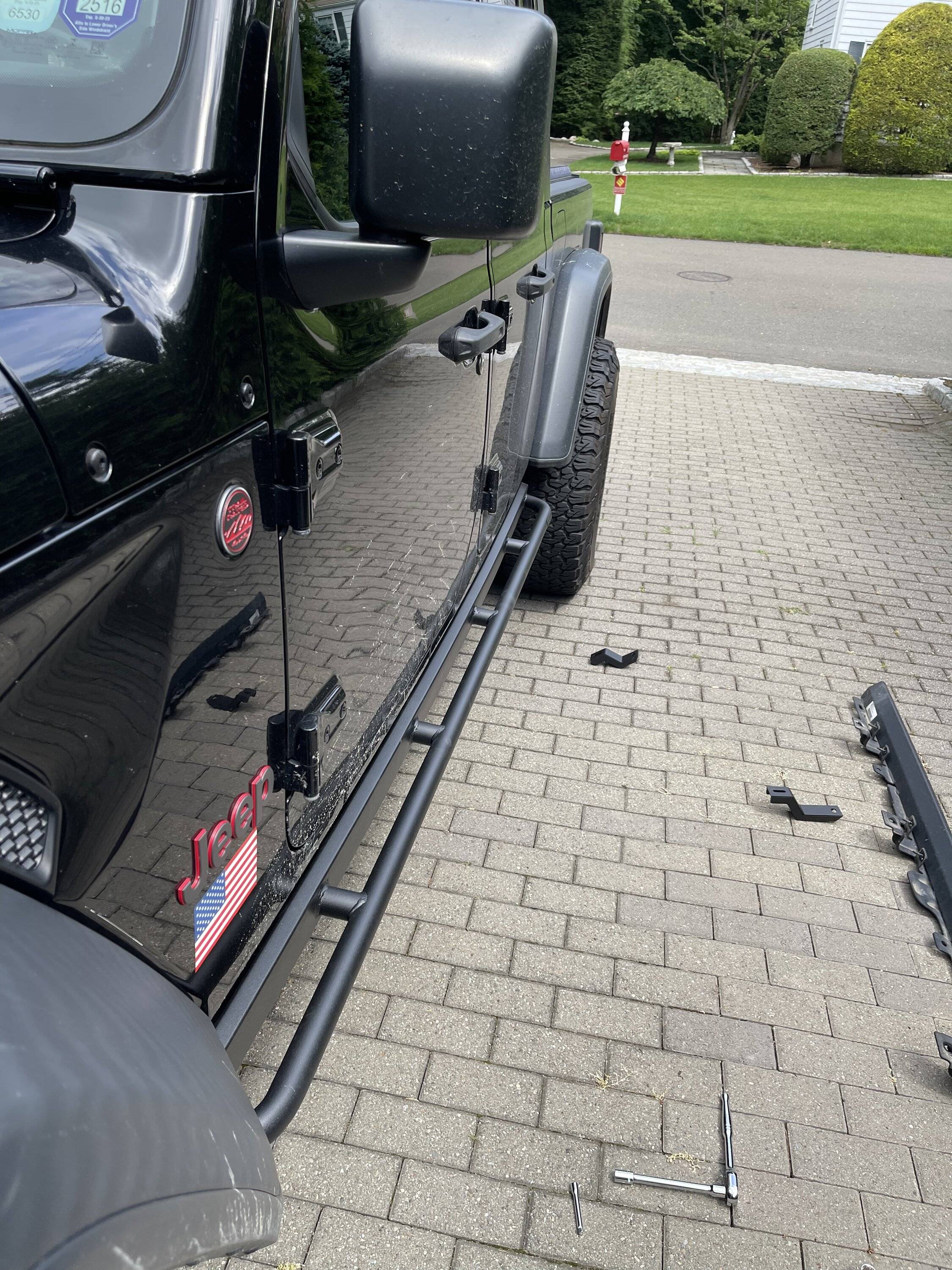

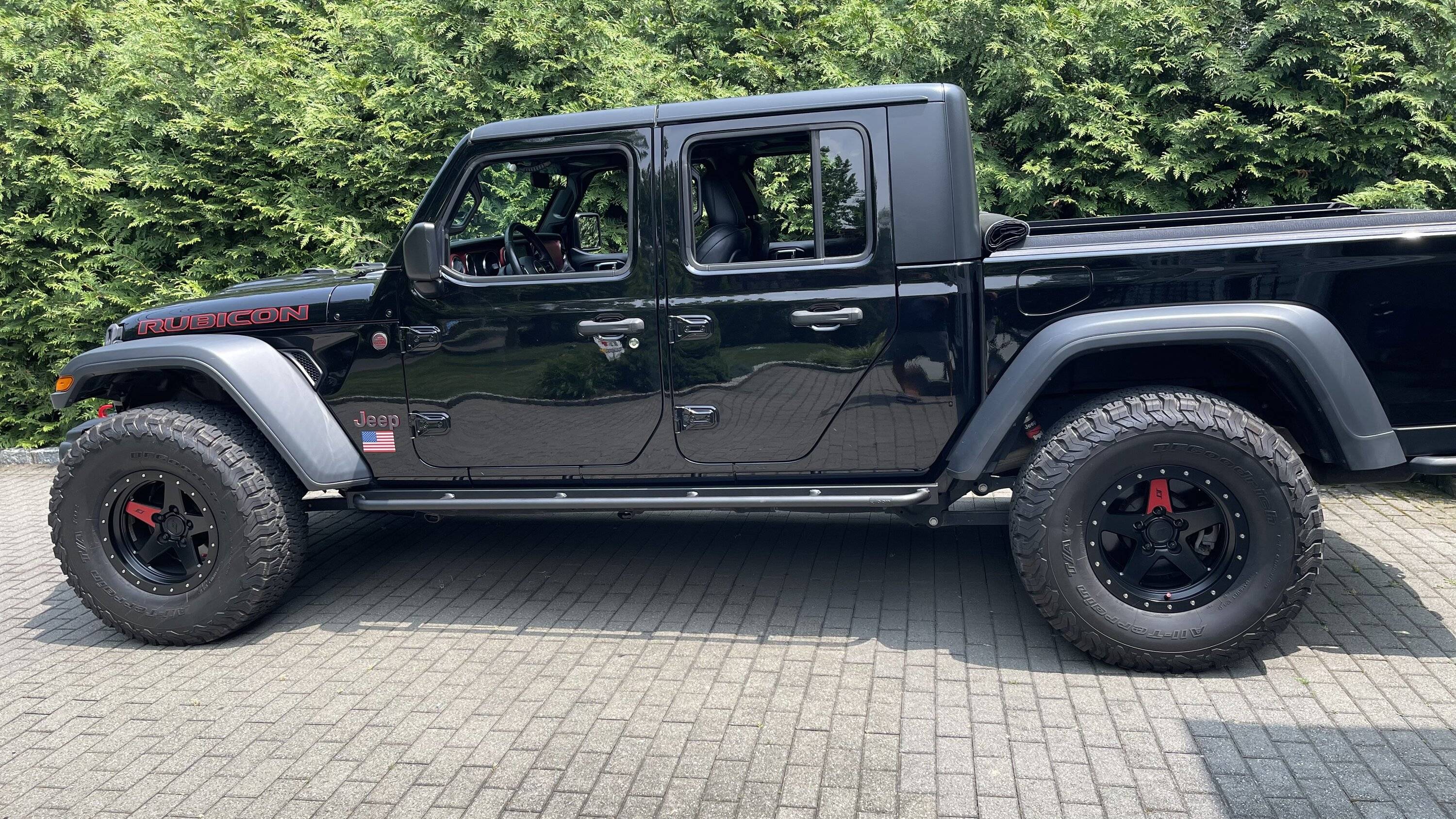

Just installed the new “enhanced” Rubi rails , JEEP version
great finish - easy install
I am considering getting a set of these too. Do these enhanced rails conform to the body like like the factory rock rails?
They look like they do in this pic
Thanks

Exact same connections… pretty much a direct replacement with the addition of a few pieces.
I really wanted the Ace but for the money these are awesome.
Look great - nice finish, act like a step for the kids
