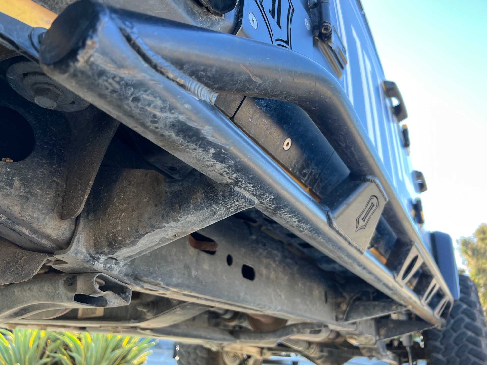

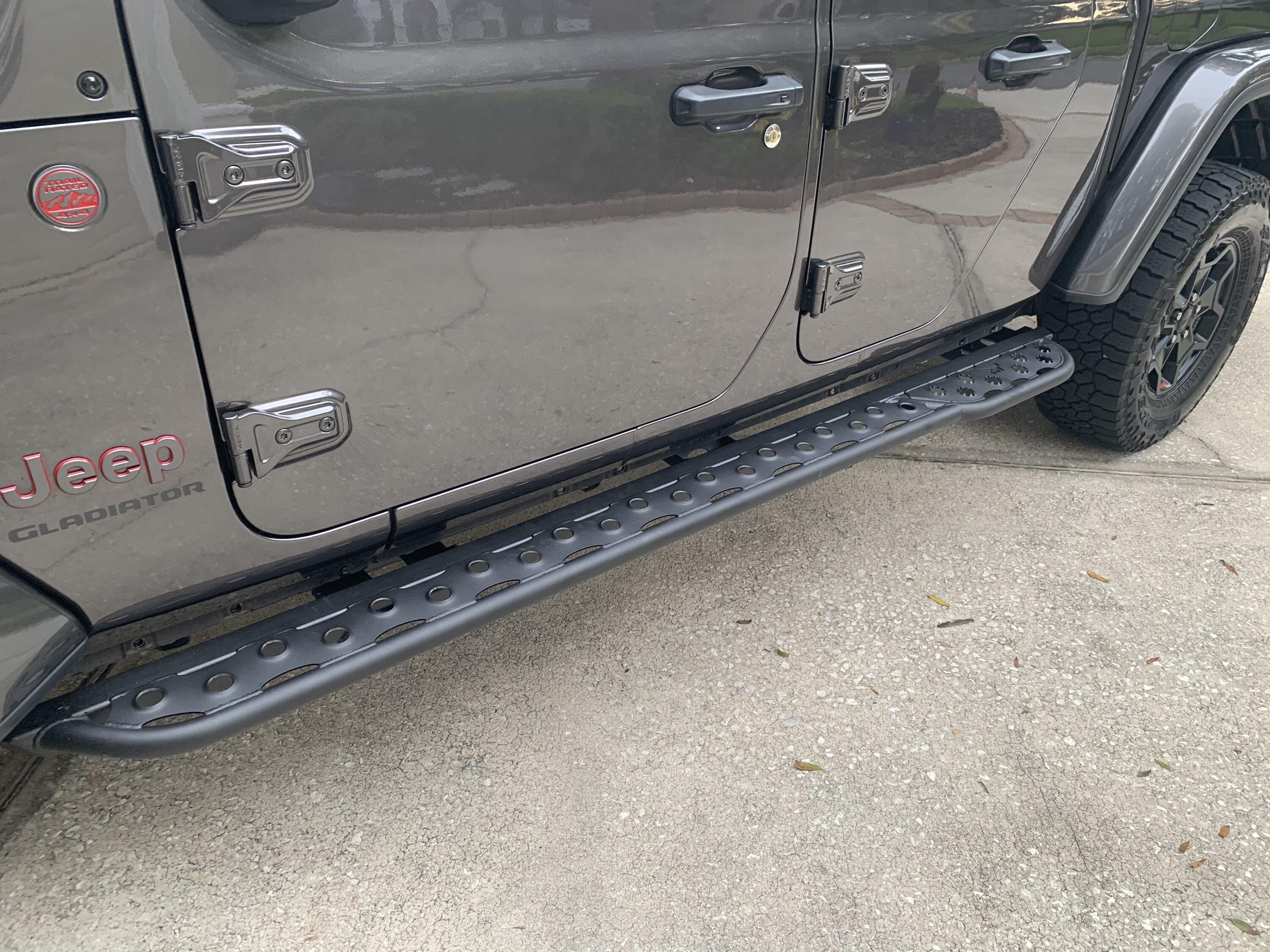

Icon was great when I asked them for more pictures and they sent these. Hope this helps until I can get them installed.
Jeep Gladiator Icon Rock Sliders 8484B741-4FBA-4BFB-BE09-F39D66A4D8B7
Jeep Gladiator Icon Rock Sliders 25660453-97A2-45FB-9623-1AEA6B8D9D94
Jeep Gladiator Icon Rock Sliders 7B8028BF-2E7F-4EB1-9E1A-7807AF88F9E9
Jeep Gladiator Icon Rock Sliders B80A8556-1B7B-49D7-B6F3-04D5DA814417

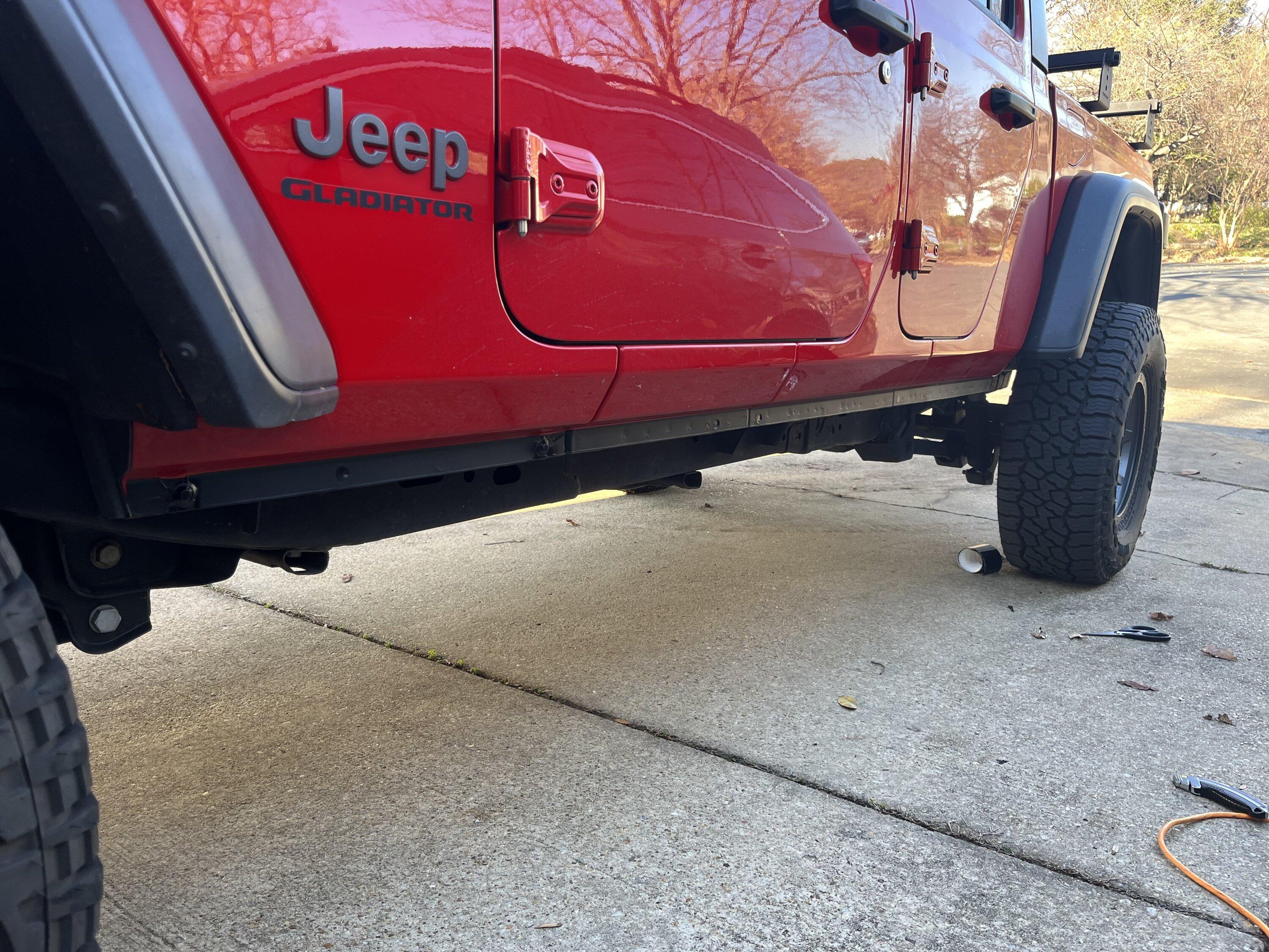

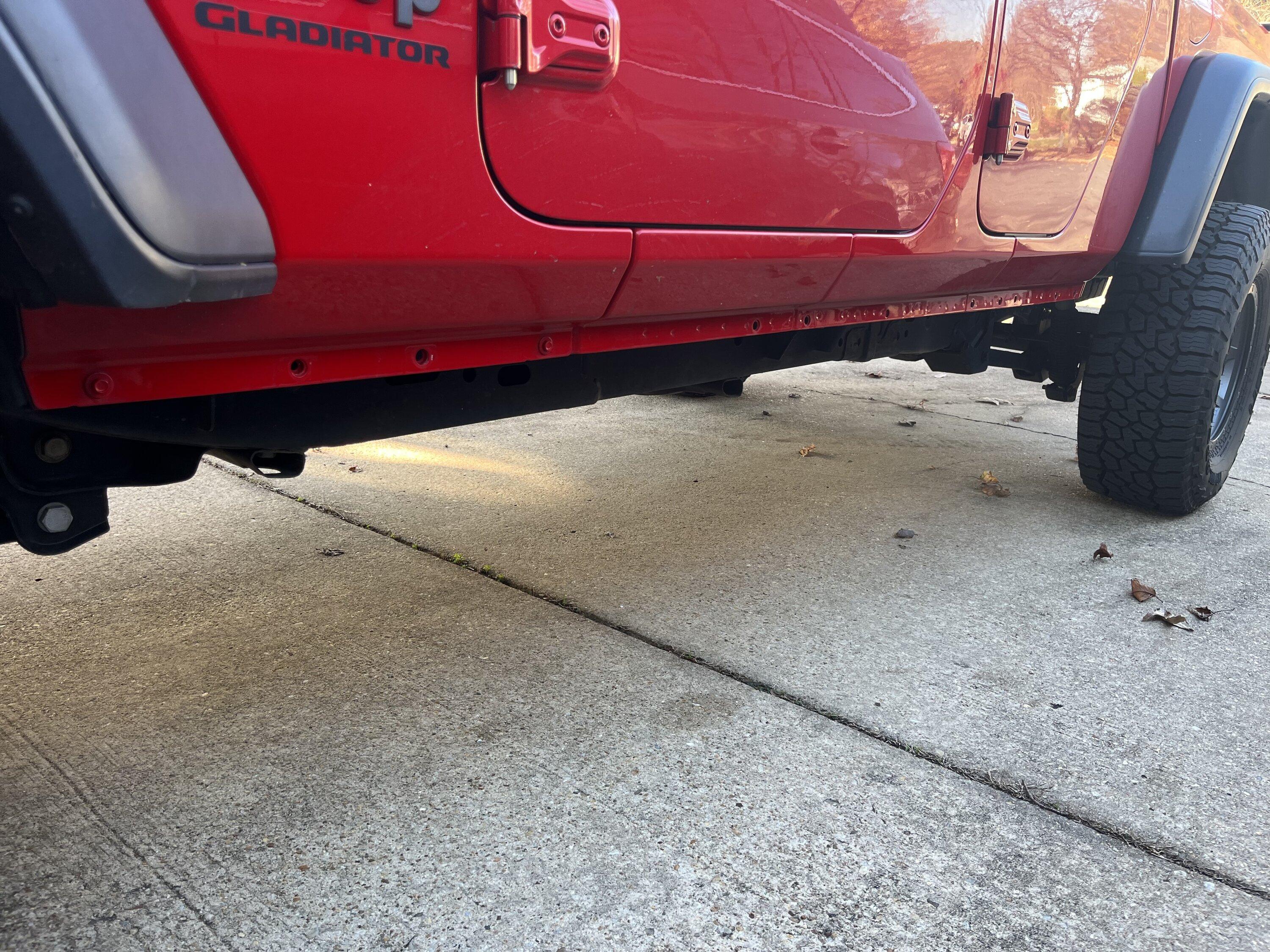

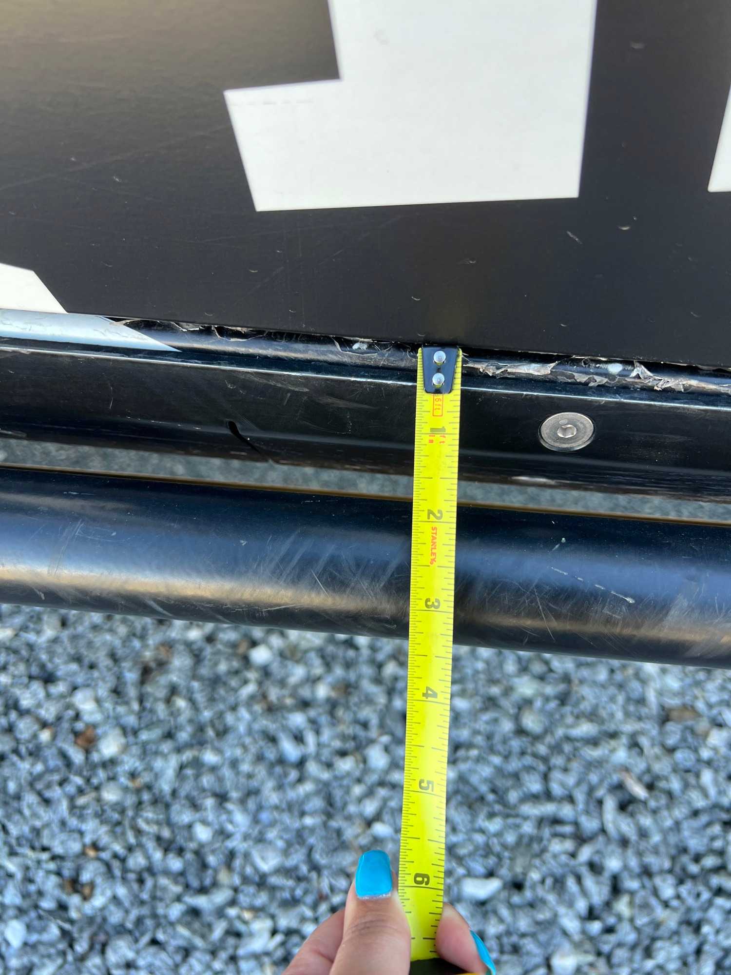

I only had to remove the back 2, was easy with my 17" long 1/2" ratchet. A bit of binding as with most people but never felt even close to breaking a bolt. I actually did all 4 (back 2 on each side) the day before. Ran them out, anti-siezed them, and then ran them back in and torq'd.
The front bolts are the ones i've heard people breaking, but just use the same technique. Hand ratchet, if it binds turn it in a bit, then back it back out. These are grade 8 bolts (10.9 since its metric), so while you can shear them its unlikely to break them by hand with a ratchet unless they got cross threaded.
Stock rails are off. Did you place a new nuts and bolts back into the pinch seam? Before you wrapped it
No, I just wrapped the holes and stuck the back to the front of the vinyl. Make sure you clean it thoroughly with alcohol front and back of the seam

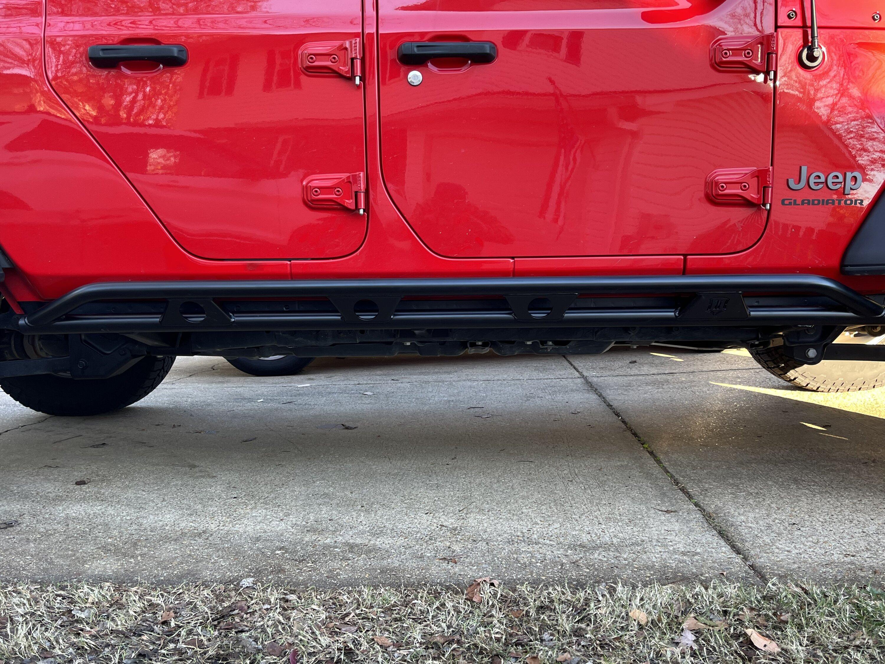

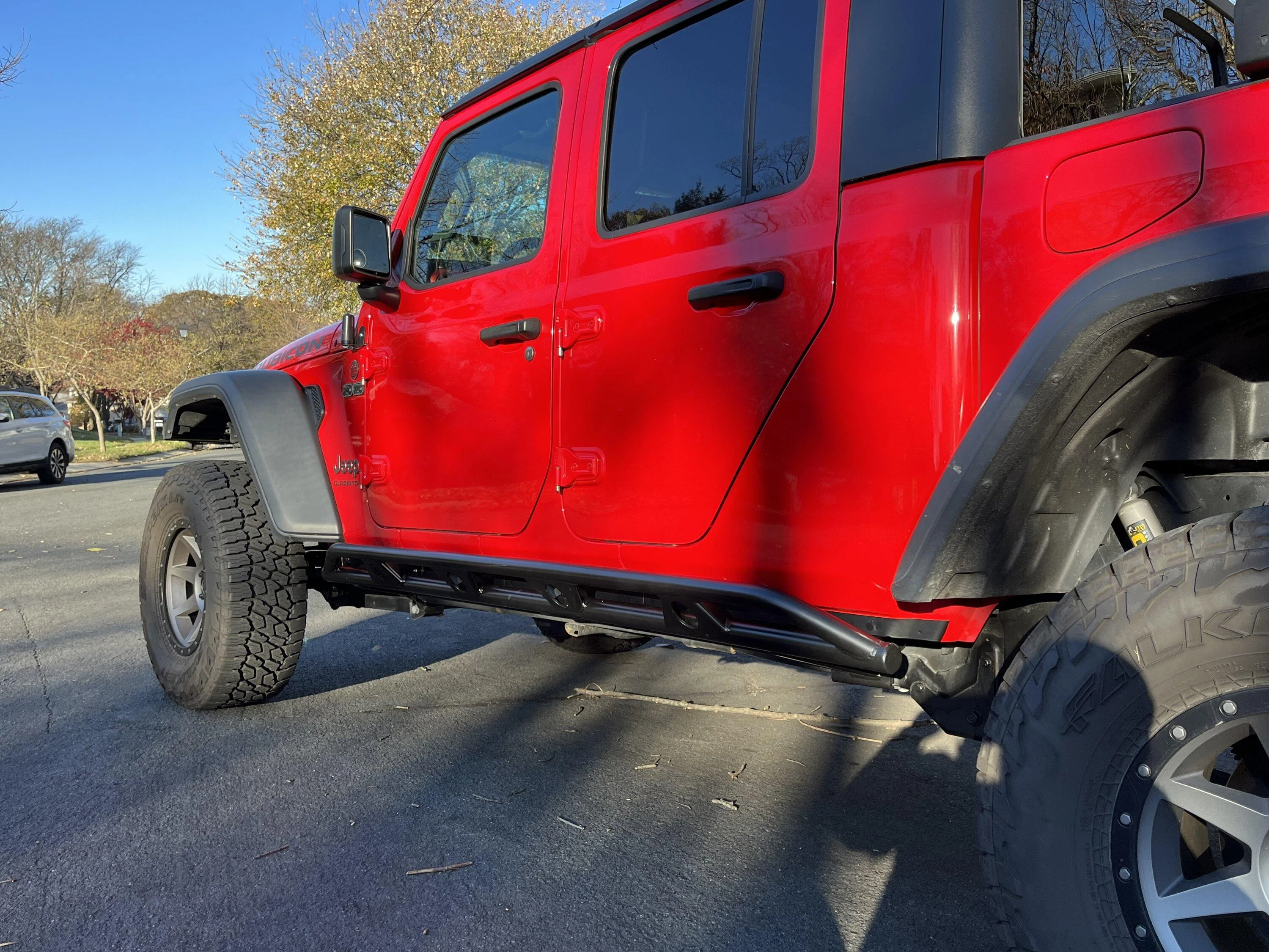

Pinch seam is wrapped. Now for the fun part.
Jeep Gladiator Icon Rock Sliders B866354C-6746-42F4-BD54-78E62E9A7EB9
Jeep Gladiator Icon Rock Sliders 2EBE4E4C-F394-4E8F-B103-F93C715BA93B
Tstrausburg
Tstrausburg
Todd
Sep 22, 2020
98
166
Maryland
JTR

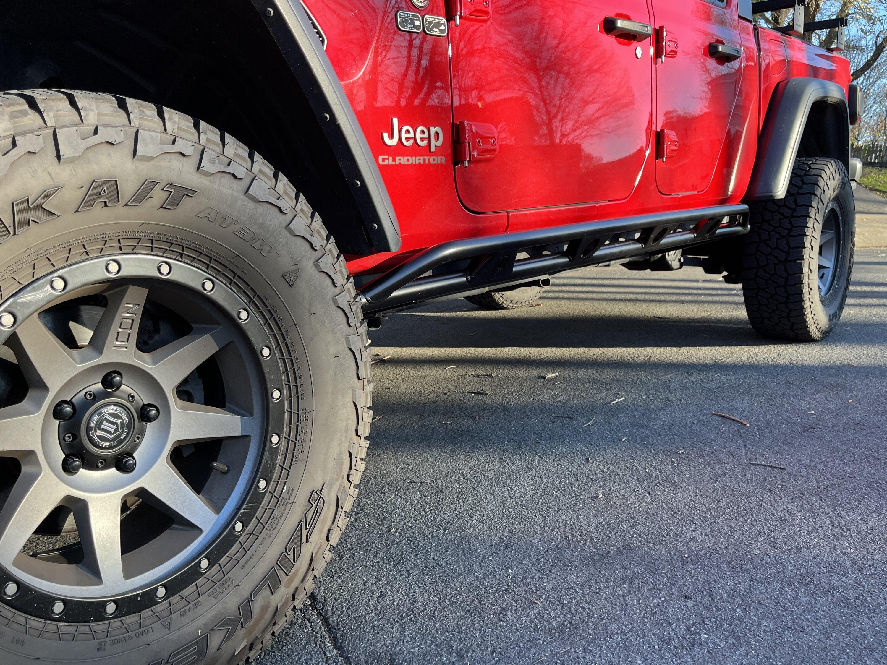

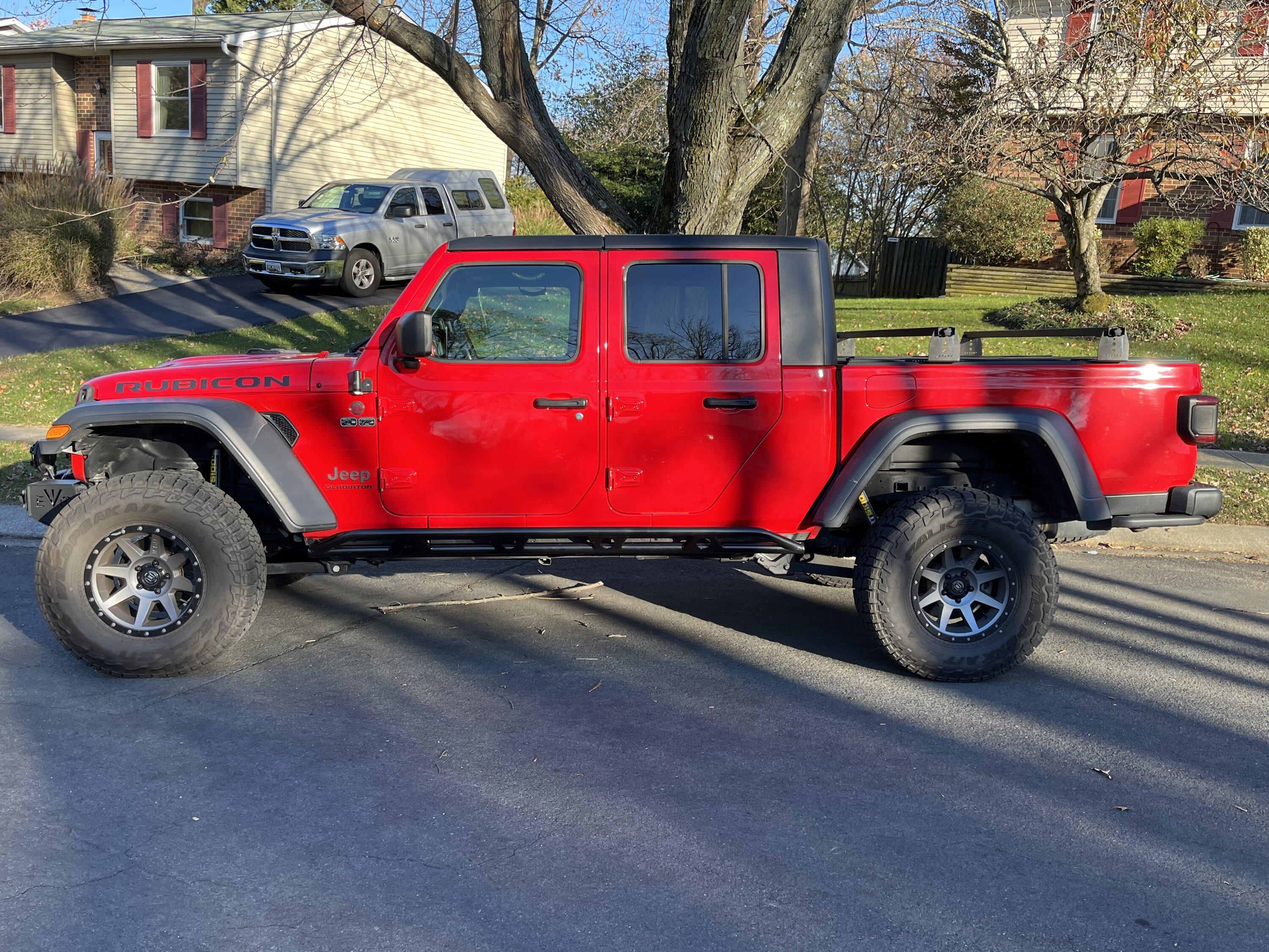

All done. I love the look and they’re definitely gonna be handle a beating.
Jeep Gladiator Icon Rock Sliders B802EF9A-CA22-4DCC-BEF8-11FE49493768
Jeep Gladiator Icon Rock Sliders F3C513EE-BD85-49BD-A15F-15ECF949810E
Jeep Gladiator Icon Rock Sliders A087DA2F-2D05-4A91-824A-F7E229726CFB
Jeep Gladiator Icon Rock Sliders F3AC5252-58D6-4EAA-B46A-B172322D990D
Jeep Gladiator Icon Rock Sliders 9403F203-9B33-4886-B293-ADB10B8CE6DF

They came out great definitely the best real rock sliders out there for the price. Question did you have to loosen middle body mount bolt or did they slip right over?
Tstrausburg
Tstrausburg
Todd
Sep 22, 2020
98
166
Maryland
JTR
No need to touch the body mount bolts. They have a hole for it to sit in. The two small bolts to the side of the main bolt get attached and then you have to drill some additional holes.
Tstrausburg
Tstrausburg
Todd
Sep 22, 2020
98
166
Maryland
JTR
Where did you get the pinch seam covers? Looking for them but only find them for a JL.
I just bought vinyl wrap and put that on
