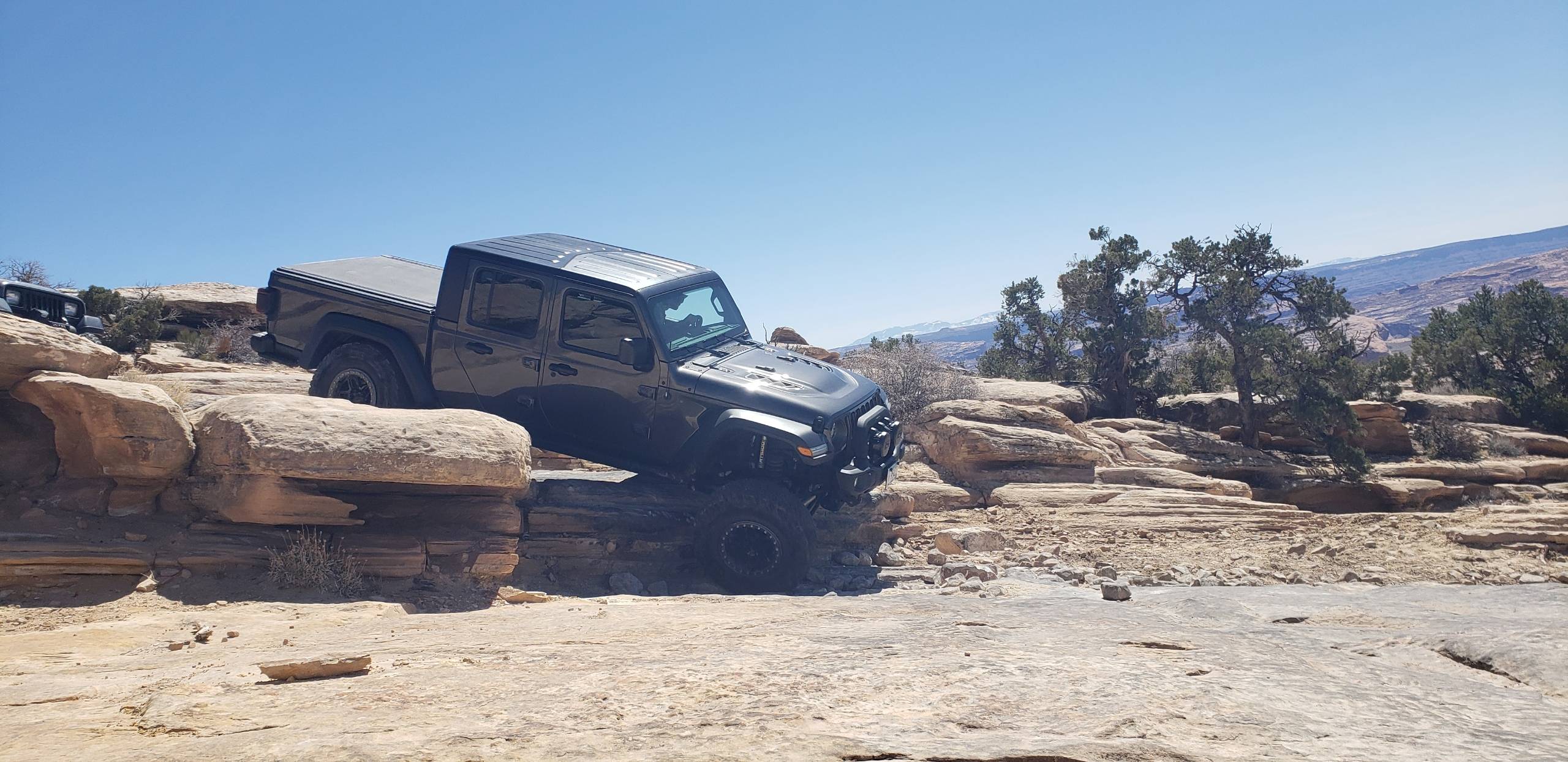

I have rockhard and have been very impressed with them. Have had jeep guys and sponsors I've wheeled with impressed with them. They have held up to a pretty good beating and just touch up with a coat of gloss black. Plus they work as a step (mostly so I can wipe the roof off).
That being said like the look of rustys a little better, but not drastically. Rustys wasn't available when I wanted to order.
No experience with Icon
