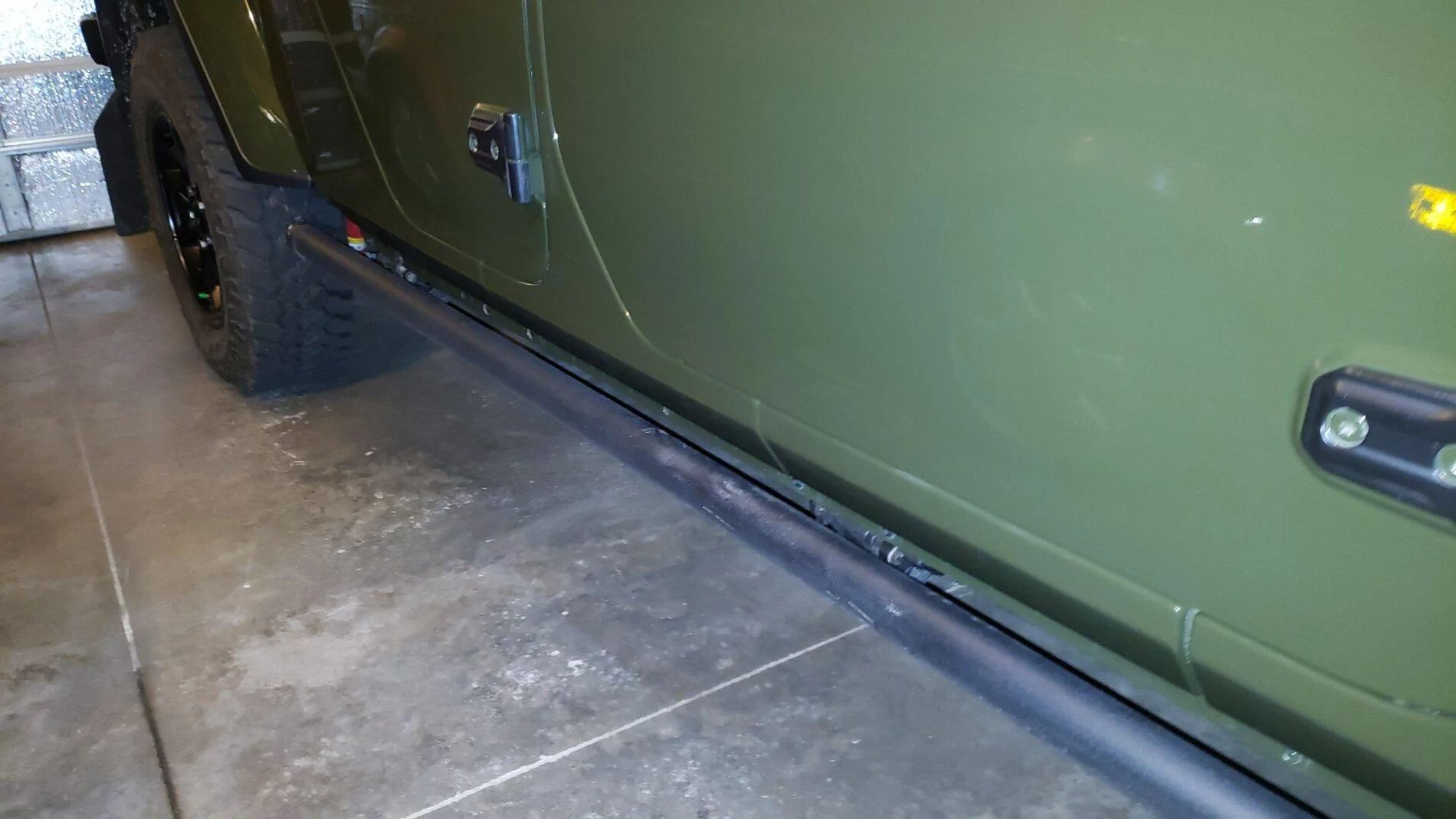

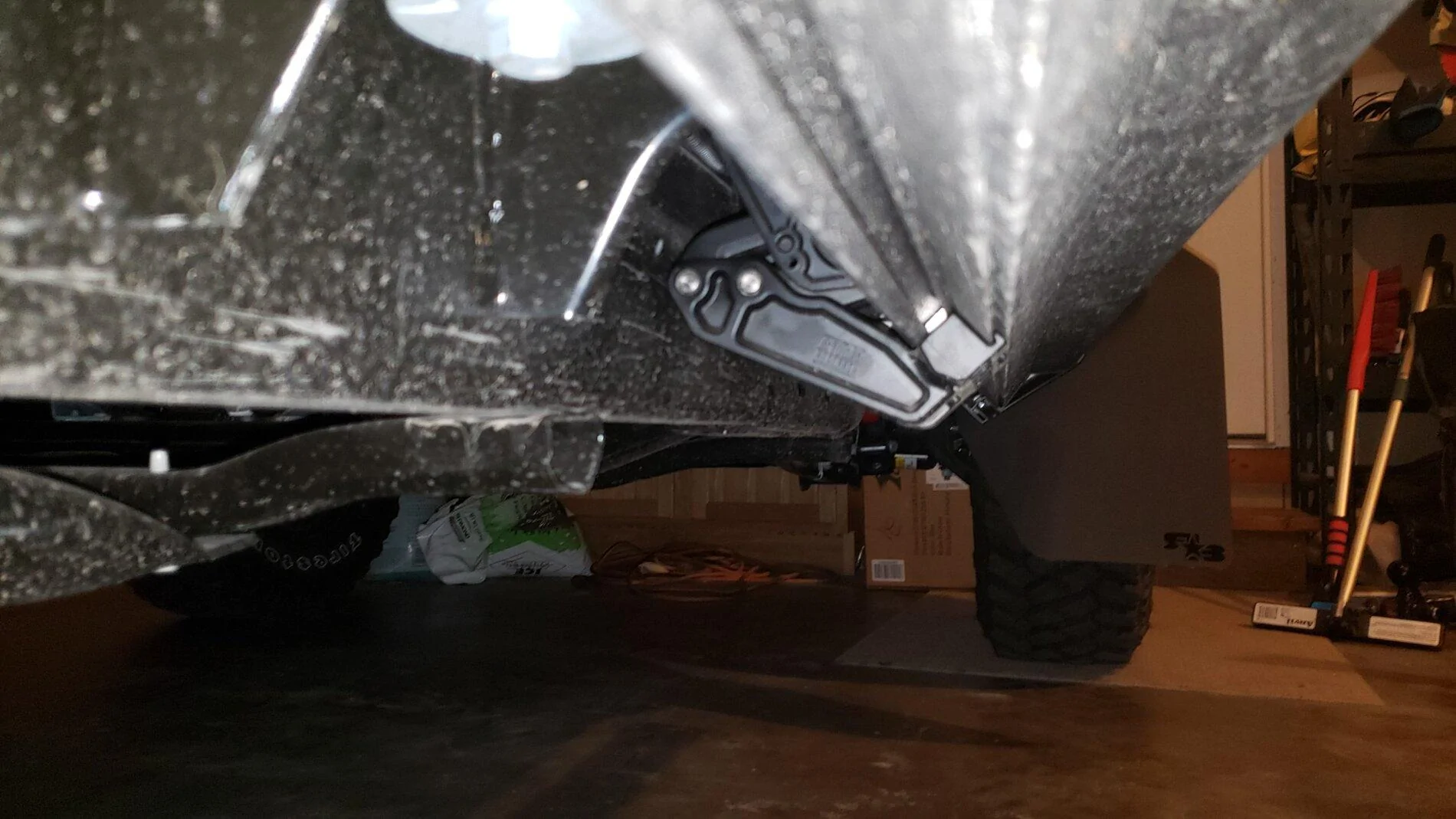

What version do you have? This YouTube video shows the XL and some sort of rock rail cover.
2020 Jeep Gladiator Rubicon with Amp Research Power Step XL with Rock Rail installed - Bing video
I didn't get the XL. Got this: AMP Research 75135-01A
I know that it says the XL has a rock rail, but it really just appears to have a cover for the same step and the step is still exposed on the bottom. I thought it also said that the step extends a little lower, which could have created too big of a step for my wife from step to inside.
I know that I can put something directly under the mechanism, but perhaps folks know off-hand of rails or something for under the frame that will just help provide a little better clearance from the step arm? Or should I fabricate something?

The angle/path of opening really blocks a lot of good options, I guess you could fab something like a c-channel. Bolt between the step and frame, then drops down on the inside of the rail and then outwards underneath.

That's an Idea I will look into. Thanks.
Trying to look online for anything like frame sliders....something other than sliding on rocks right on the frame. That might also provide a little added protection. Trying to avoid spending a lot and adding a lot of weight with protecting the whole bottom, but the channel even bolted directly to the bottom of the frame might add just a little extra space between a rock and the step arm.
