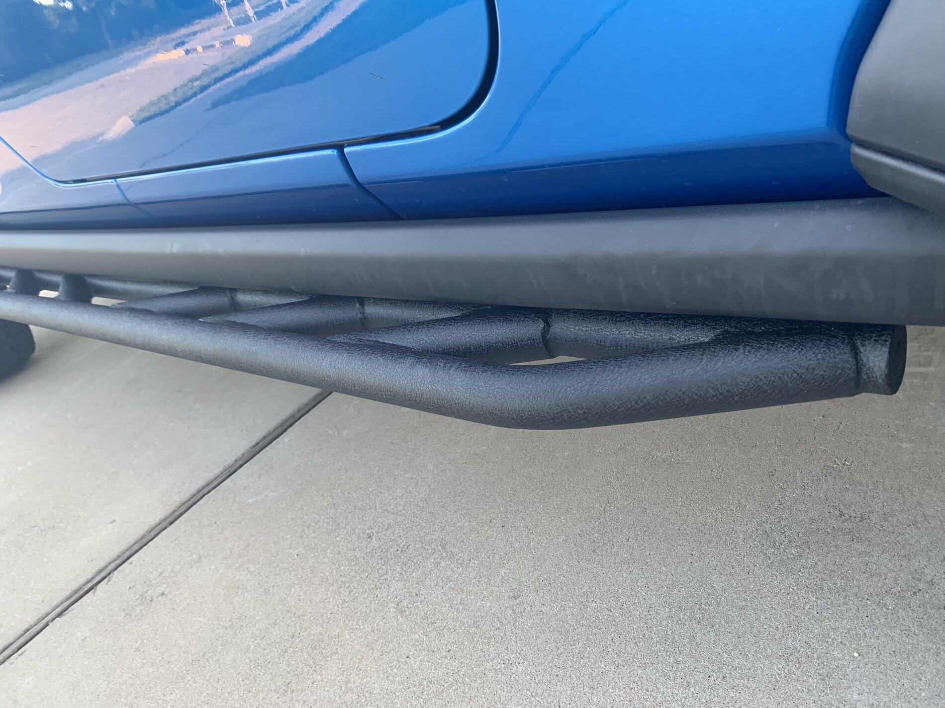

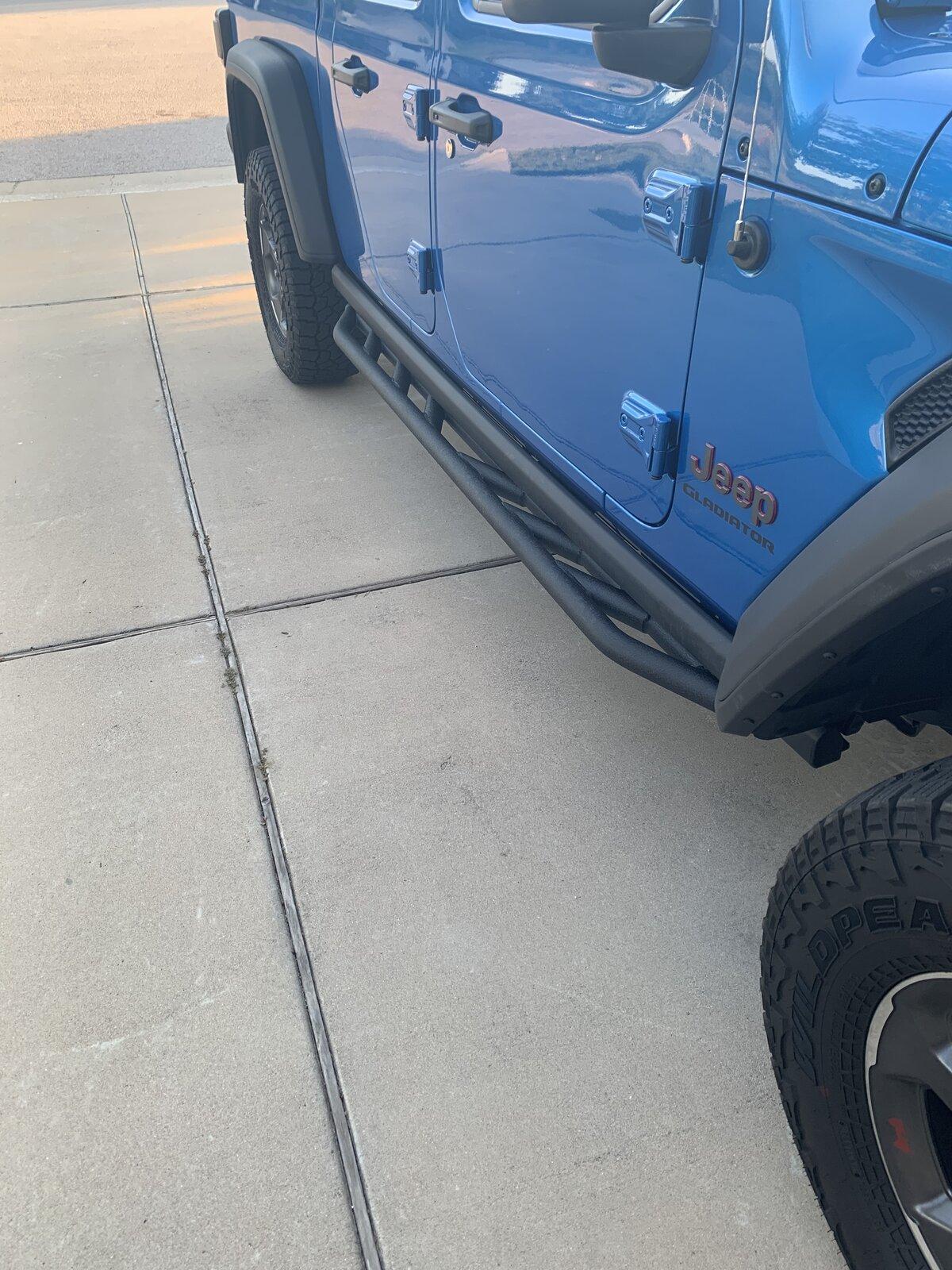

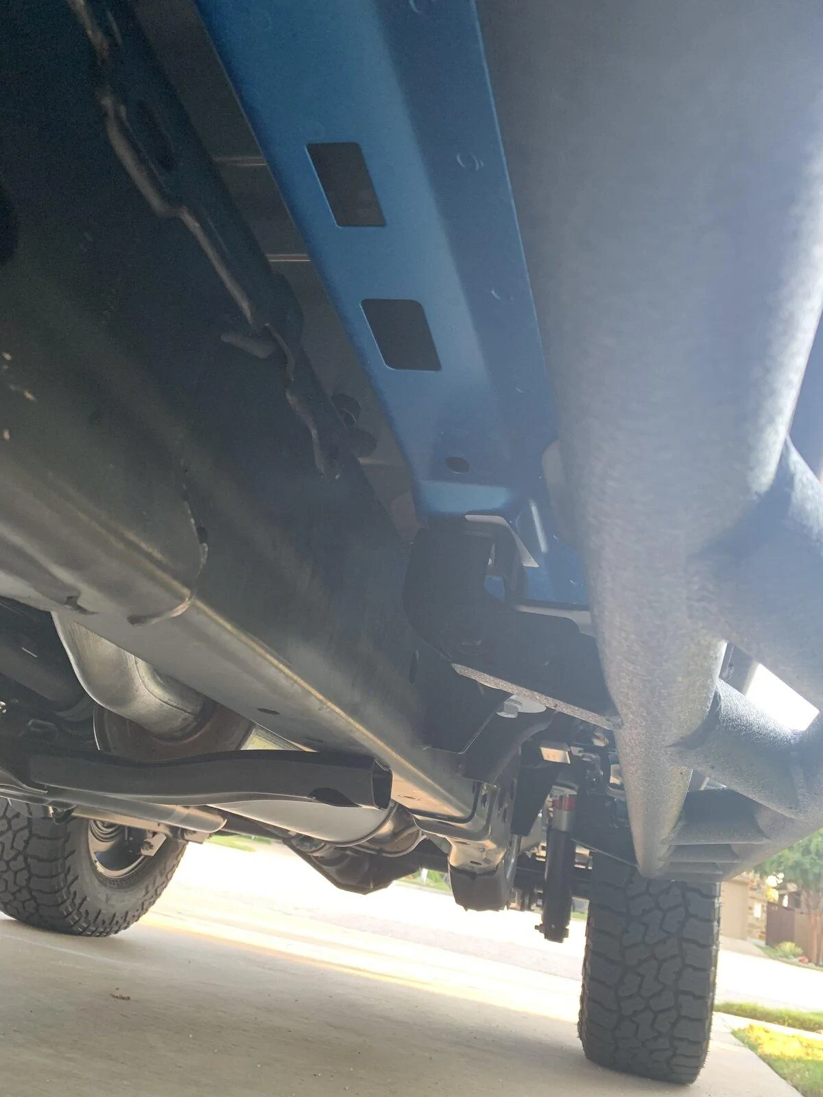

Finished the install. To use the sliders with the Jeep factory rock rails you’ll have to put the Barricade mounts over the factory mounts. I was able to reuse all of the factory screws with the exception being the front body mounts. The Barricade front mounts don’t fit exactly over the factory mounts due to a lip along the factory mount’s edge - so I had to use a couple of washers to fill the void between the two mounts to ensure the Barricade mount sat flush with the top of the lip. The Barricade front pinch seam mounting bracket can be used during the install - the center and rear pinch seam mounts can’t be used due to the factory rock rail brackets. The most frustrating part of the install was properly aligning the Barricade rails while all mounting screws were semi-tightened. I found it easier to start tightening the rock rails down at the center mount, then the back and finally the front.

So far so good - makes it easier for my wife and kid to get in and out (my biggest concern). The passenger front mount has a contact point with the frame due to a metal plate hanging off the frame. I’m going to have to adjust the mount on that side….

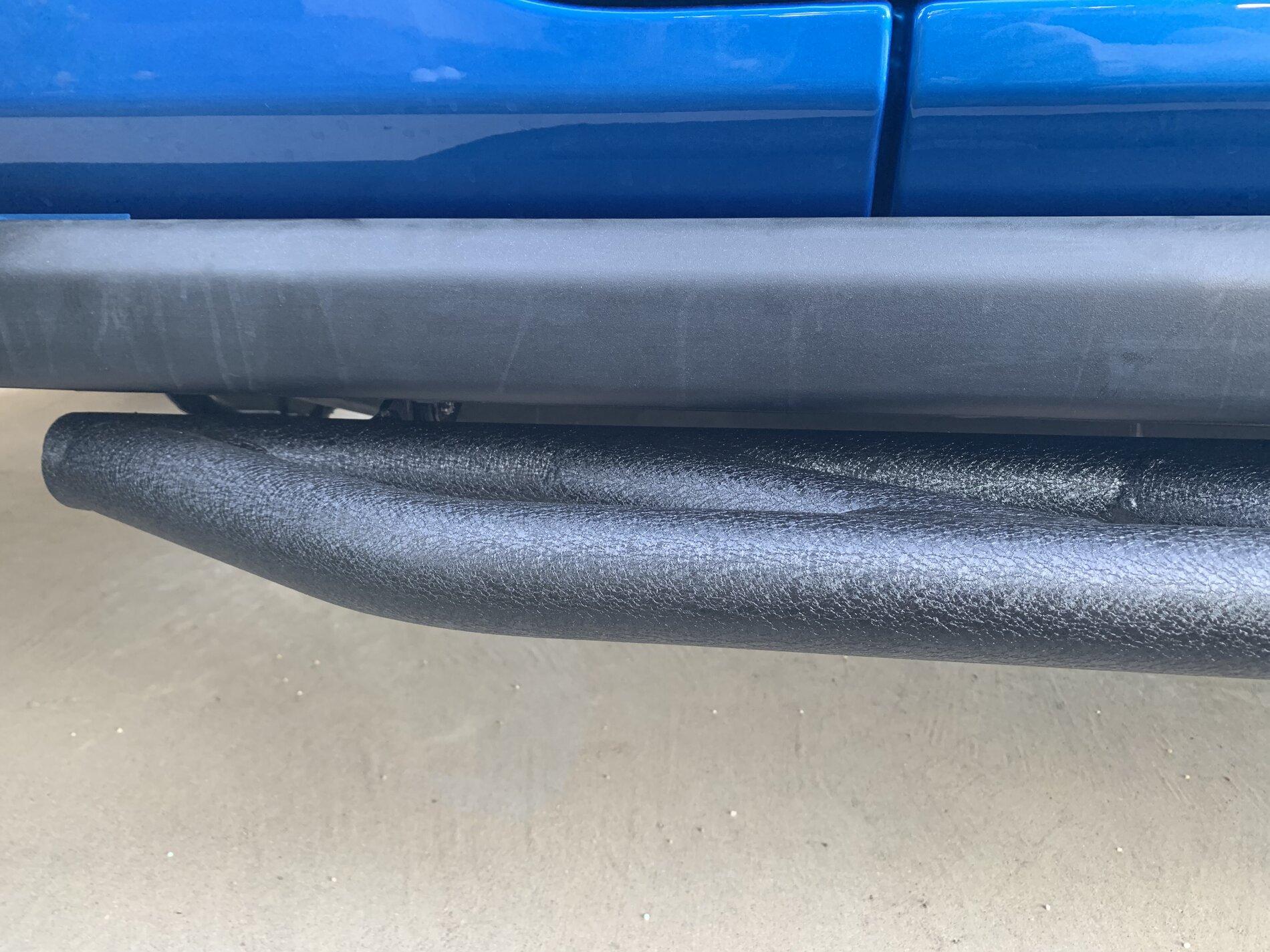

I agree - I needed something that can act as a step for my kid and wife. The rails are made in China and some of the seams have holes in the welds. Not the best quality - but they should do the job for the next couple of years until I get something better

For my needs they act fine as a step and to prevent errant doors from dinging my truck . They hang out far enough so that my wife and kid can step onto them and then step into the truck. They support their weight without issue - and they are textured to prevent slippage. They are not as wide as the factory running boards on the Overland or lower trims.
I couldn’t say about them holding up as rock sliders. The factory sliders feel much more solid than these. They may last a few runs - but I don’t think they are solid enough to take continual abuse. As noted there are a couple of seams were the welds have some minor holes.
