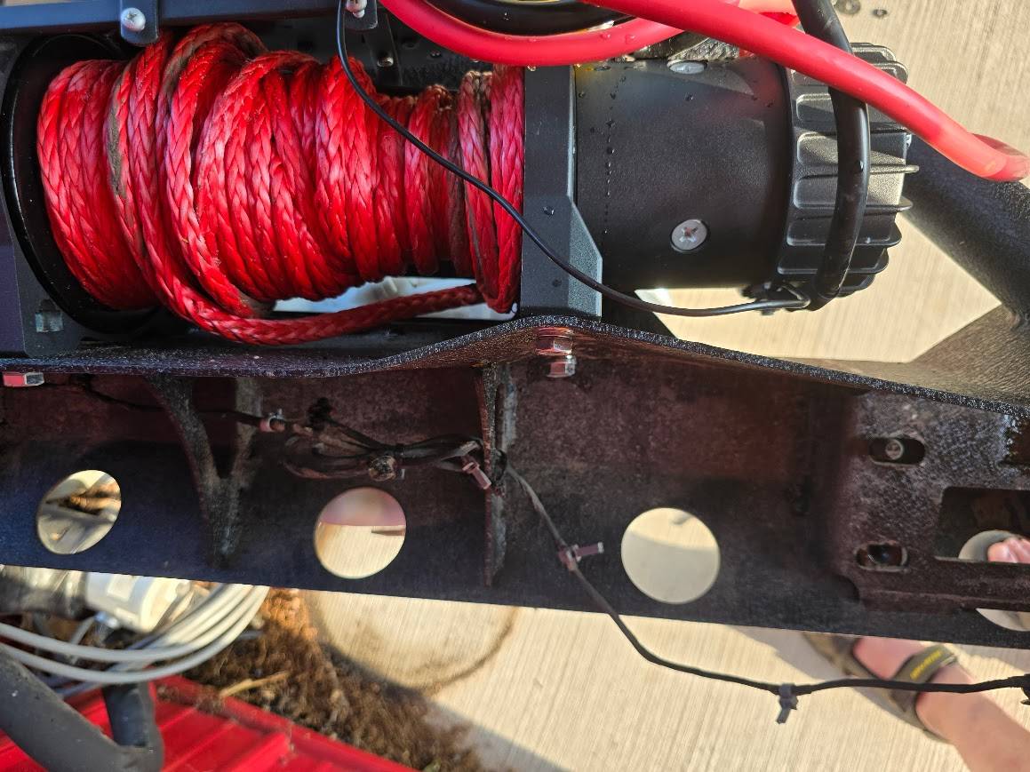

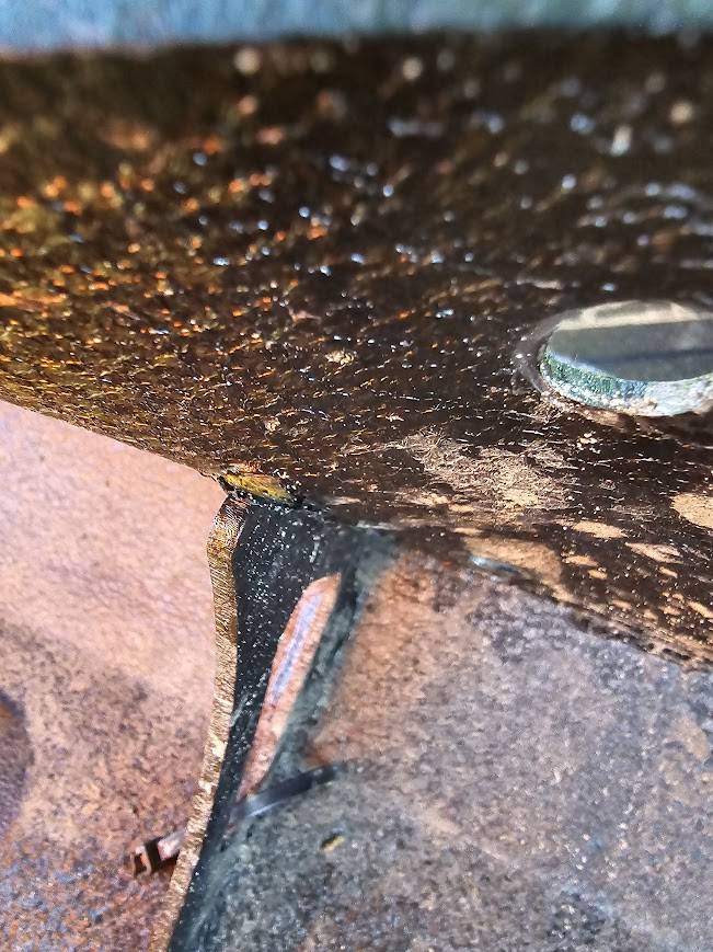

Had about 1.5" of plastic failure in the steel, as well as the beginning of the gusset tearing apart.
Also of note, shackle mounts are welded directly to the face of this steel, which is scary.

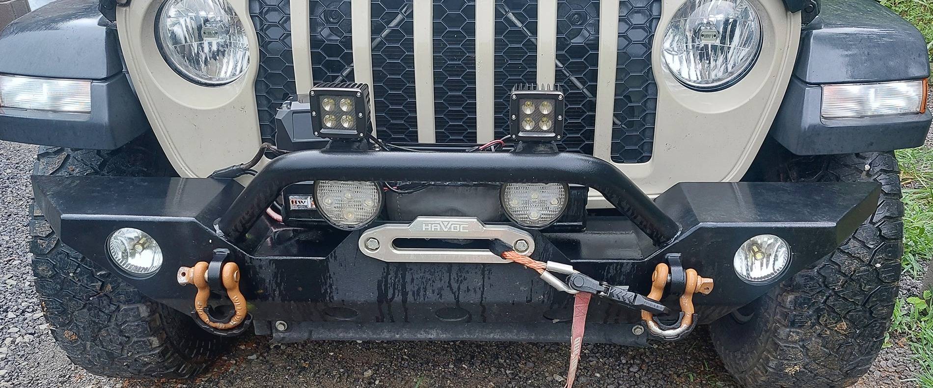

Back on the bumper subject, I've got the same bumper (sold for JK) on my JT. I've used it on a few winch pulls and haven't seen any issues yet. Many of these uses have been on bottom wrap of line. I definitely don't think it's a great bumper and was thinking of making some changes of it.

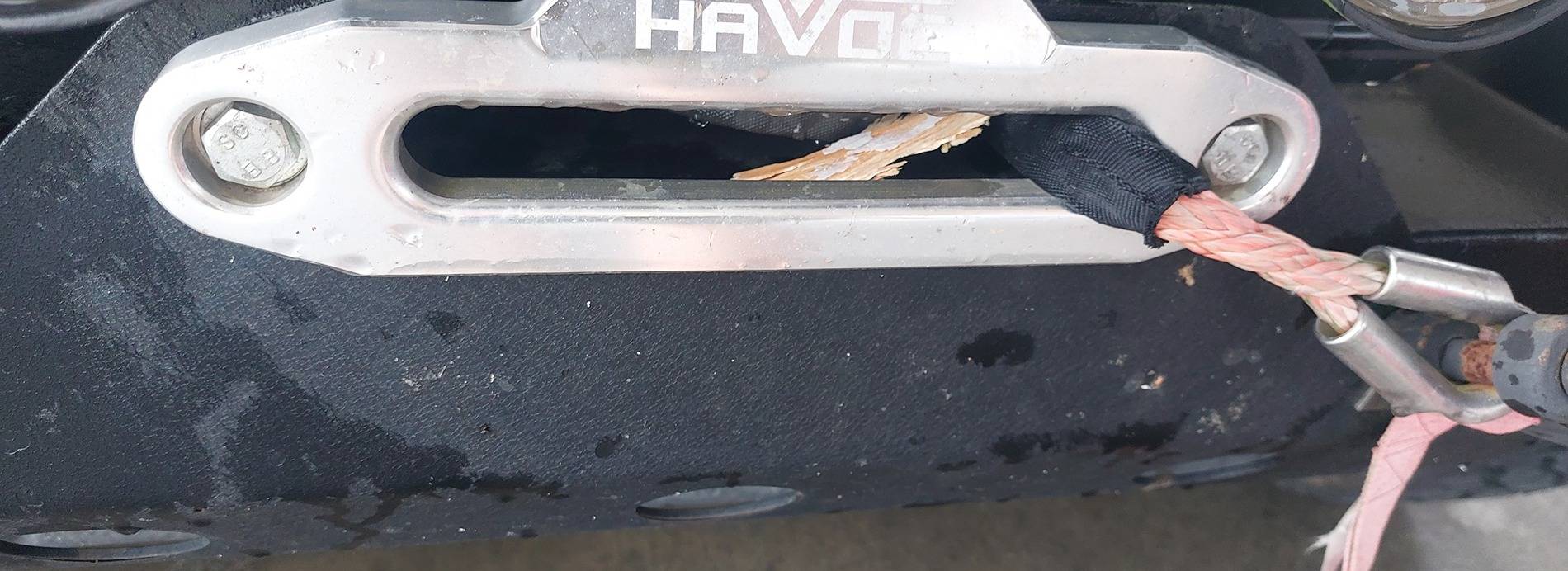

My primary reason for me buying it was front end protection from deer. Now on that 16 July I was towing a friend's trailer to his house to drop off his newly failed new zero turn mower at shop. A vehicle on I-state had sheet of OSB or plywood fly off the bumper and winch took the hit at about 69 mph.
Jeep Gladiator Barricade Trailforce HD Bumper after 1 use 20240728_151244
Jeep Gladiator Barricade Trailforce HD Bumper after 1 use 20240728_150806
The first picture is after I got off I-state and could look for damage, that's wood in the fairlead. Second I just took. There is quite a few companies selling this bumper under their name. As I know it's a cheap one the crappy coating has came off in places on mine. I've chipped loose off and rattle canned spots. My first choice would be ARB's bumper not in my budget though. The ARB product that I do like. That said I could be given a complete ARB air lockers system and free installation and I'd pass on it. Warn bumper is another great example of quality. If a Tomkin bumper was available for my JT it would have been my first choice since I've had 3 others and parts for my Jeeps.

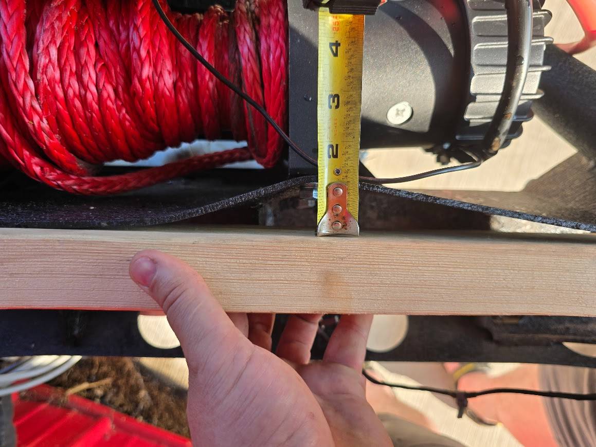

I know some people won't be able to help themselves from leaving some kind of Chinese junk comment as if price is the sole indicator of quality and we should all just buy the most expensive thing in any category irregardless of any other consideration ever like we're the government... Have a blast.
With that out of the way, this bumper is junk as delivered. Rated for a 12,000 lb winch, has a 10,000 lb winch on it, in one pull warped itself about 2" up from level and twisted the winch so hard it may be beyond redemption as well.
If you're thinking of buying one, I'd take a hard pass, as I could have been seriously injured here and I really wouldn't want to see anyone get hurt or die using a product as intended.

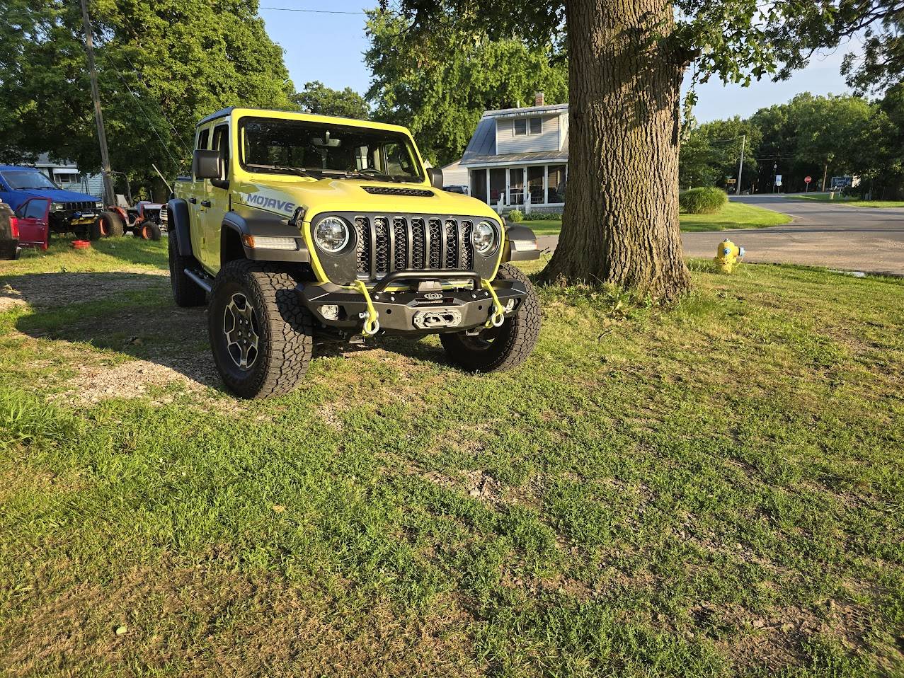

This thing has been long gone off my truck for nearly two months now.
My LOD bumper works great, 4 pulls on it, 1 tree, no bends.
Winch chassis was twisted, it also went back at the same time as the bumpers.
