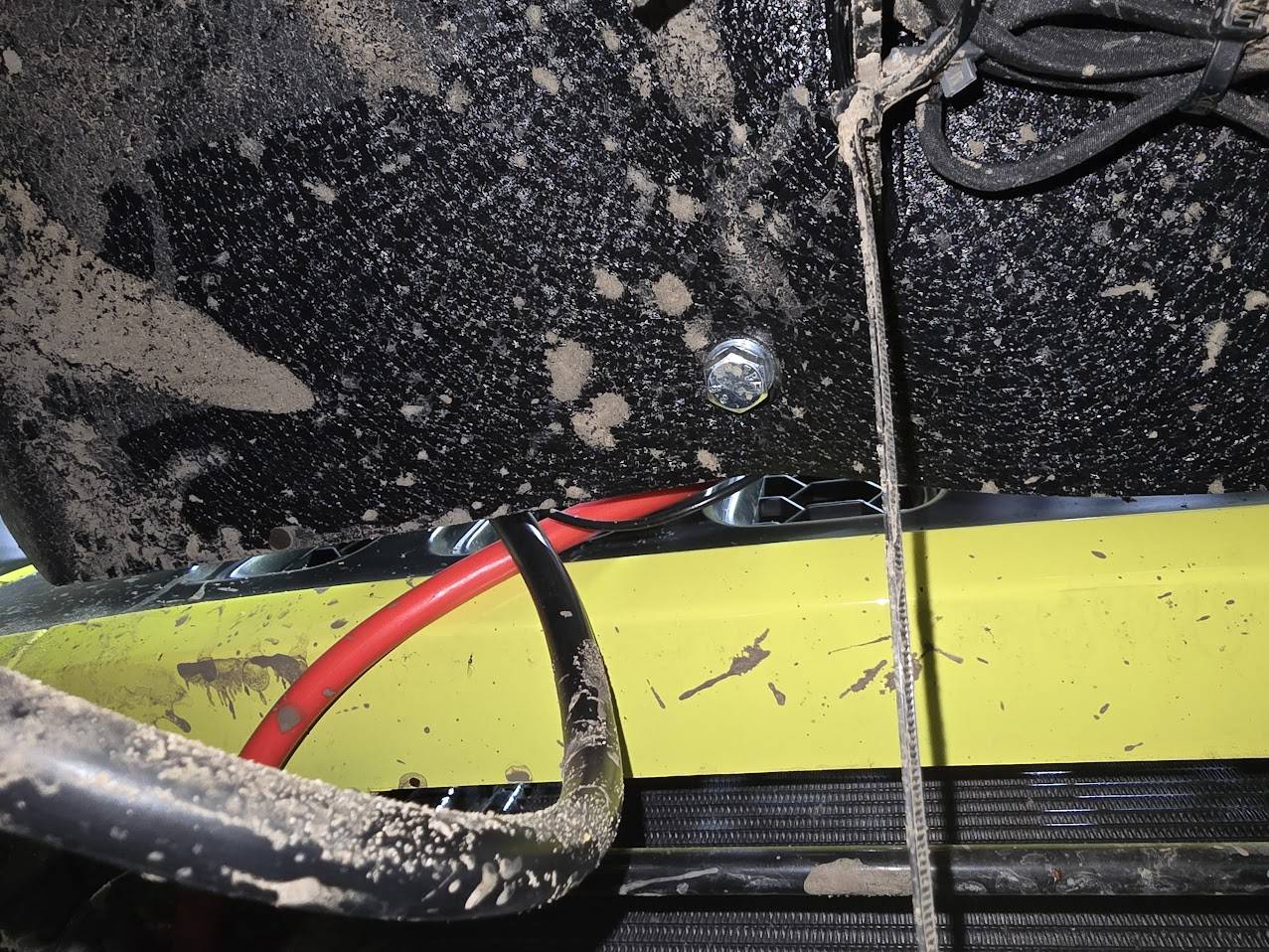

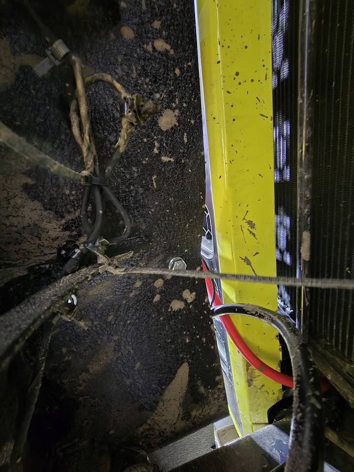

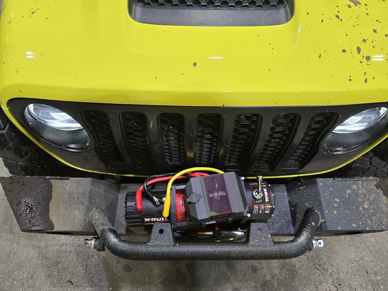

With that out of the way, this bumper is junk as delivered. Rated for a 12,000 lb winch, has a 10,000 lb winch on it, in one pull warped itself about 2" up from level and twisted the winch so hard it may be beyond redemption as well.
If you're thinking of buying one, I'd take a hard pass, as I could have been seriously injured here and I really wouldn't want to see anyone get hurt or die using a product as intended.
Tell me more about how you were winching. Straight line pull ?
Double line pull ?

Straight line pull, maybe 25' of rope out, so nowhere near the actual 10k rating of the winch.
I thought of fixing mine, I have a welder and CNC plasma table, but then what about the D ring mounts, etc etc.
This is my wifes vehicle, I want it to protect her, not harm her.

Does not surprise me when they spec it as 5/32" plate steel. IMHO, 3/16" is a minimum for any Jeep bumper and winch setup.
Borderline fraud how some of these Chinese sourced bumpers are marketed and self rated.

Chinese products, when built to a buyers specs, can be good quality products.
Chinese products built with no standards to guide them, are pretty much junk.
The Chinese use recycled steel when there are no specs or standards to follow. This recycled steel is pretty much anything that can go through the smelter and make new steel. In other words, all grades of metal get thrown in and melted together. Finished product looks like steel, but it's some unknown alloy that has not been tested for strength.
There is a reason people stress to buy American made products. The steel is graded, it is tested, it is certified to specific sheer and tensile strengths.
With all that said, when it comes to bumpers, nothing thinner than 3/16". That extra 1/32" doesn't seem like much, but it is.

Gauge is far from the only variable, the alloy, heat treatment and manufacturing process have a significant influence over the strength. A sheet of same gauge hot rolled steel will be weaker than the equivalent cold rolled steel. This the hazard in copy cat products vs engineered solutions. You’ll pay for the R&D and material quality but it’s a worthwhile investment. You don’t need the most expensive brand name, but you should do some diligence on your manufacturer.
Depending on where a company is located your may be limited in your options for redress. These fly by night Temu operators are effectively untouchable, they’ll swap names and pop up the next day selling the same crap and good luck filling suit. Caveat emptor.
