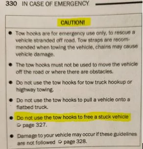

The manual is a bit contradictory in that is specifically states "Do not use tow hooks to free a stuck vehicle"
That being said I have watched recovery videos and folks using what appears to be a tree savor attached to a strap with a soft shackle. I am sure there are plenty of variations but to be safe I thought a closed loop system would be better.
They must not be referring to the factory tow hooks but rather an aftermarket tow hook. I have never heard of not using the factory tow hooks. Anyone else??
That is one of the best selling points for buying a Jeep. It comes outfitted to help those Taco guys ?
Here ya go.
Jeep Gladiator Basic recovery gear question Caution
