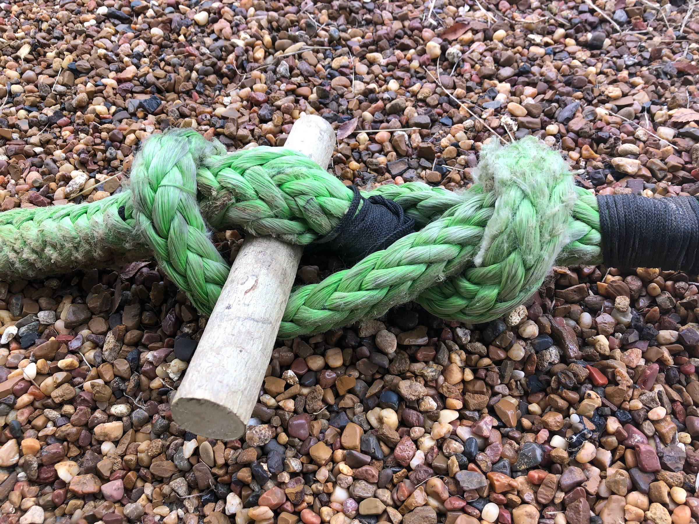

Here is what I mean about the dowels.
An old shovel handle or an elm sapling
can provide a number of free dowels.
Make four or five.
To join two kinetic ropes
pass one loop through another
and insert the dowel.

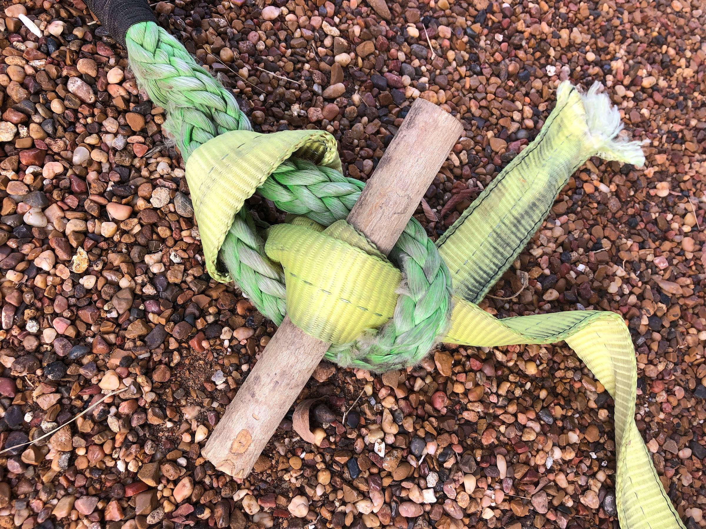

A dowel can also be used
to connect tow straps to kinetic tow ropes.

When done, pull out the dowel and the knot falls apart.

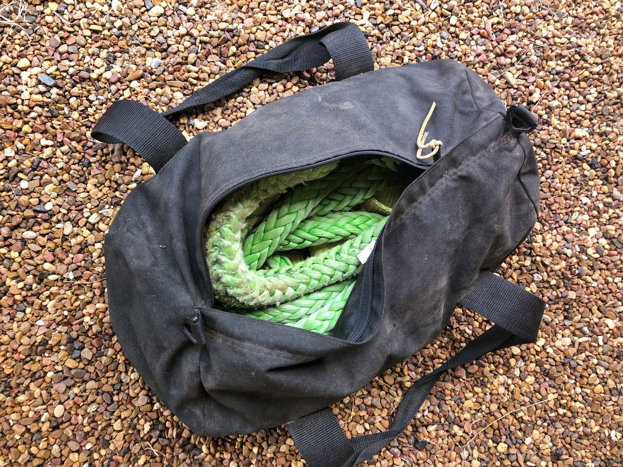

Stuff everything in an old cargo bag.
The Poor Boy recovery kit.
Jeep Gladiator Basic recovery gear question PuCpzO5gAdzDnldZzfrgweC4xC4hxCjDrNtOmwPxj6lV=w2400

Pieces of old wood? Sounds like a problem waiting to happen. Pretty sure my old wooden shovel handles aren't meach for that kind of force.
Actually works quite well. I have done it with a tree branch in a pinch.
I wouldn't build my recovery kit around dowels, but I have used a framing hammer and this technique to link a couple of snatch straps together with my old K5.
I would say to start by making sure your vehicle has solid, frame-tied recovery points at both ends, then get a decent snatch strap or kinetic rope and whatever shackles you need to attach it to your recovery points and the other vehicle. Build up from there.
