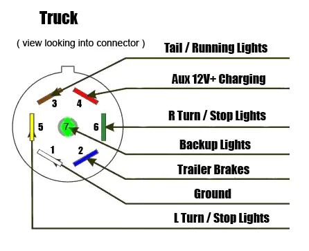

Ok I know where to get the 12v from the RV but how do you set that charge line. Do you run 12v direct to the battery ?? Do you have to use something special to protect the circuitry ??

I use a fuse in-line and a diode. Run from the 6 point connection to the battery.
Thank you !! How many amps for the fuse ?? And wire grade ?? Picture of your setup would be great
I didn’t use a diode (a silicon diode will have a 7/10V drop across it, thus affecting the charge on the Jeep battery. To do it right, you should use a battery isolator that puts diodes on both batteries,) just ran the RV +12V to the Jeep battery through a 30A fuse (I’m using 10 ga. wire.)
If I’m going to park for any length of time (more than a meal stop) I unplug the Jeep from the coach.
So use a different diode. The diodes on the shelves of my alternator parts only have a 1 volt drop. They'll handle some heavy amperage. One I'm thinking of will handle over 35 amps with a 1 volt drop.
I've likely got some with a lower voltage drop.
7/10 as in 0.7V
A typical silicon high-power diode has that voltage drop. Unless you can monitor the voltage for charging directly at the battery, and not before the diode (as it would be with a toad,) the Jeep battery won't achieve a full charge: it'll always be 0.7V low.

7/10 as in 0.7V
If the tow vehicle is running 14.0 system voltage, then at the Jeep it could be 12.8-13.0 volts.
That's more than adequate. We're not trying to charge a battery, we're merely preventing it from being discharged. Our Jeeps run at 13 volts or even lower if the batteries are full, so as long as the battery health is ok, and you are running at least battery voltage back to the Jeep, you will be preventing discharge.
The idea isn't charge the batteries - it's to prevent discharge.
I was driving mine a couple of nights ago, lights on, heat on, voltage running 12.9-13.0 volts.
If there's a draw on the Jeep it will pull the voltage of the tow vehicle down, regulation will keep it up, so there's no issue.
I see no problem.
And since some folks out there seem to run diodes, it's apparently not a problem.
Knowing charging systems - it won't be.
