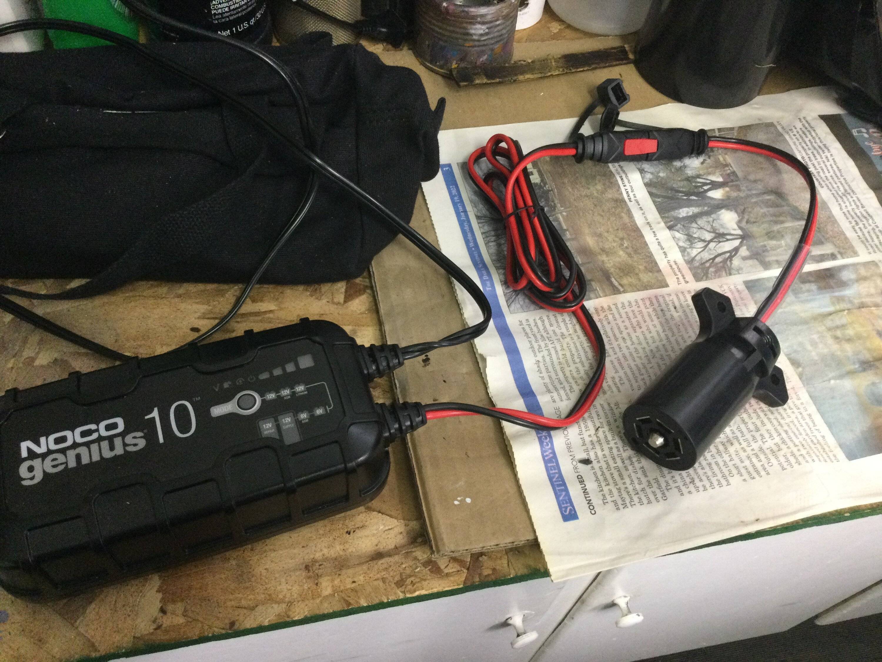

This is what I use. I hook it up easily through trailer plug when I am not using vehicle enough. It’s has worked great
its safe to maintain thru trailer plug?!?
I have a 10....what 2 cables are those?
250
40,624
54,315
Yeah.... why not?
We've talked of this in other threads. I talked of it a year or so ago because it's a non-intrusive, don't have to open the hood or any doors way to get power to the batteries.
you can add the trailer plug to pretty much any such charger real easily.
It's a direct shot to the batteries except the 35 amp fuse.

Yeah.... why not?

Yeah, makes total sense. Anyway, yeah, it's a safe way and I'd guess more than a few have figured it out.
My truck is 2 years old and the signs have started. Air conditioner off fan off everything off the display says auto start stop disabled Heating and Cooling active.
ohhh kayyy...
Gonna pull it apart tomorrow on Veteran's Day..... charge both aux and main one at a time...reset IBS. Noco Genius 10.
