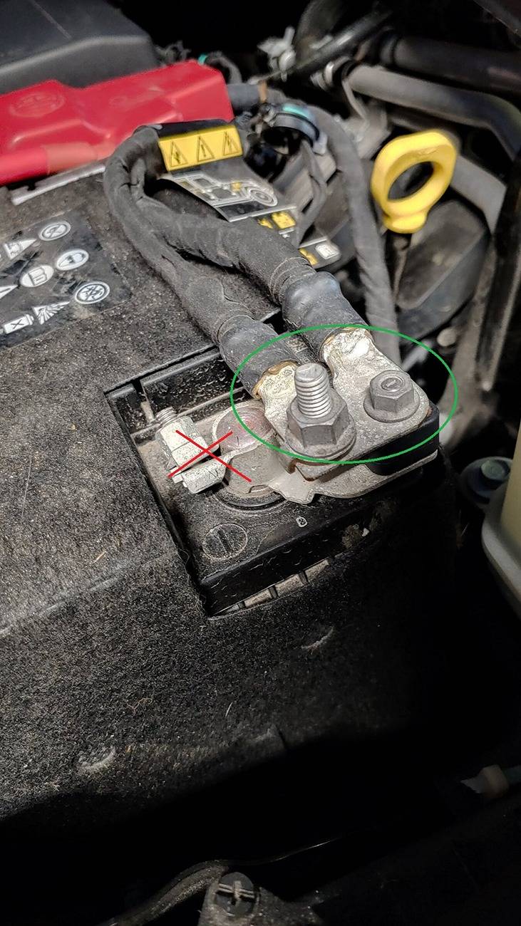

How do you have your other things tied in? Are you connecting the ground for your other stuff at the top of the IBS?
Never connect anything below the IBS directly to the battery's negative post, aways to the studs on top.

If you aren't using the ground points on the right fender area, or other Jeep ground points, make sure you ground to the top of the IBS - the top of this -
Otherwise, use of the ground studs is fine for most things that don't require massive amperage.
You mentioned a great troubleshooting step - take something out of the equation and see what happens. Process of elimination. Could be you have another issue, but you have the right idea, IMO.
