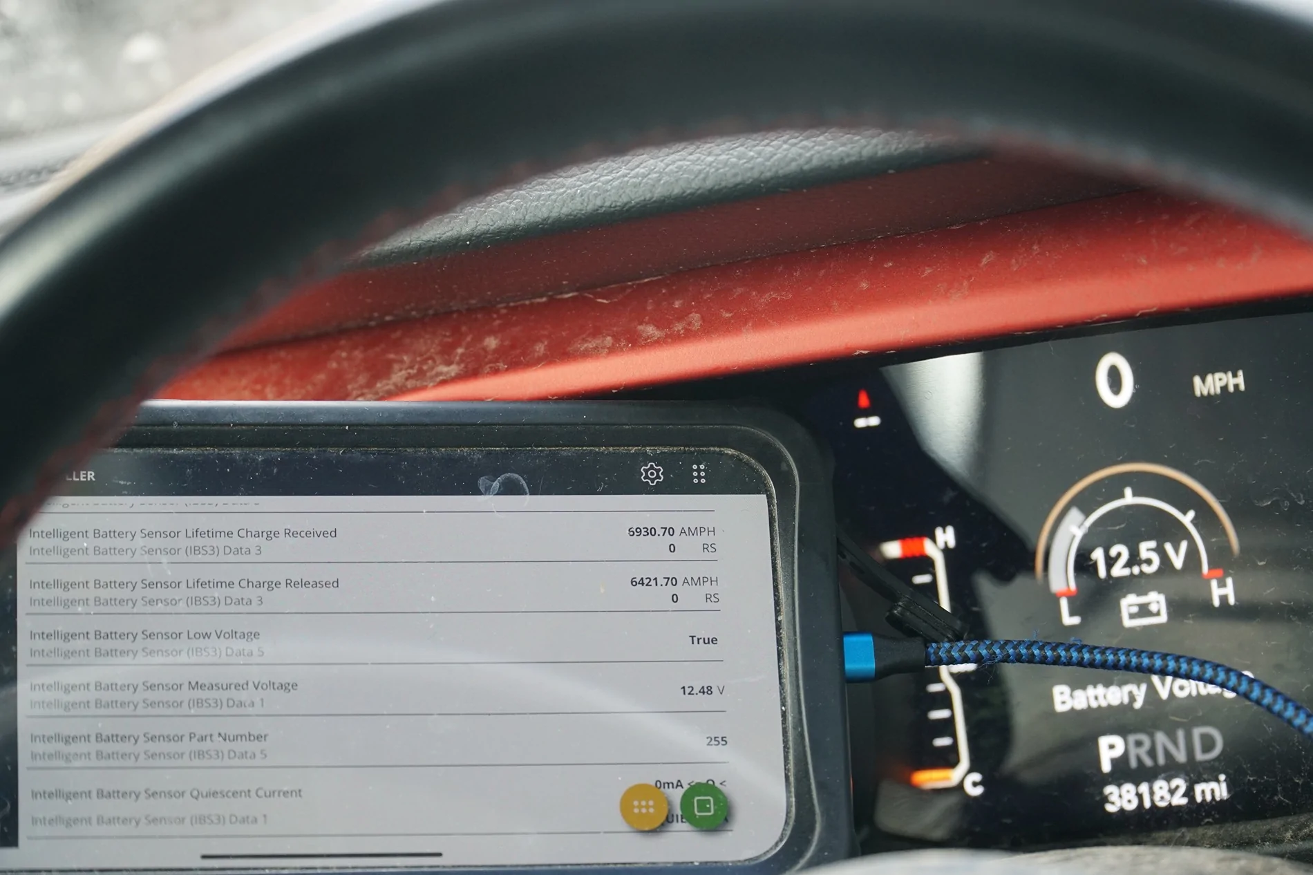

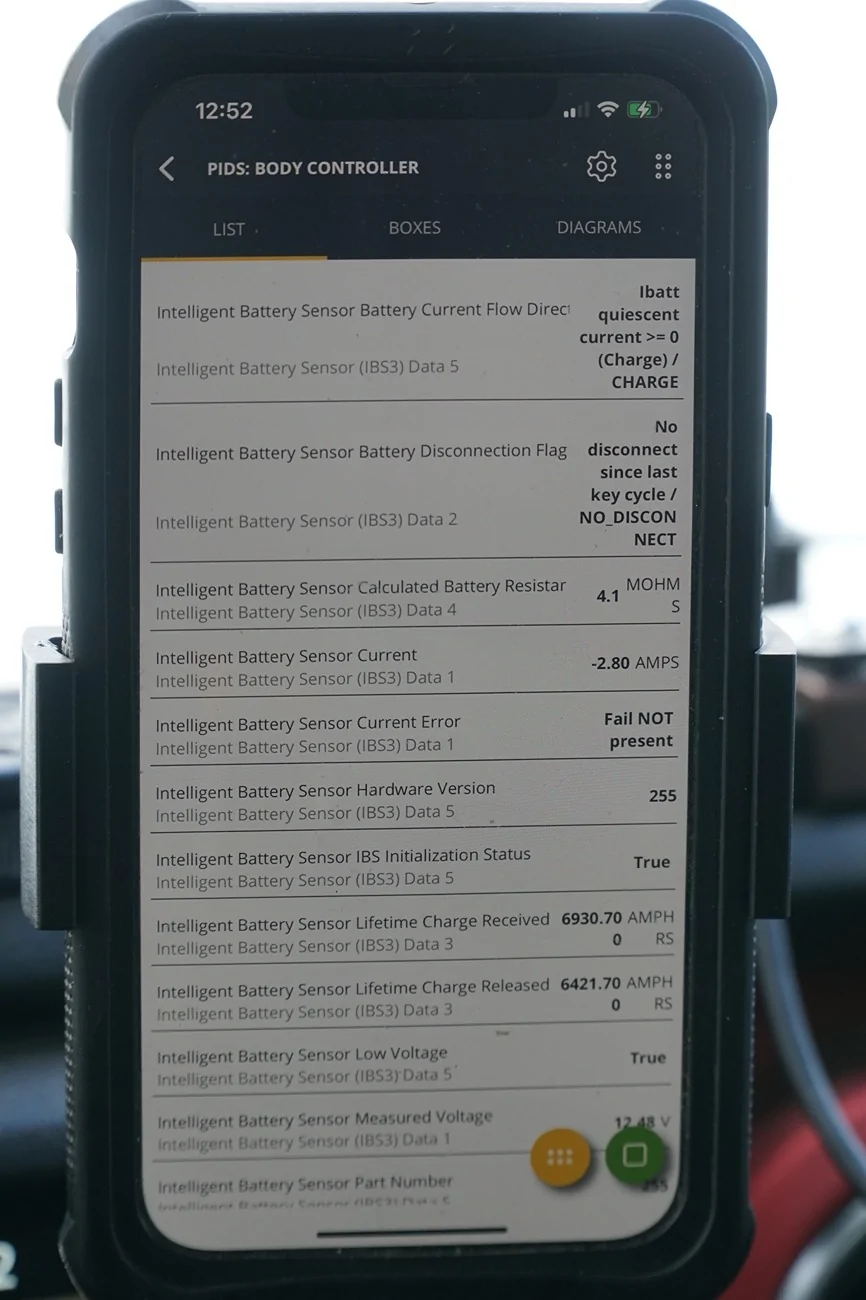

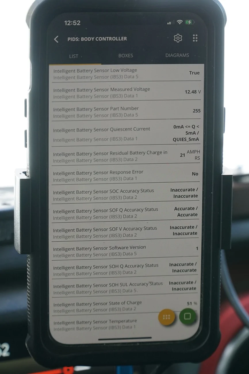

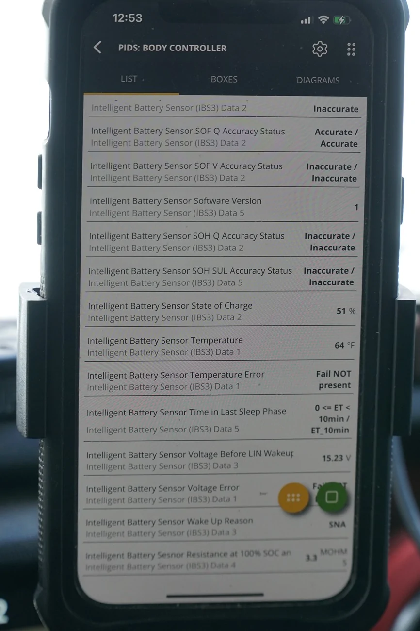

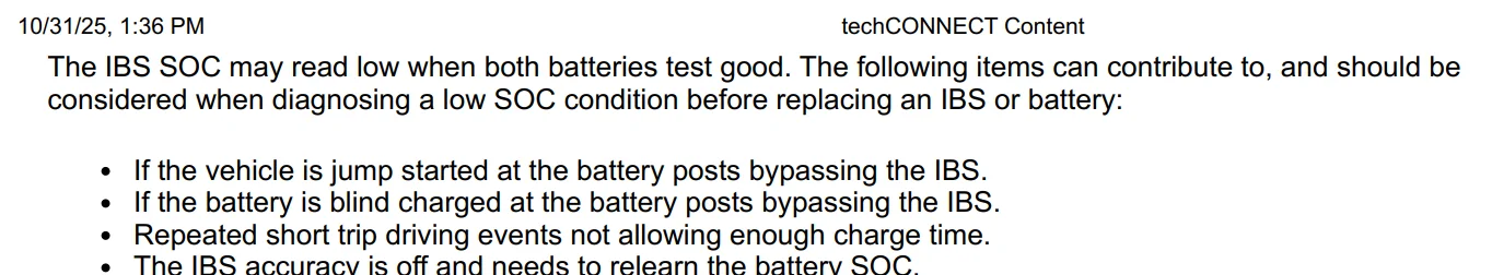

The IBS is fine - however, over time, due to tolerances, it can drift. There's actually a fair amount of tolerance in those and after a couple of years, drift, as well as short drives, can lead to them being way off.
After my 2020 situation, and reading the real tech docs on these things, my plan is to do a full charge and IBS reset perhaps once a year, every two years, tops.
It's amazing what can throw these off.........
Here's some of the reasons they can be off - and gee, it includes a lot of what we see in these forums - short drives, batteries never being fully recharged.
I wonder why some of us have trouble, and some of us never do?
