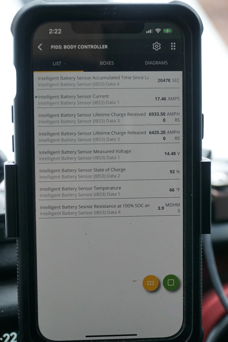

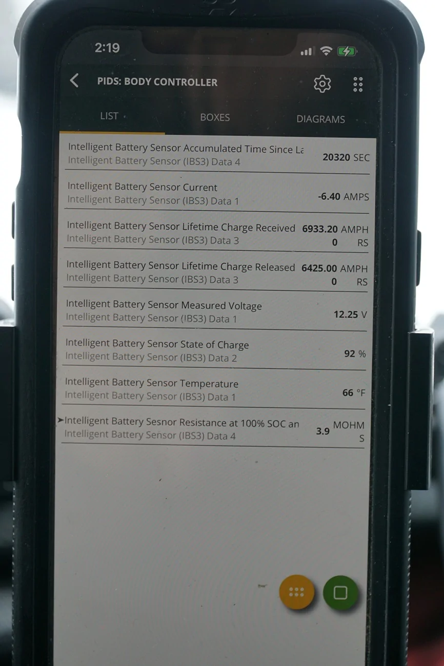

First picture is radio on, next is running. Radio -6.4A and charging 17.4A
That last PID on the second pic is MOHM.........Makes me wonder IF swapping to LiFePO4 would be an OK move with the cornputer rolling with it OR would it not like it and undercharge? There is a guy on here reporting monthly on his journey with that chemistry.

I drove from Tucson to Seattle and back with a current shunt on my jeep. Never saw more than 50A charging current. After starting the current is 50A max then very quickly goes to 15A to 20A.
Where was the shunt? Is it possible some of that was used by the Jeep itself and not "going to" the battery?
After cranking a while to start my 360 (takes some effort to get fuel to the carburetors and fill them) I can easily see 40 amps going to the battery.
I also find it impossible to believe that the charge limit on these is 2.5 amps.
You'd take many hours to charge a battery at that rate and the typical voltages these run at. In fact, you aren't going to ever charge an AGM at that rate limit. I have a feeling it's a different meaning than what it appears as.

I believe that the "Charging Current Limit" will change with conditions. Maybe JSerria can test that soon. Regardless, I don't see the value of knowing that.
There is no way it means what it appears at face value to mean. You'll never fully charge batteries with that limit, plus, when you are running a voltage of 14.8 volts, you aren't going to have only 2.5 amps going into the aux battery or even the main. I'd bet if you had a shunt between the IBS and the main battery negative you'd see more than 2.5 amps.
IBS3 Battery Equivalent Capacity (9000-405000): 405000.000 %
IBS Quiescence Current Limit (-250-0 mA): -250.000 mA
IBS Minimum Voltage Limit (0-25.4 V): 10.000 V
IBS3 Charge Current Limit (0-2500 mA): 2500.000 mA
IBS3 Battery Parameterization Kind- Battery Mode: Use Battery Type
IBS3 Vehicle Battery Type (0-63): 22.000
IBS3 Minimum Charge Limit (0-100%): 35.000 %
